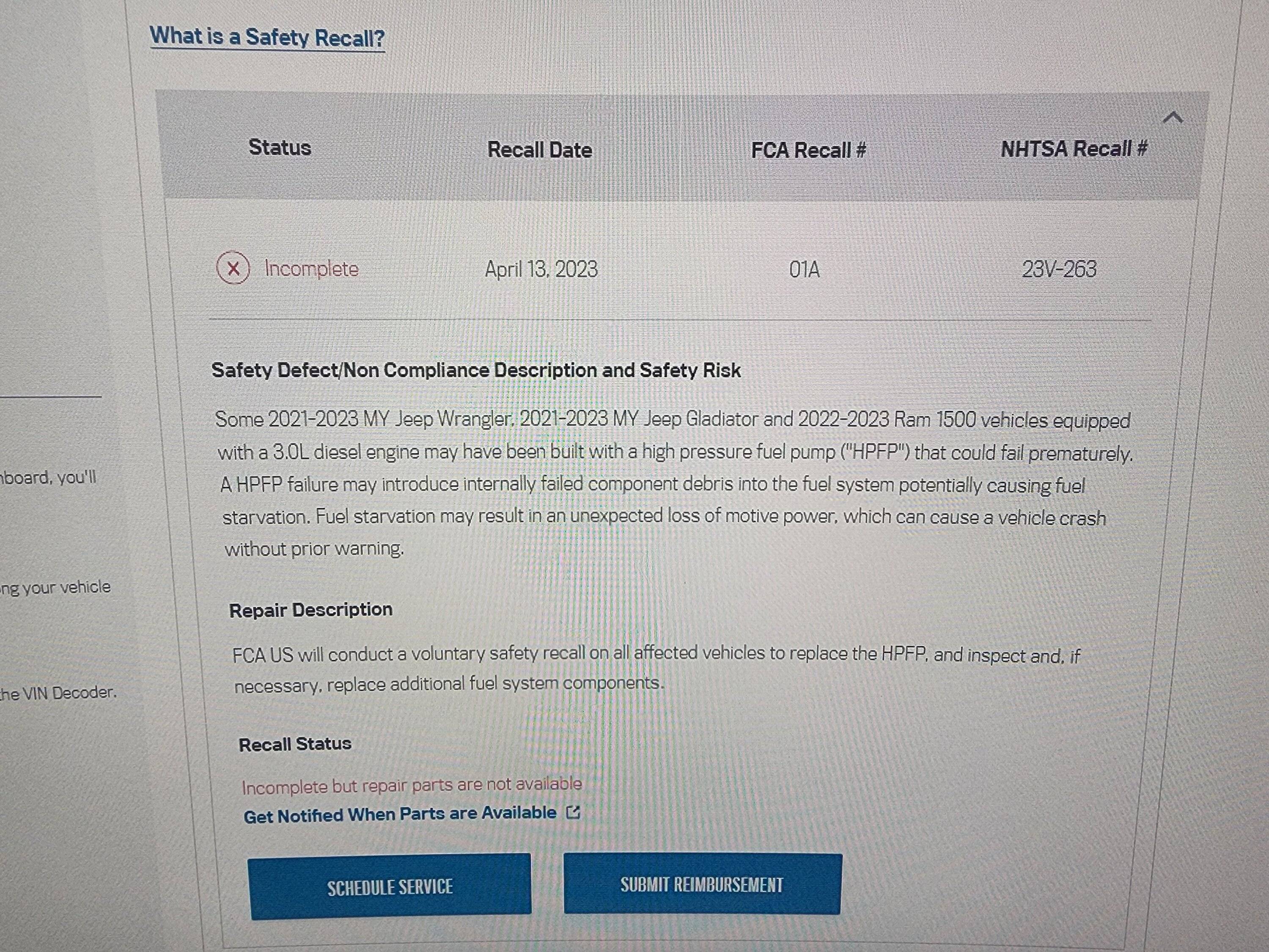

The CP4 isn't an issue as long as you use a fuel additive with lubrication or running biodiesel blends. I've got a buddy that runs biodiesel in his truck, and he now has 415,000 miles on the CP4 with no issues. The recall will take years to complete. It's not a fast or easy replacement part. If there's any sign of metal, then the injectors, fuel lines, and fuel tank get cleaned or replaced. The parts will be a slow release.

This will be interesting for me. My fuel pump went out on NYE and Jeep ended up replacing the entire fuel system. Which took about 50 days for all the parts and installation to be completed. But they replaced the pump with the same 68501449AA part that is listed in the new recall. My jeep was built in earlier 22 but wasn't originally included in the first fuel pump recall notice.

You're gonna get another pump. Hopefully it doesn't takes 50 days this time.
Many of the pumps in CA seem to be B20, does this add enough lube in your opinion?
biodiesel
Dec 8, 2018
2,346
3,045
New Mexico
2015 Ram 1500 Ecodiesel
Most definitely. Studies have shown that even B2 outperforms all aftermarket fuel additives in terms of lubrication.

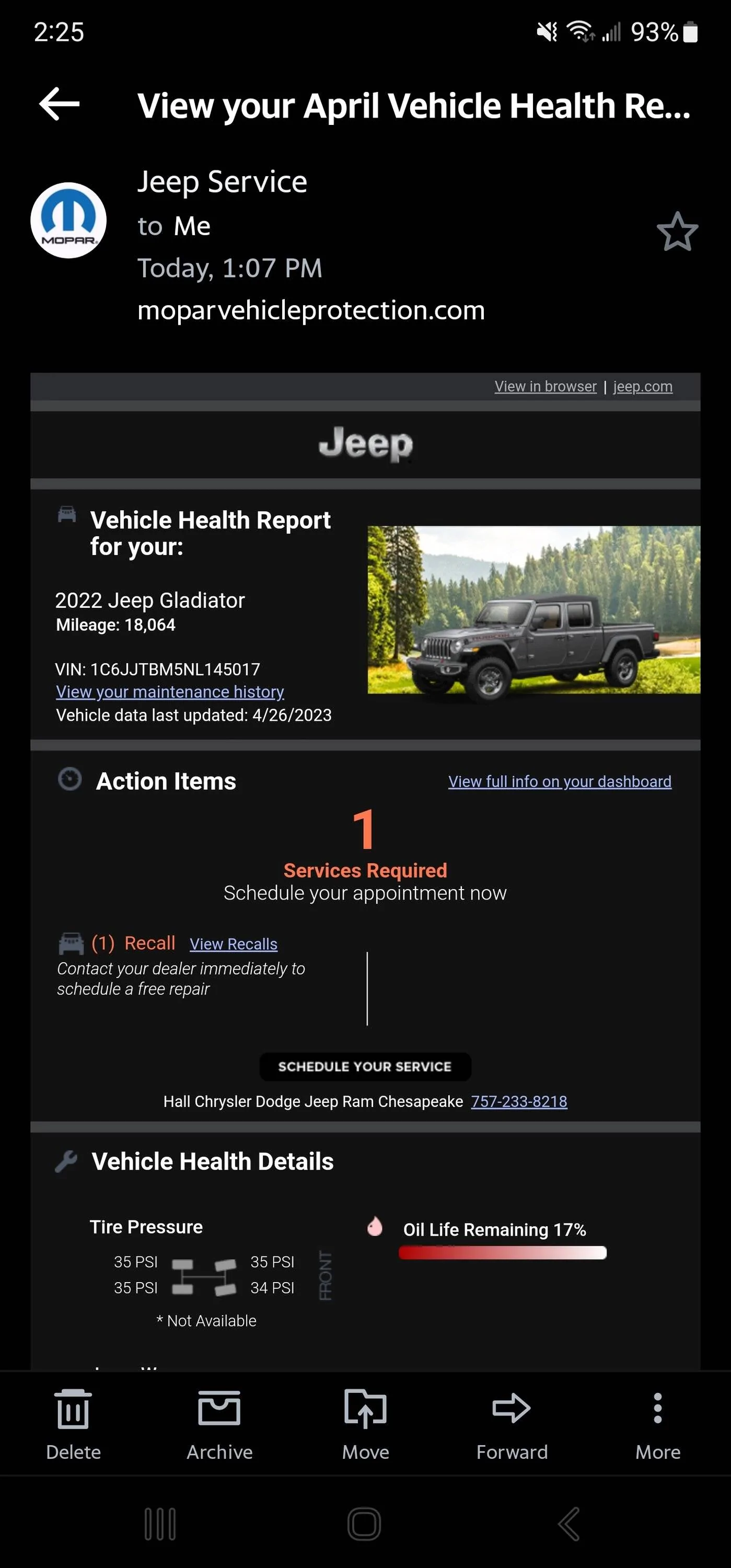

Got the recall on the App today obviously with no known timeframe for parts. 22 JTOD just about to hit 15k, no additives no biodiesel, no plans on using either.
