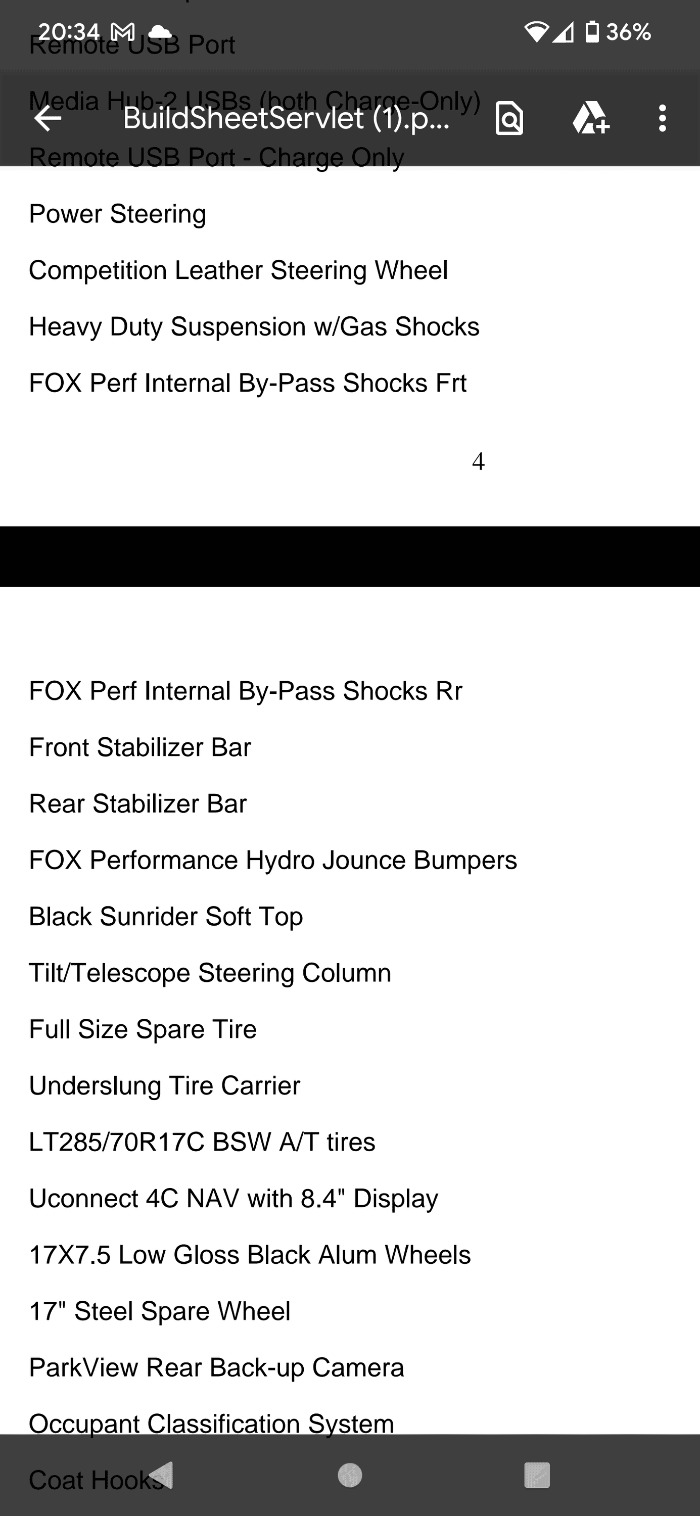

Can't help with build date since mine was in January, but I would enter the VIN on a parts catalog and see what comes up for the vehicle, and then compare parts numbers.
It's not unheard of for issues coming off the assembly lines. There have been members here with mismatched fenders for example.
Edit: You can also punch in the VIN here and get the actual build sheet - it will have the shocks listed for the build of the vehicle.
https://fcacommunity.force.com/RAM/s/equipment-listing
It should say " FOX Performance Front Shocks" & "FOX Performance Rear Shocks"

Ran a few random 2023 vins through the link previously provided. None have the Fox Performance Shocks. Ran a few 2022's through the website and all have it. A bummer
2022: 1C6JJTBG9NL177446 , 1C6JJTBG5NL175340 (FOX)
2023: 1C6JJTBG1PL505543 , 1C6JJTBG0PL505548 (Red Tenneco Shocks)

My 23 Rubicon does not have the Fox branded shocks on it
Thanks for confirming! Is it possible to check the Part Number on it? It would be great to cross reference them against 1) The willys shocks and 2) the JL Rubicon shocks

i posted this on another thread..
my 2023 Diesel Rubicon build sheet says
Red Tenneco Front Shocks
Red Tenneco Rear Shocks

My build sheet just popped up, my JTM will have the Fox bypass shocks it's supposed to have
