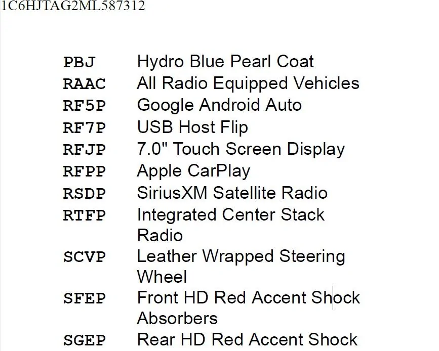

Are you able to check the website below and see what your build sheet states you have? I wonder if they're the "extra HD" shocks:

You build sheet won't populate until you're in the Production phase.

* Front HD Red Accent Shock Absorbers
* Rear HD Red Accent Shock Absorbers
That’s all it says
Thanks for checking, now time to find someone who has received their 23 Mojave and see what the shocks are.
That’s all it says
I just checked the build sheet on my 2021 Willys and it says the same thing. I bet the 2023 Rubicon and Willys are using the exact same shocks now.

I'm in production since Oct 8 for a Mojave. Build sheet says front rear HD shocks. No mention of FOx. ugg. It also says Leather wrapped steering wheel when some others mention competition steering wheel. We will see what the sticker says.
God Speed. Wish we could find someone with a 23 Mojave delivered that can check. I think someone is going today to check a HVY Mojave near them, I'll see if I can find the thread and ask them to check.
