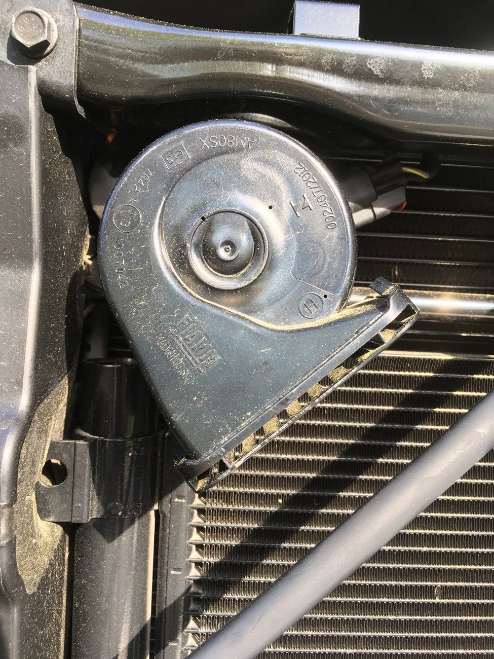

In looking into this further while the front grill was off, I discovered that the horns are bolted to a bracket which is then bolted to the radiator frame. The horns are fastened with a 10mm nut on the back of the horn.. I was able to get the box end of a wrench to loosen the nut that holds the horns. I decided to re-position the horns (turning them slightly) so that the connector and wiring are not so visible, and harder for a thief to cut. I could have taken the horns off and swapped then around making the wiring and connector harder to reach, but that would have involved putzing with the wires and such, but I'm too dam lazy in my old age.
As far as security is concerned, I now have the bolt hood lock installed, and I'm "on the fence" about whether to go with an ignition immobilizer or the taser pin lock.
But, the old adage goes: If someone really wants to steal a vehicle, they will.
Hope this can help somebody.
