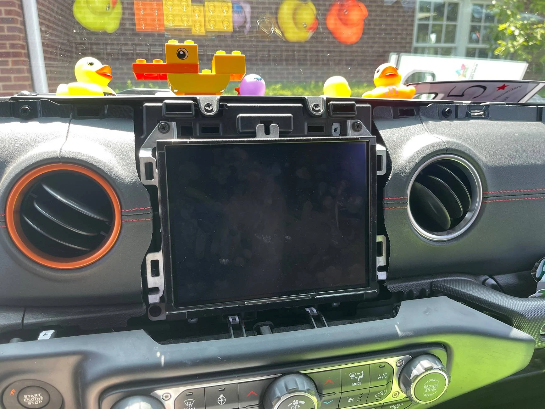

Man. I’ve been trying to get the fourth orange one. I’ve ordered three from mopar and they have been incorrectly black three times!
I have shiny silver ones I’ll trade you for your orange ones?
Once you remove the vents, the covers Unclip and come off. I gave up, and ordered some punk’n spray paint to paint mine. I’m sick of driving around with my dash half off.

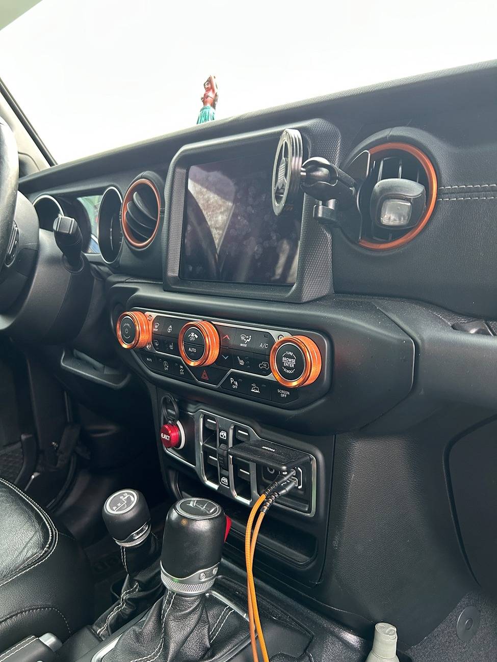

man, I just replaced all my stock vents of my Overland for the Mopar orange ones. I think they look cool, and pop against the "boring black and shiny" interior! I would have gladly sent you my old ones... they went into storage prior to moving overseas. Considered painting or dipping the ones I had, but it was hard to match that OEM quality look the Mojave comes with.
