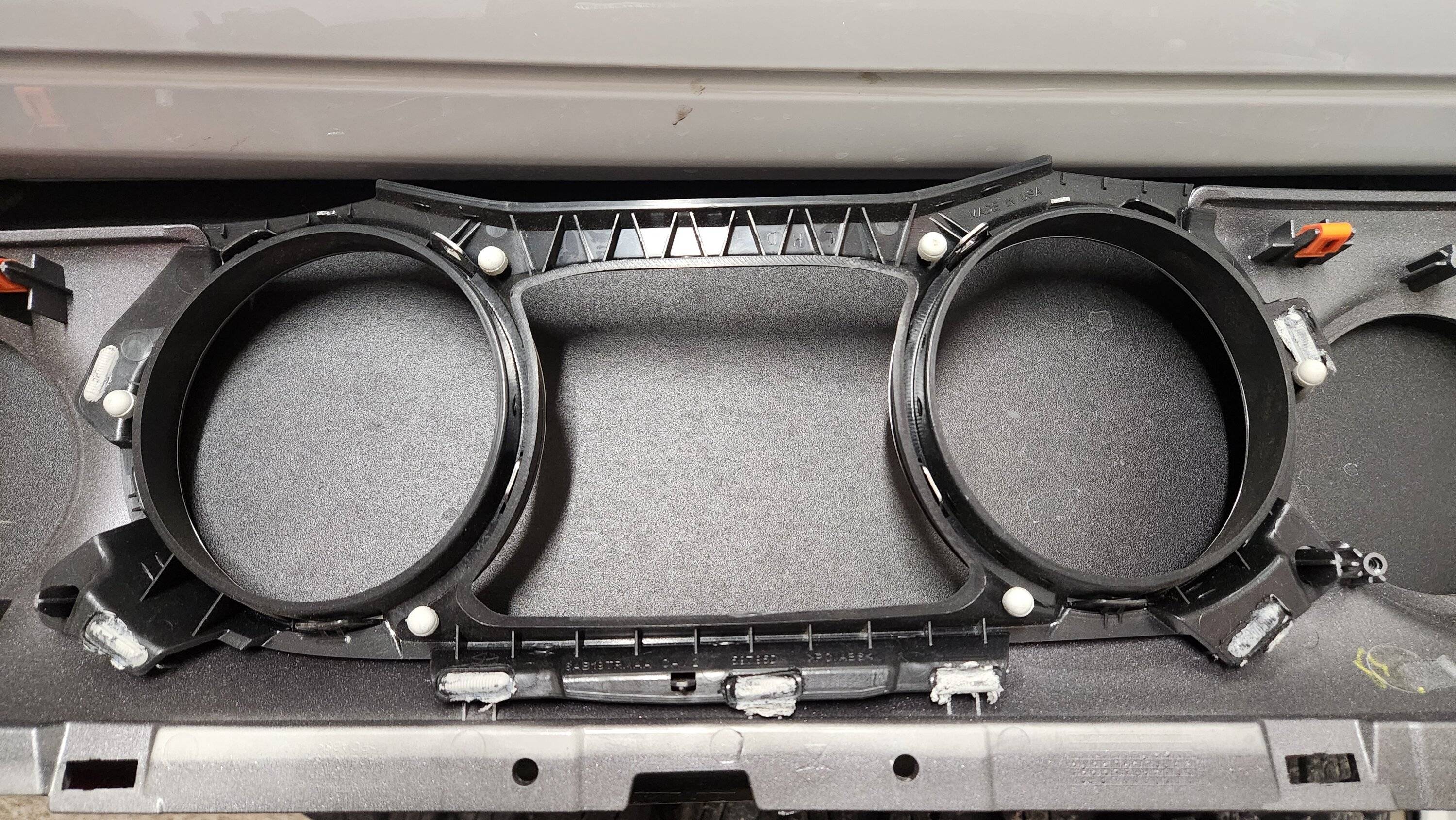

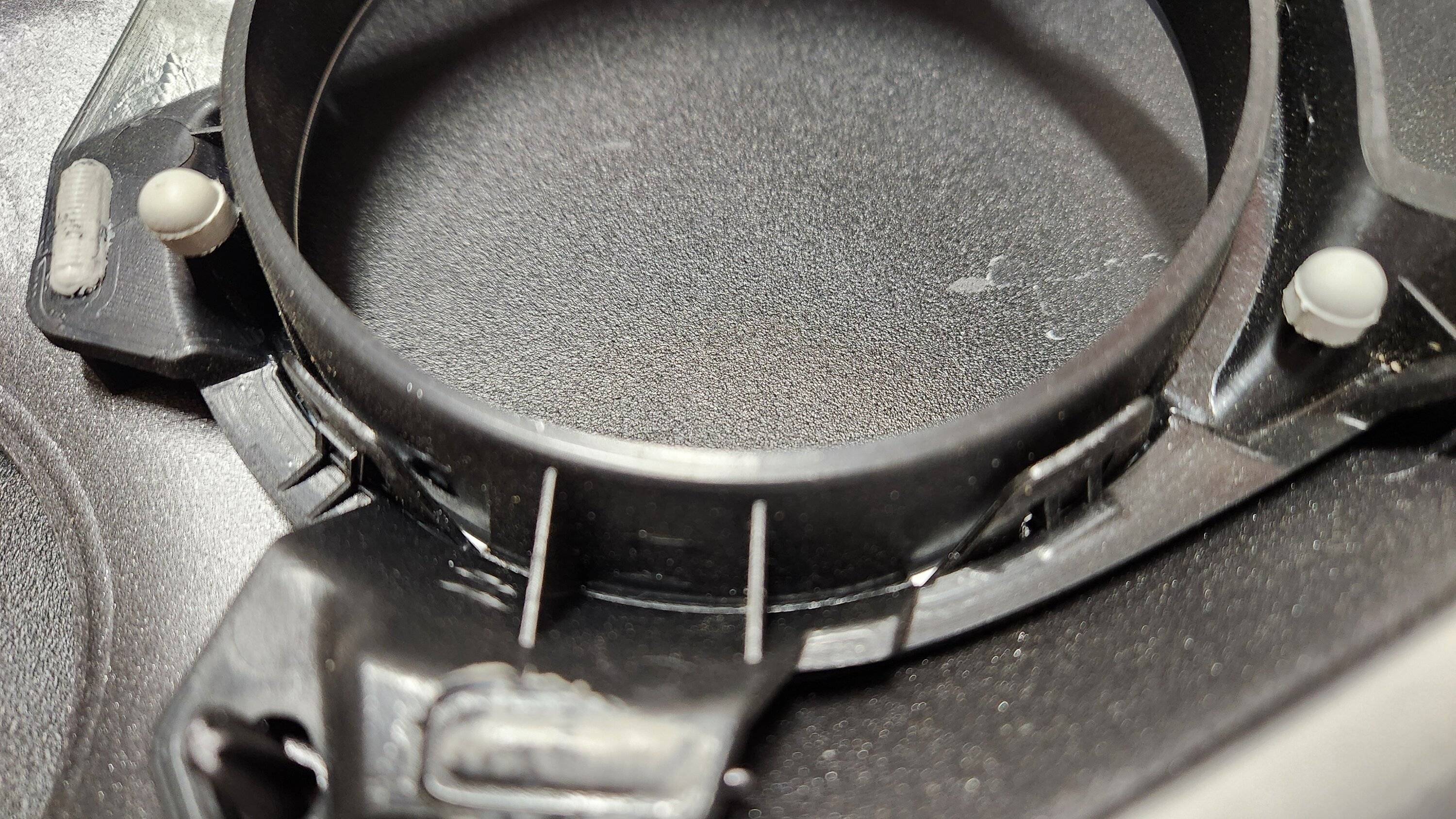

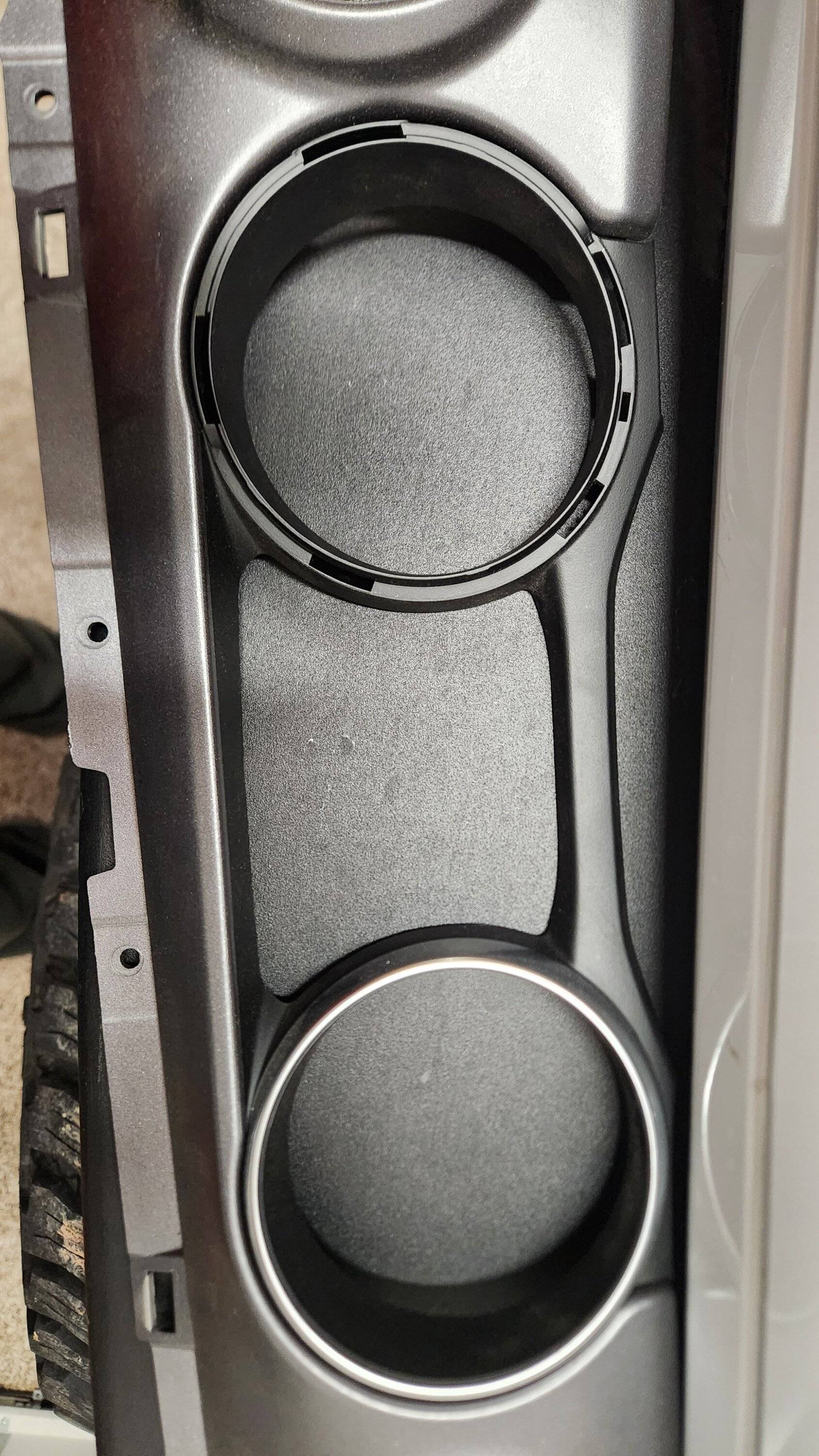

I would not just "yank" them out. There's (3) little tabs that should be depressed from the backside towards the middle of the speedo circle. Once depressed, these remove very easily. If you just wanted to yank them out and break the clips, then you'd certainly have to super glue the ring back on. Here's some pics.

this is EXACTLY the info I needed, thank you tons! That saves me some heartache. Now I just need to figure out how to get that piece out so I can get them from the back. Think there’s a YouTube video somewhere about pulling the dash panels.

No problem.. Yep, tons of YT videos on dash removal...

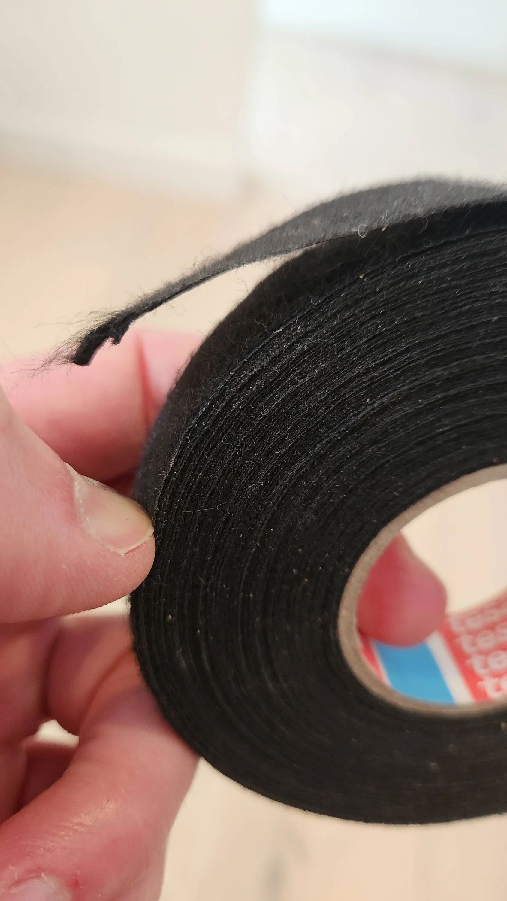

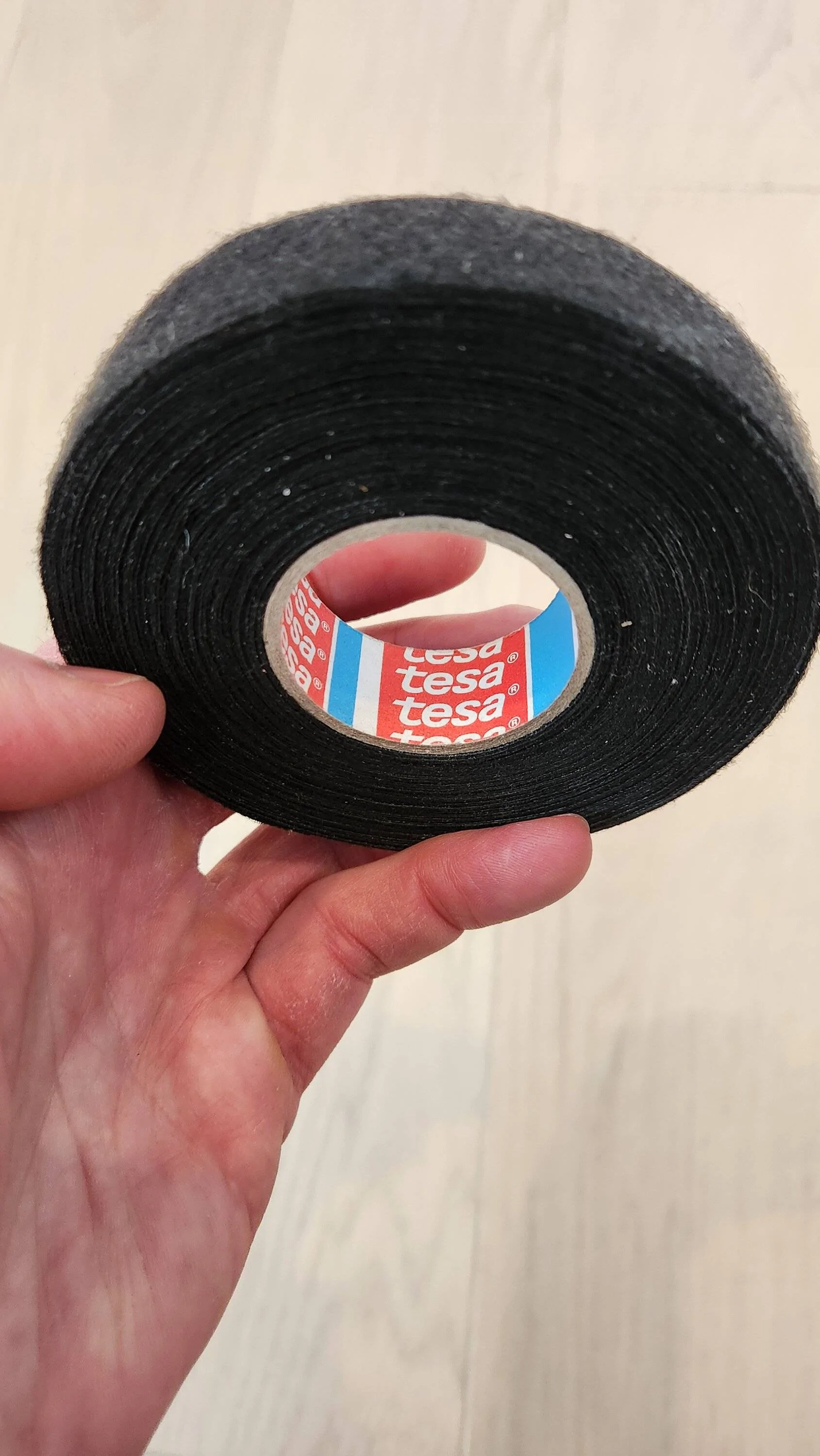

FWIW, when I'm chasing down little interior rattles and squeaks I typically use this felt tape. I think I got it from Amazon like 4 years ago. It seems to be very similar to what Mini Cooper used in our old rattlebox. I love it because it's sticky on one side and you can cut it and cram it into spots that friction rub or just need a little bit of "filler" between parts. Way less permanent than super glue. It is pretty incognito as well.

I use this too. Especially to wrap wires that might tap up against plastic panel pieces. Love this stuff.

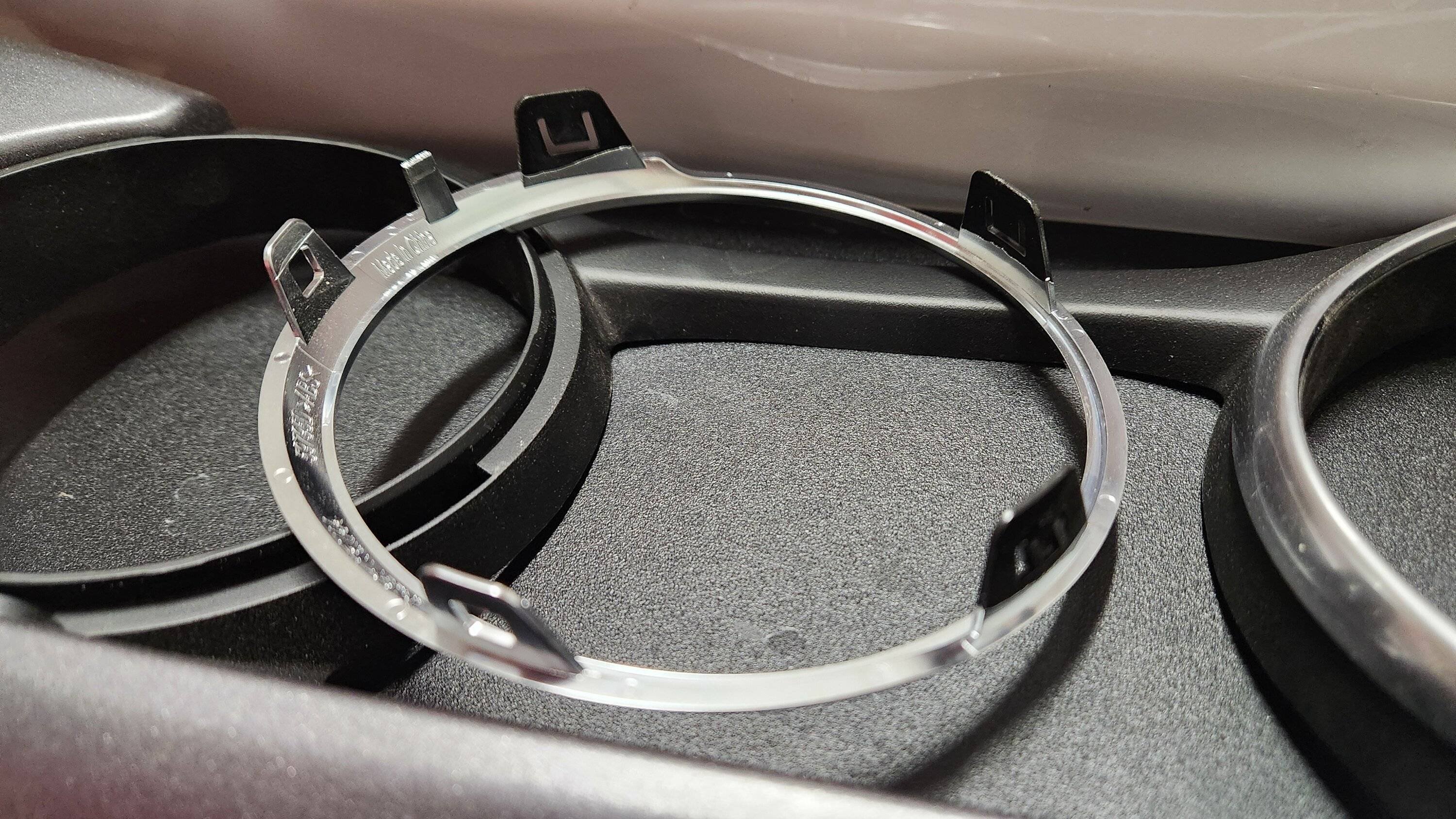

Ok i got it done yesterday and in pretty short time, surprisingly. thanks to darkhorse13 for those pics they helped a lot. I popped the rings off with no damage, laid a bead of superglue around where they sat and got them back together. Took the opportunity to cover the edge of the long dash trim, where it rubs the other dash piece, with that cloth tape to prevent future squeaks and rattles.
