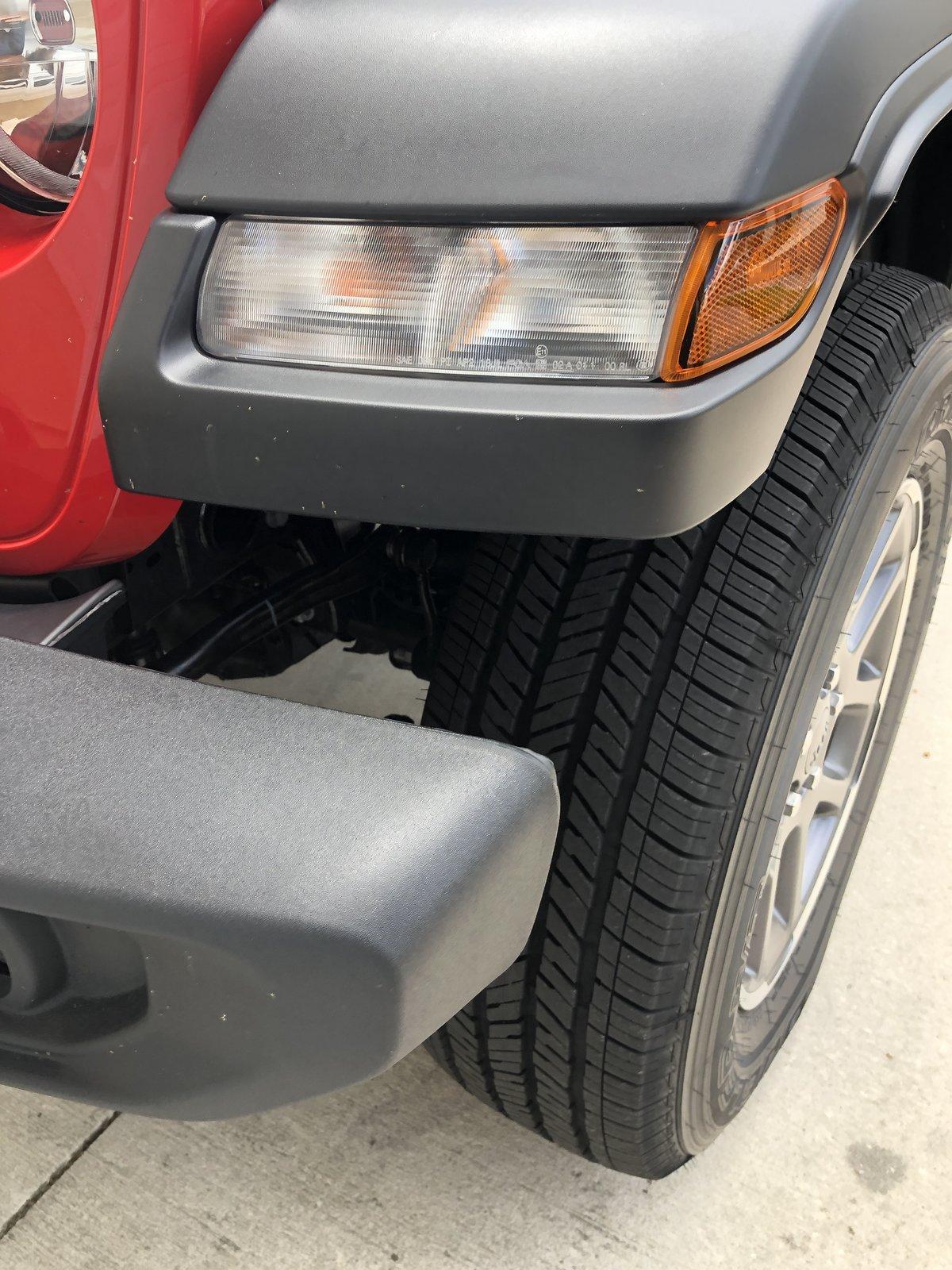

I took mine off on my JL altogether. I am really surprised that people are so concerned about the fog light wires. First of all, after 1.5 years of them being exposed I have had no issues. But even if I did, how hard is it to repair/replace fog light wiring?

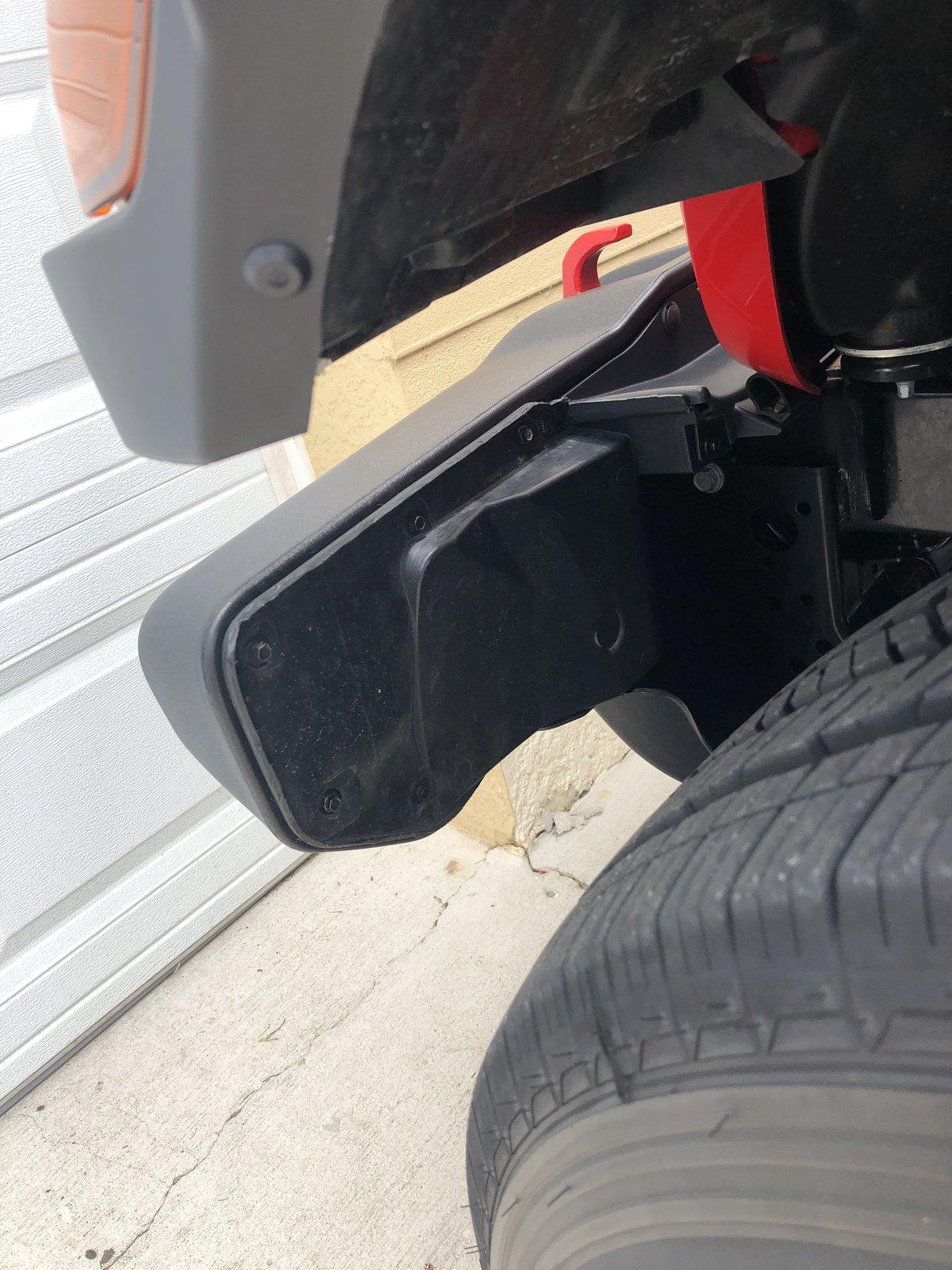

I removed mine both on my JL and my JT. - Then I use a dremel to cut off the excess (thereby using the remaining part of the panel to cover the lights.
How did I missed this post… Wow you did an amazing job

What specific Dremel bit? Thanks.
40,465
53,921
Not a bit - a plastic cut-off wheel. You can get them in metal cutting or plastic cutting. I buy the bulk packs of the metal cutting but always have some plastic cutting wheels, too.
They are like mini-5" angle grinder wheels.
They are exactly like these but say "plastic" on them - they won't plug with hot plastic like the metal cutting wheels will although I've used the metal cutting wheels in a pinch.
https://www.homedepot.com/p/Dremel-...t-Off-Wheels-for-Metal-5-Pack-EZ456/100484365
Here's the plastic cutting wheels. They go on the quick-change arbor, whatever their trade name for it is........
https://www.amazon.com/dremel-plastic-cutting-wheel/s?k=dremel+plastic+cutting+wheel
