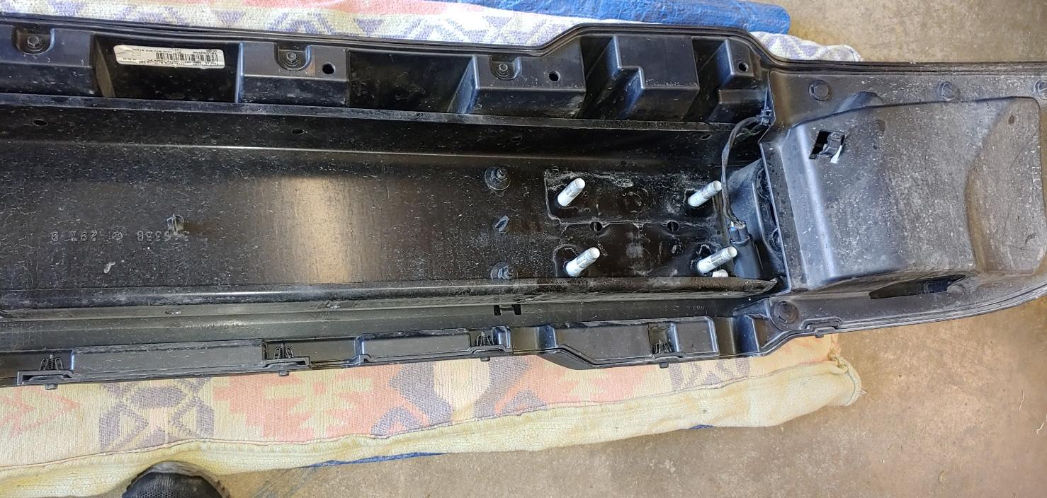

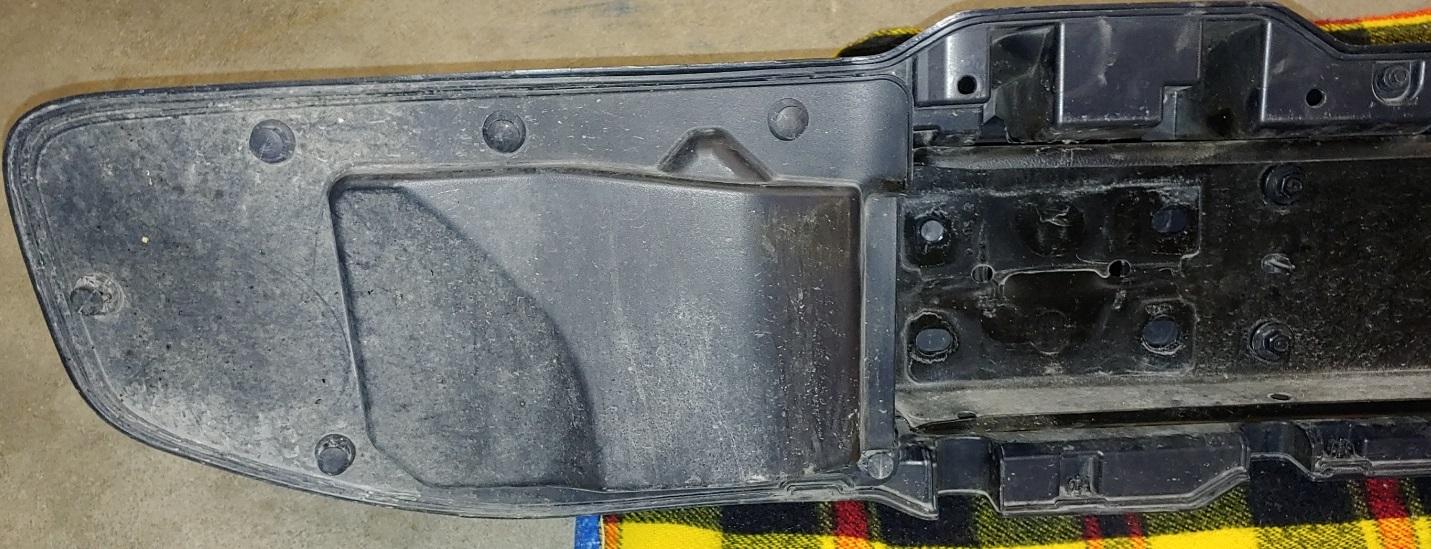

This is the cover or panel on the back of the Overland "plastic bumper", the step up from the Sport base bumper -
Jeep Gladiator Removing closure panels from SPORT S front bumper? 20201013_155411_HDR
Jeep Gladiator Removing closure panels from SPORT S front bumper? 20201016_161053

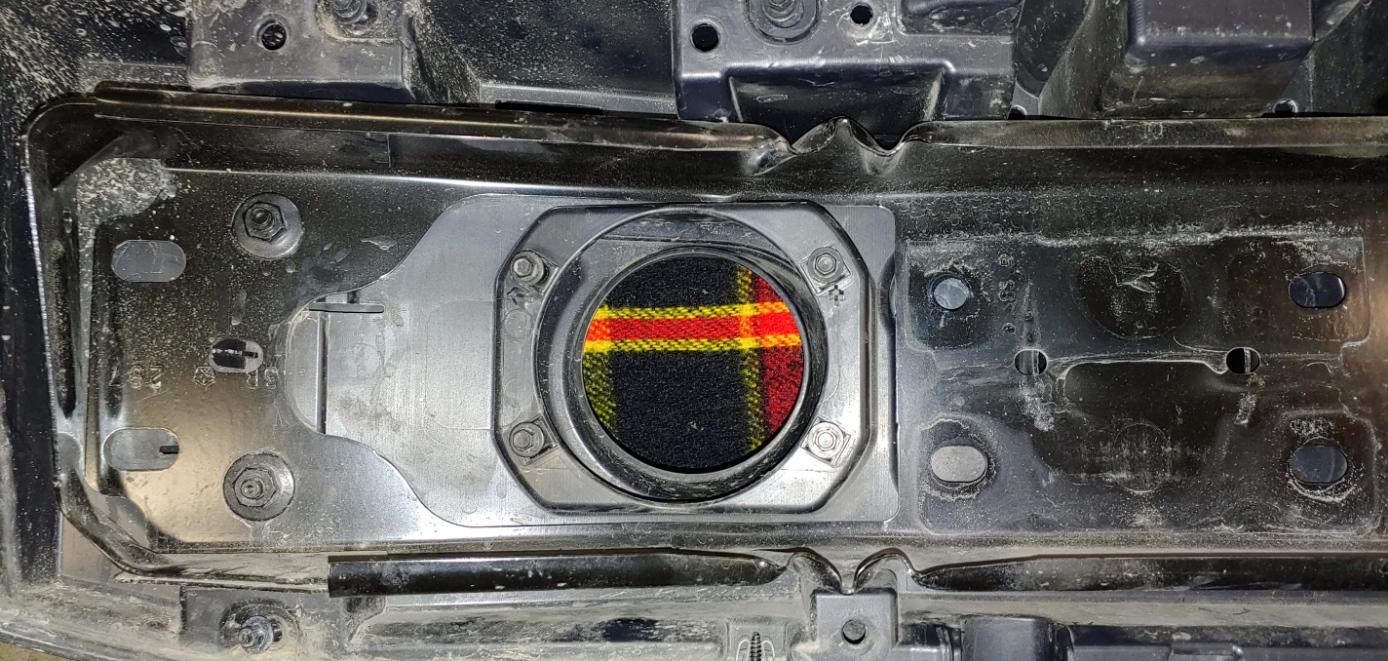

And cover and plastic back liner removed - you can see the 4 screws that held the fog lights in place -
Jeep Gladiator Removing closure panels from SPORT S front bumper? 20201016_160813_HDR
