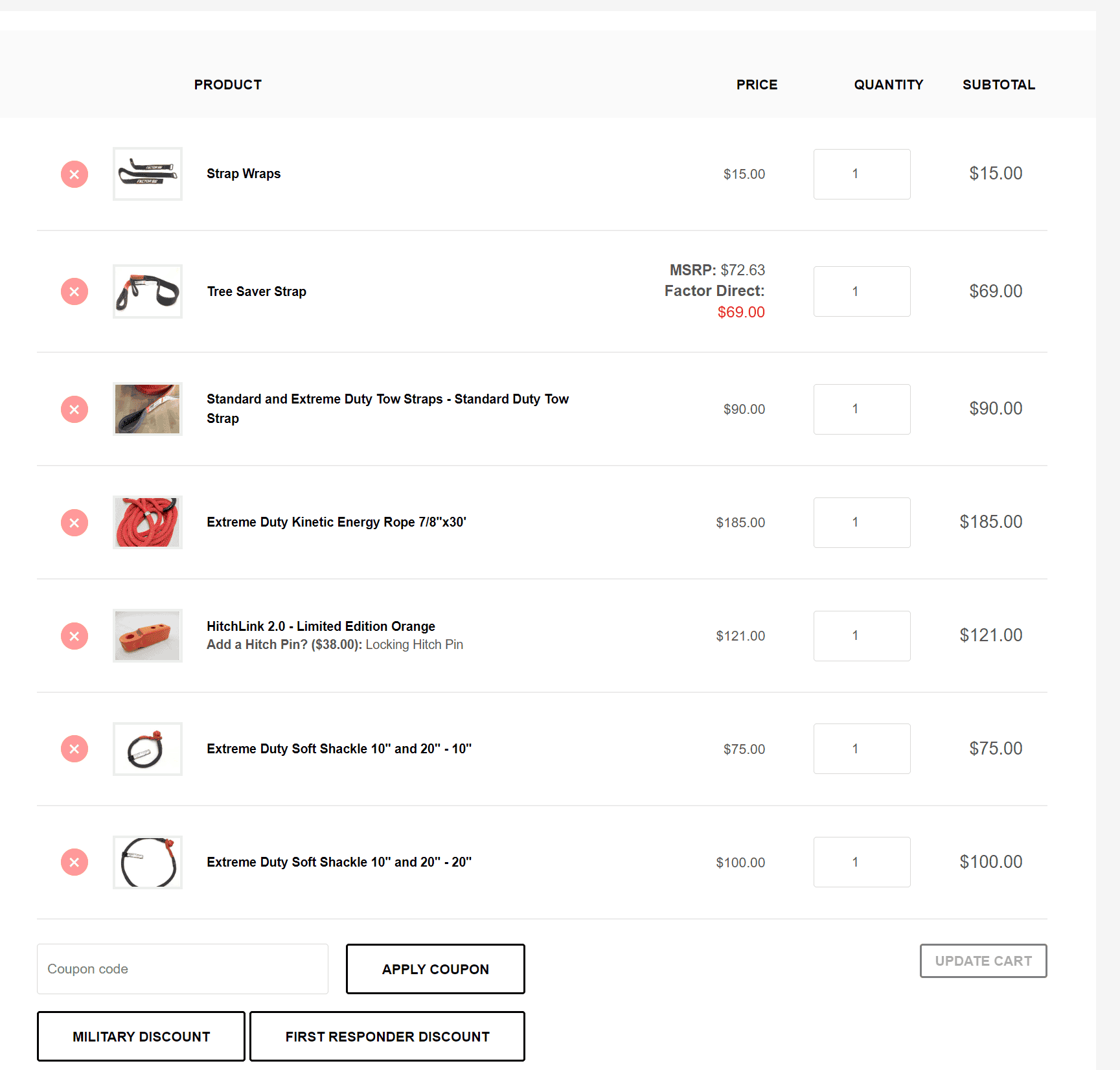

Ordered these:
https://www.hkoffroad.com/collectio...-jt-shackle-tab-kit-for-stock-rubicon-bumpers
Prefer closed systems when possible.

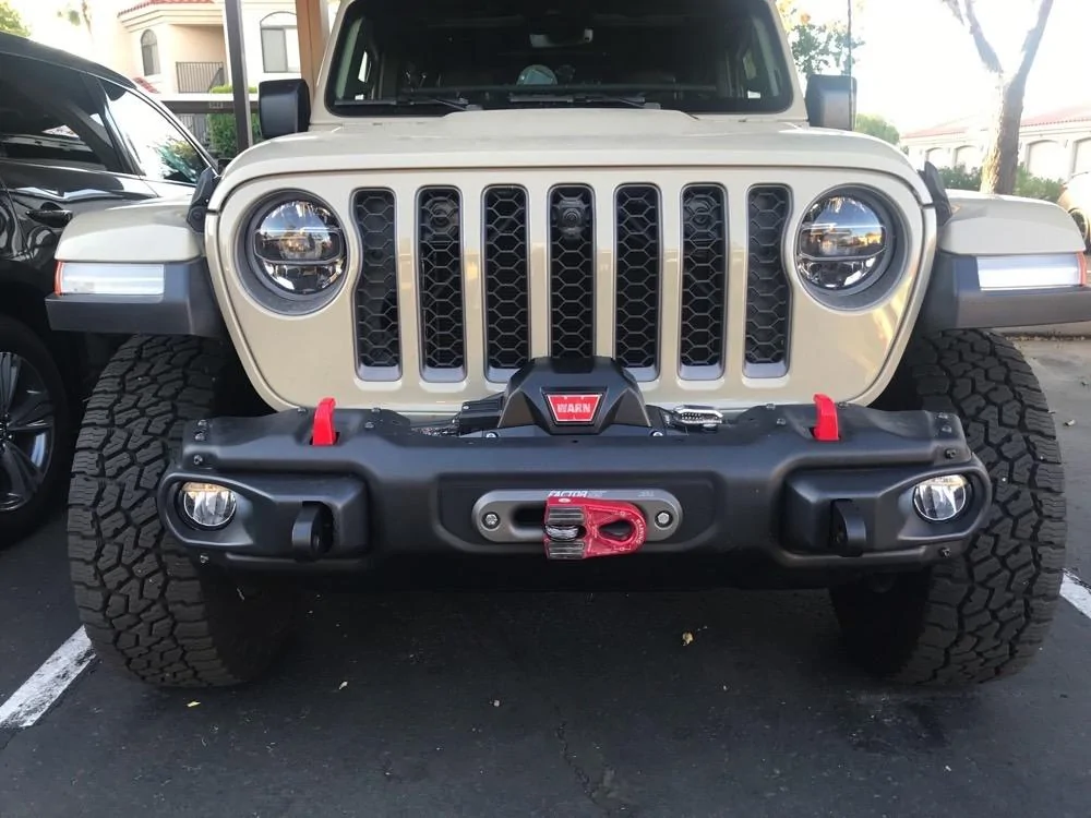

Jeep Gladiator Replace the hooks with loops? IMG_9753

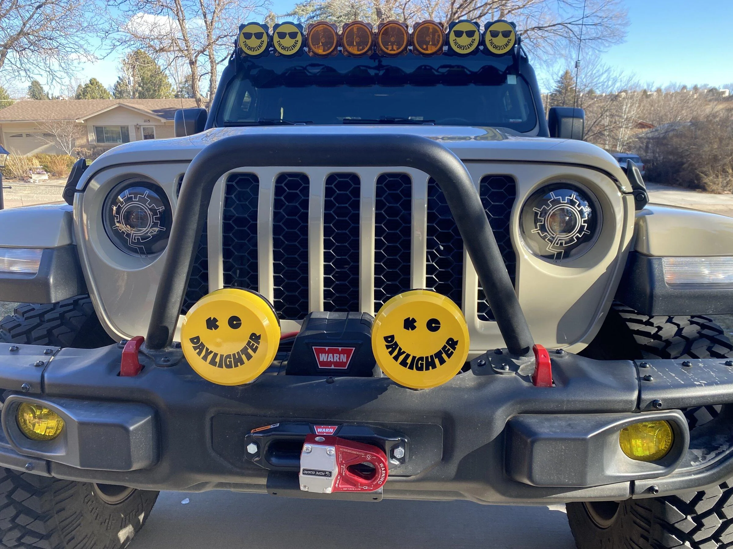

Piecing together a Factory 55 kit, this server me well using only factory hooks?
