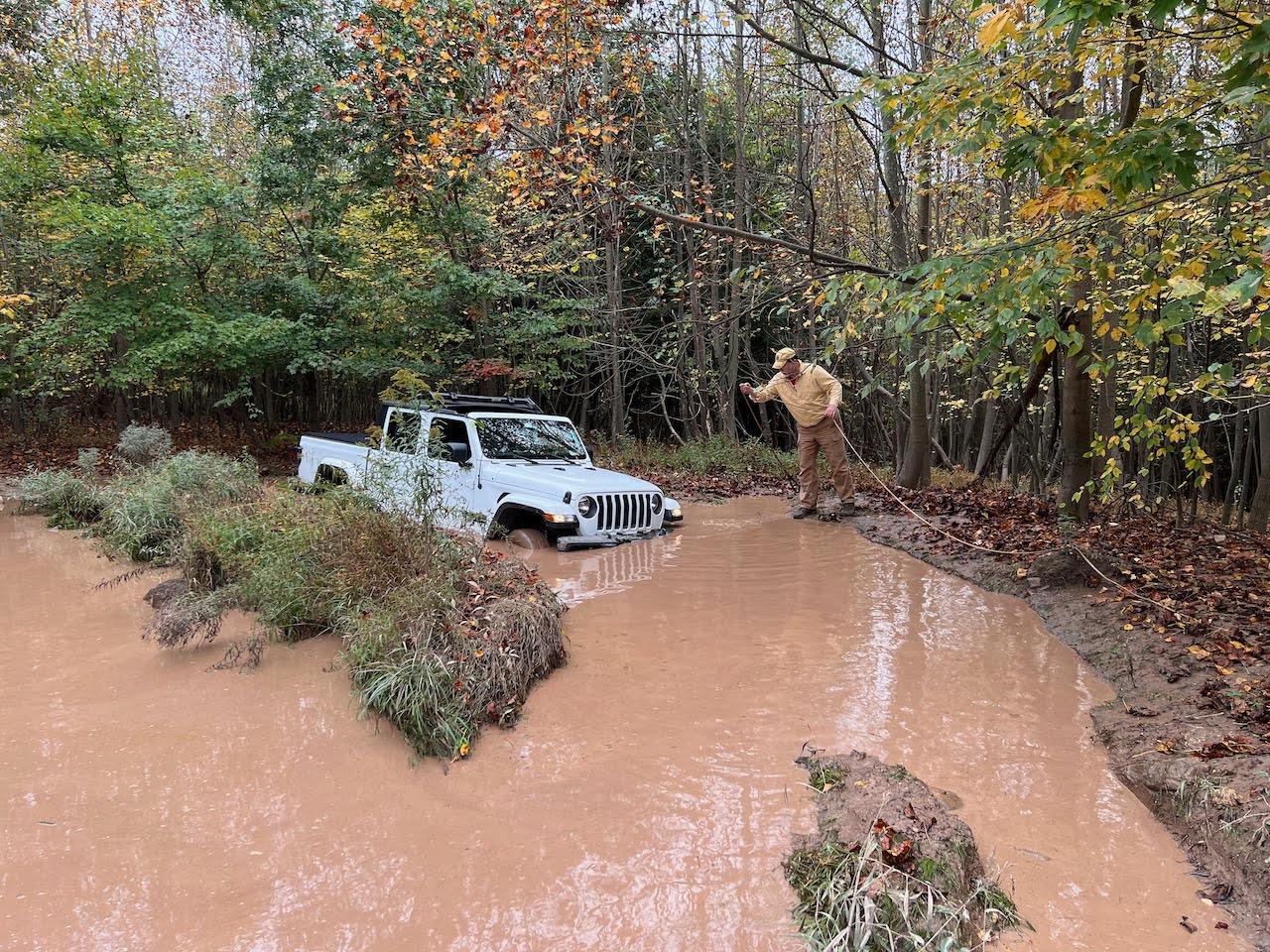

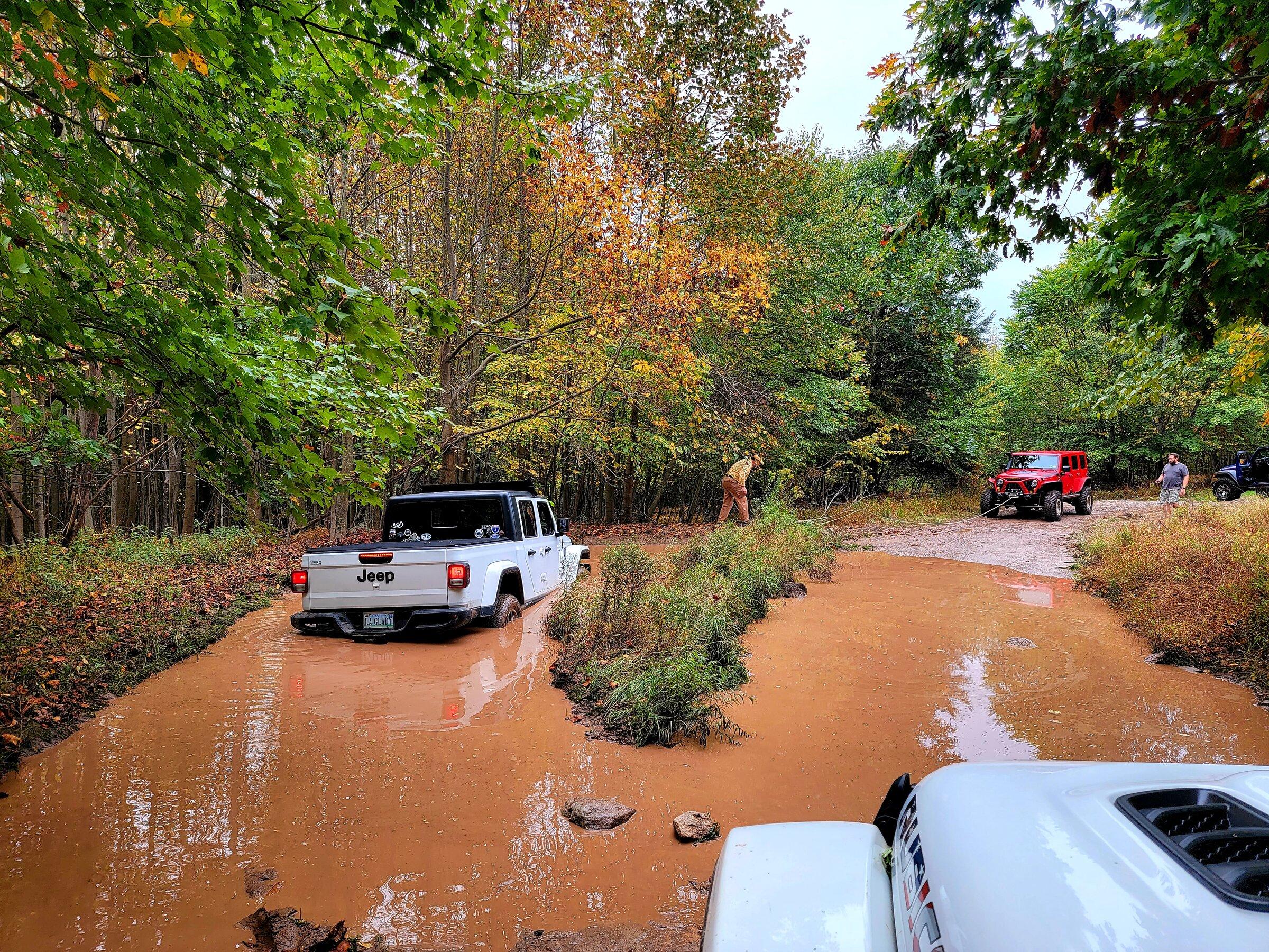

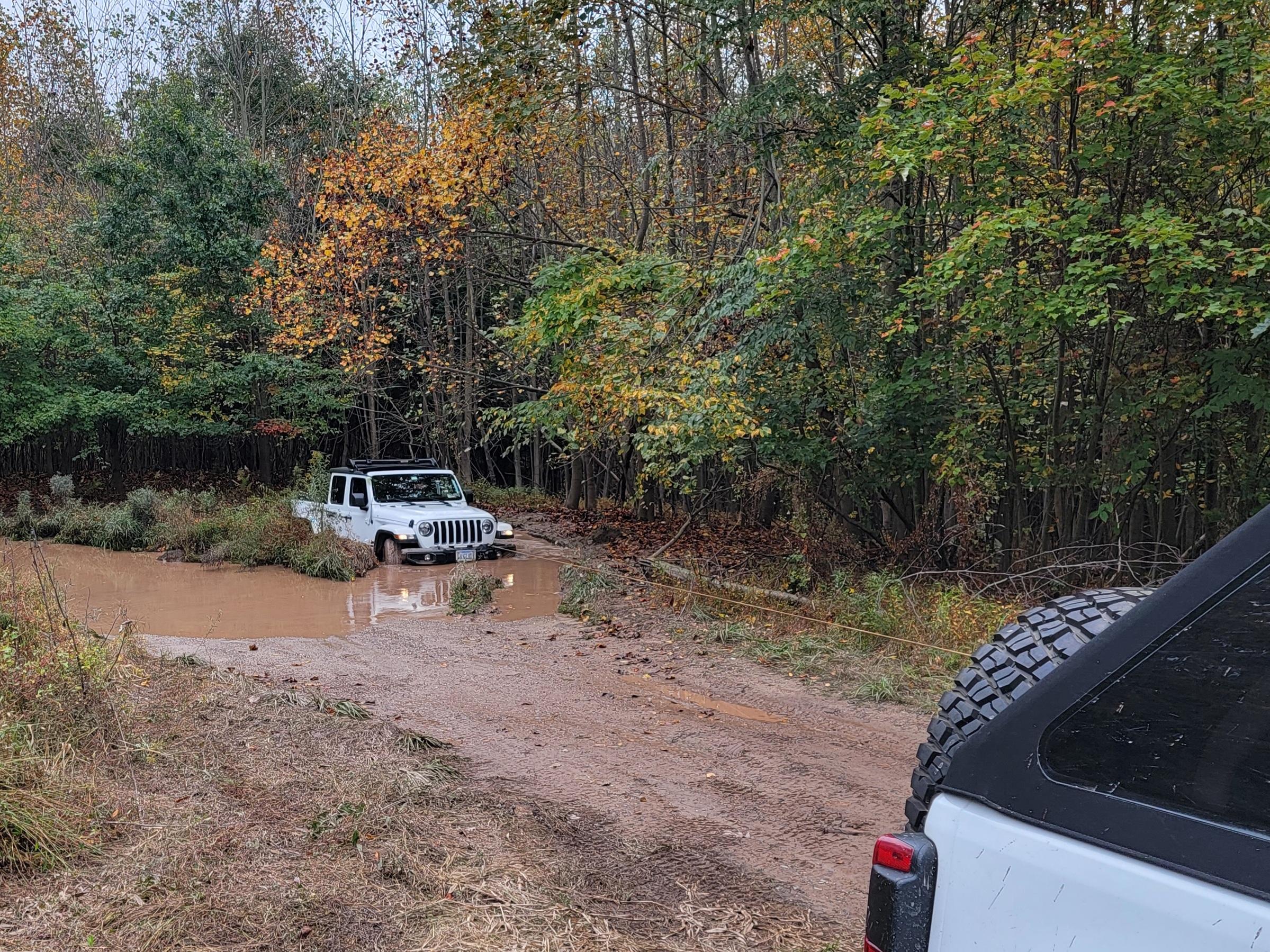

Jeep Gladiator Replace the hooks with loops? IMG_0194
In this case the hooks allowed my spotter to hook me without getting in the water. I think it took him 10 tries before he got it hooked. I was impressed.
