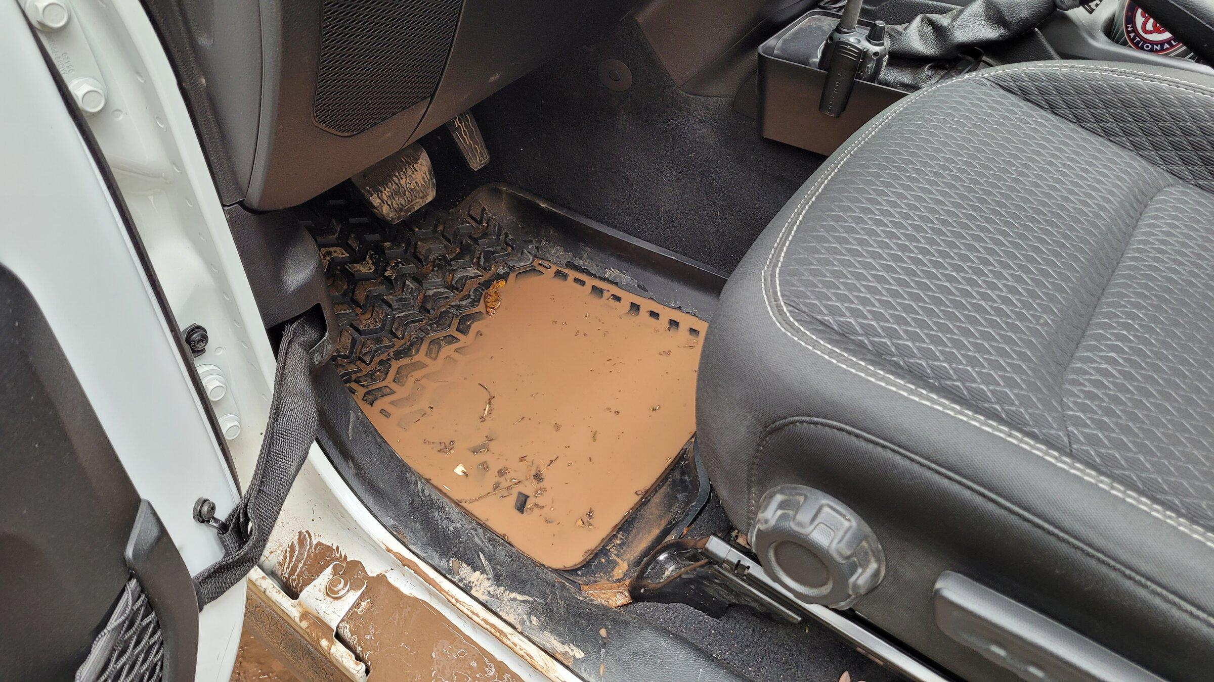

Rear main seal. It seems somewhat common down here in Florida that a long (stuck) dip in stagnant sandy/muddy water is followed by a slow oil leak from the rms.

I'll bet that took a while to dry out ?
Why were you stuck?
I got stuck in the mud. Could not back up or go forward. I tried for a while. I had A/T tires at the time. M/T tires might have helped.
I pulled all the carpet and put a fan on it for a week.
