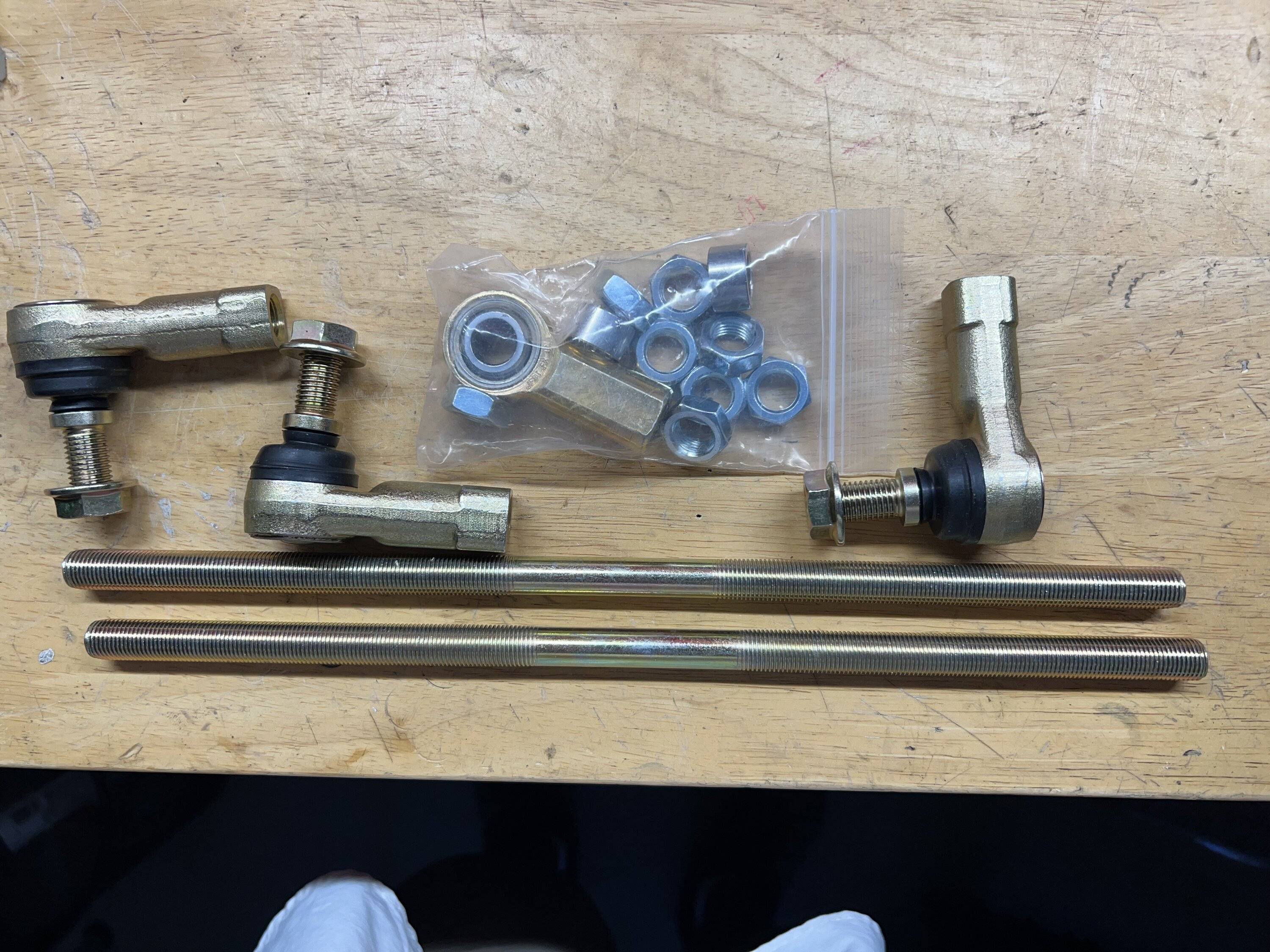

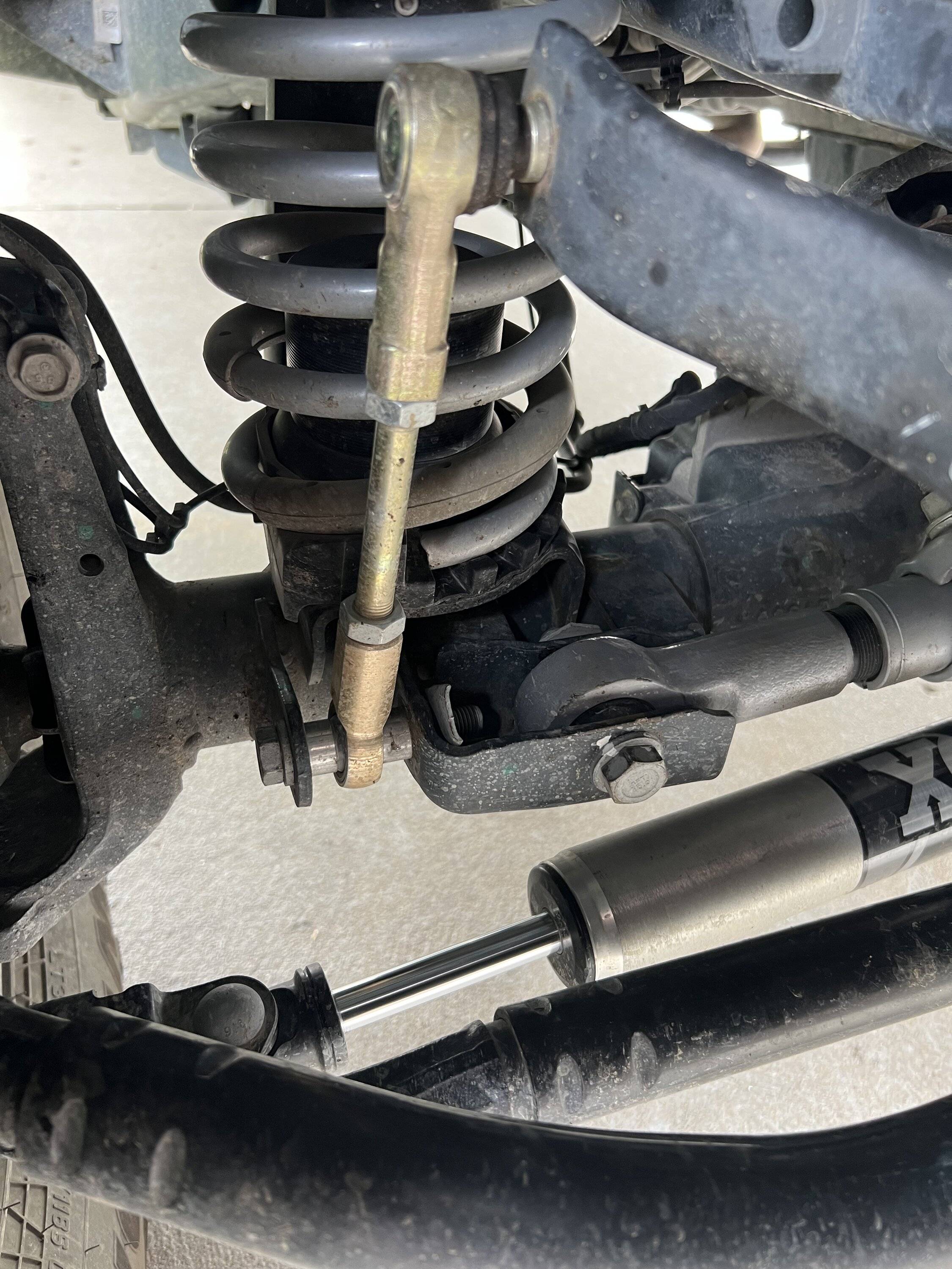

My front AEV (boot) links that came with the 2" spacer lift wore out after less than a year (rears are not looking that great either). Disappointed to say the least. I tried sourcing the Mopar links used for their 2" lift and they were out of stock everywhere I looked. I found Clayton front end links in stock on their website and that is what I went with. Pricey, but they really look like they will last. My sense is they are for jeeps with a bit more lift, but they worked for me by cutting them down to the the 2.5" lift recommendation according to their instructions. Gives me just a touch of angle up on the sway bar which I think is ok from what I have read on this forum. Better than too much angle down and have it flip on me!

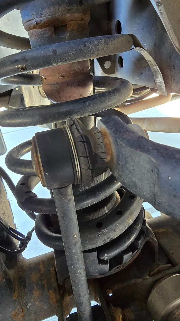

I just noticed the exact same thing on my AEV end links after less than a year. Did you ever contact them to see what they had to say?
Hootbro
Apr 13, 2019
10,209
20,008
2025 Gladiator Sport
Here you go. All boots look the same.
That is pretty nasty. Installed a AEV 2.5" lift on my 2022 Rubicon JT and was also not impressed with the end links. I just ordered the end links that came in the MOPAR 2" lift kits and called it good as they are the same quality as the OEM ones. Kind of disappointing the premium AEV markets their kits as, that they go cheap on stuff like this.
