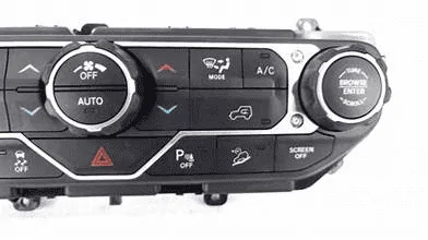

Correct, but the Park Sense, when factory installed does have a switch on the AC controller stack that turns it off if you don't want the sound chirping in your ear. I do have that part and it will plug into my system just fine in my Gladiator that was not built with Park Sense.

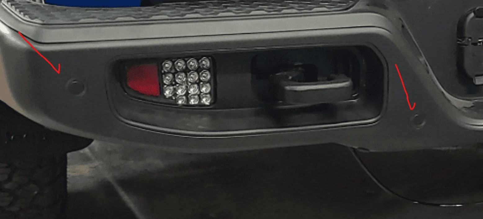

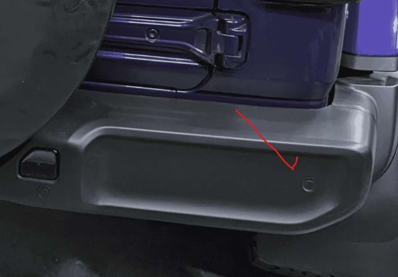

Yes, only park sense, none of those features that alter the movement of the vehicle. Just the warning chirp and dash signal when backing up. I have all the parts to add just the rear park sense (the AC controller with the off switch pictured above, the 4 sensors, the mounting pieces for the sensors, a bumper that accepts the sensors, a bumper wiring harness and the controller module. Just missing where the module is located to see if I can pick up the connections off the main body wiring harness or if I need to have a harness created or purchased.
this is park sense - in the rear bumper.

You need a bumper that puts the sensors in the correct location, the sensors/brackets, etc. and wiring harness.
These include the wiring harness and sensors, but that's not enough itself.
Yes, JSCAN or AlfaOBD can do it, so their kit with the bypass cable and software would be redundant for many of us, it also isn't enough without the bumper.
The sensors have to be located and oriented correctly. So their kit is only part of what you need.
There's no disable button either - I must disable it when towing and so on - otherwise it will annoy the heck out of you. There's no way to do that with a DIY install.
