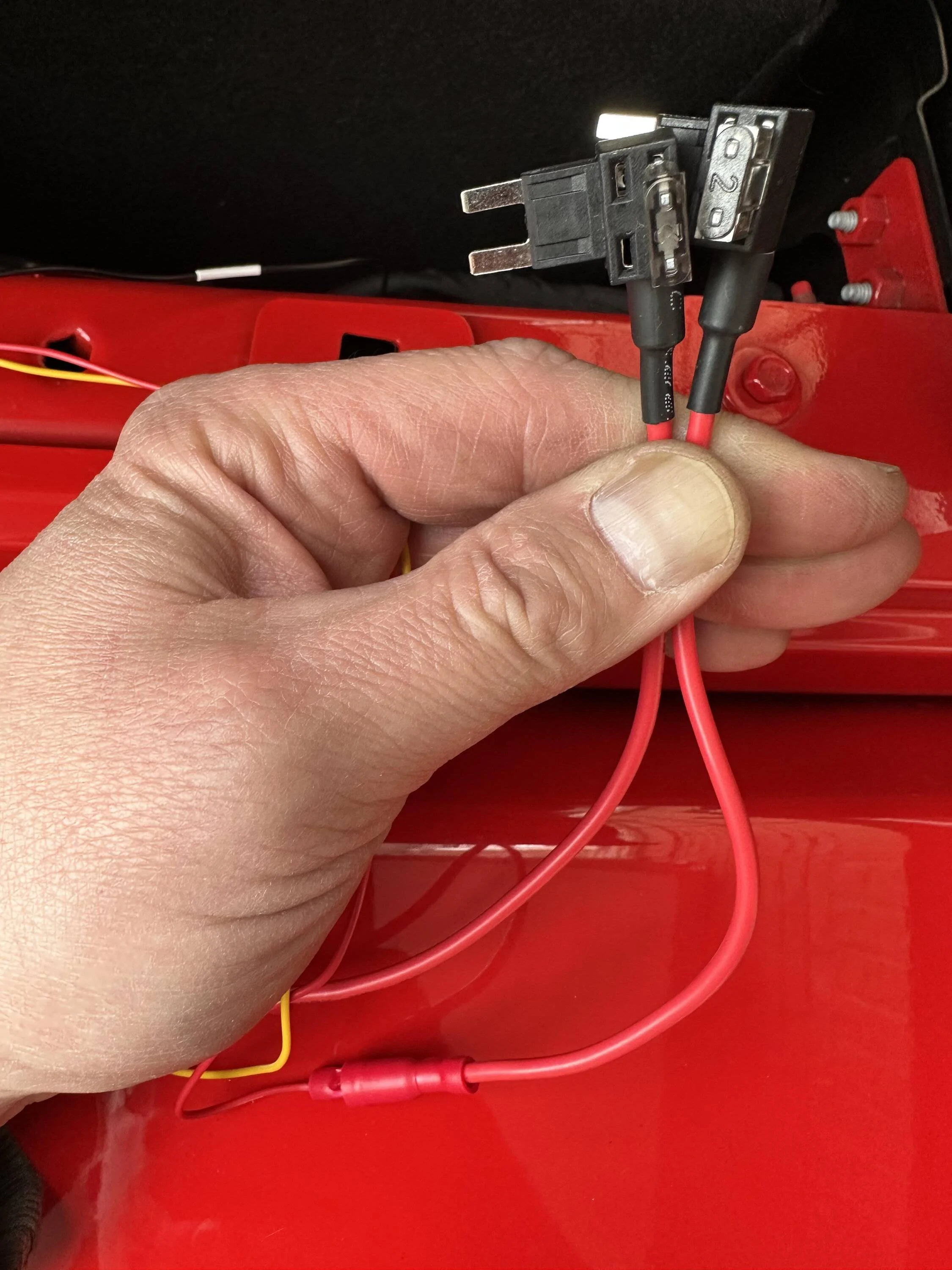

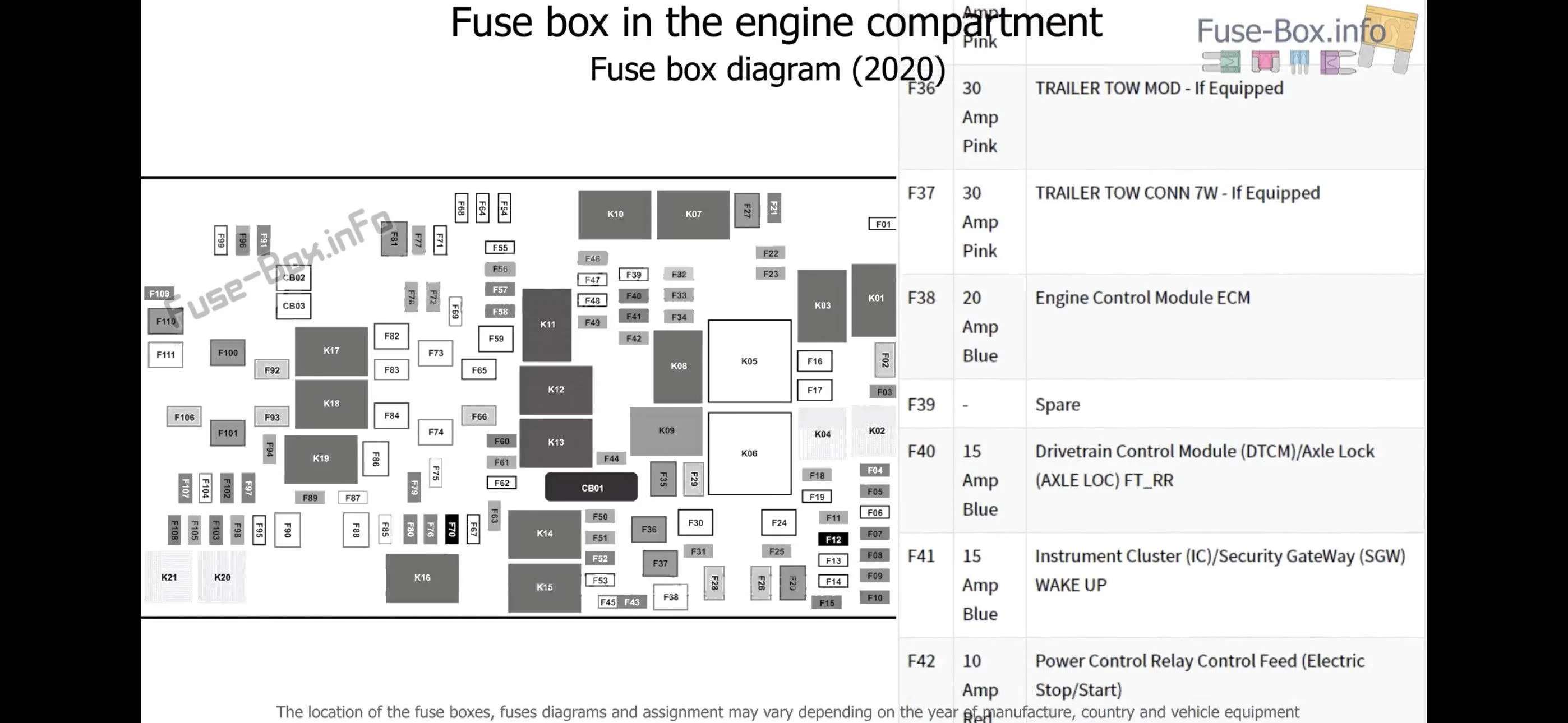

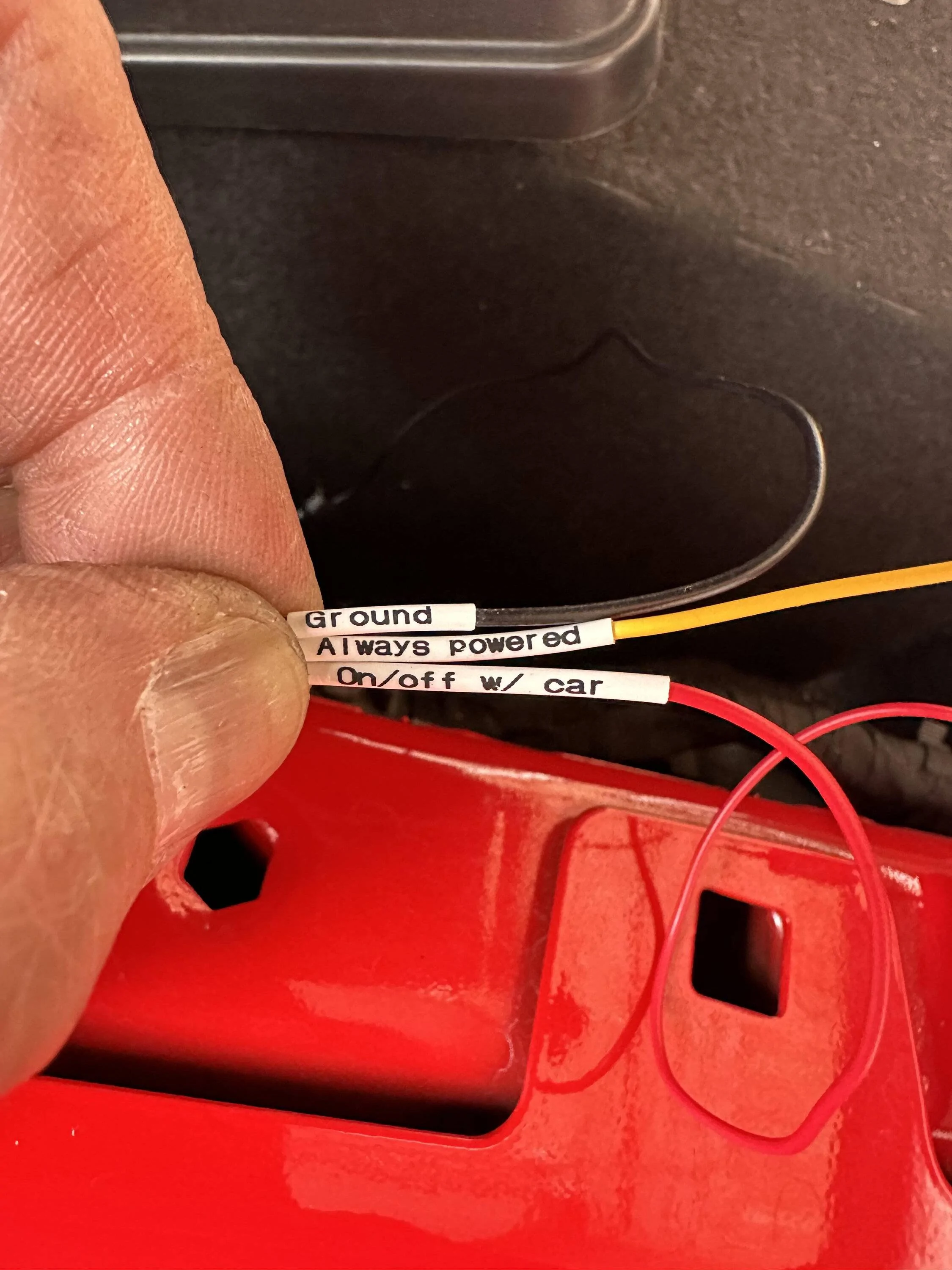

Need some help seeing which fuses are the best to use, and I'm not sure if any spare slots are hot constant or switched. I've got 3 wires, one for ground, another constant 12v, and the last switched. My kit, the Rexing camera and smart hardware kit that records while parked (for medling kids in my neighborhood that have already damaged my truck once). The taps only have 2A fuses, thanks for looking.

Lots of options. For the constant power I go to the battery with either fuse block or inline fuse close to the battery. For the keyed fuse tap you can use the cigarette lighter circuit. For the ground use one of the ground lugs either under hood or in cab. A manufacturer of one of my electrical mods suggested using the cig lighter circuit for the fuse tap.

Thanks a bunch. I'll use the cig lighter (F52-20A Yellow fuse) for switched, and the ground lug is an easy one. Any ideas what slot is for a constant 12v, maybe a spare slot? I tried to test some with a multimeter and the teenie slot these Micro2 type fuses don't have room to reach the bottom and hit the contacts with the leads I've got.

Don’t know about the constant for a fuse tap. I don’t believe any of the empty fuse locations are wired.

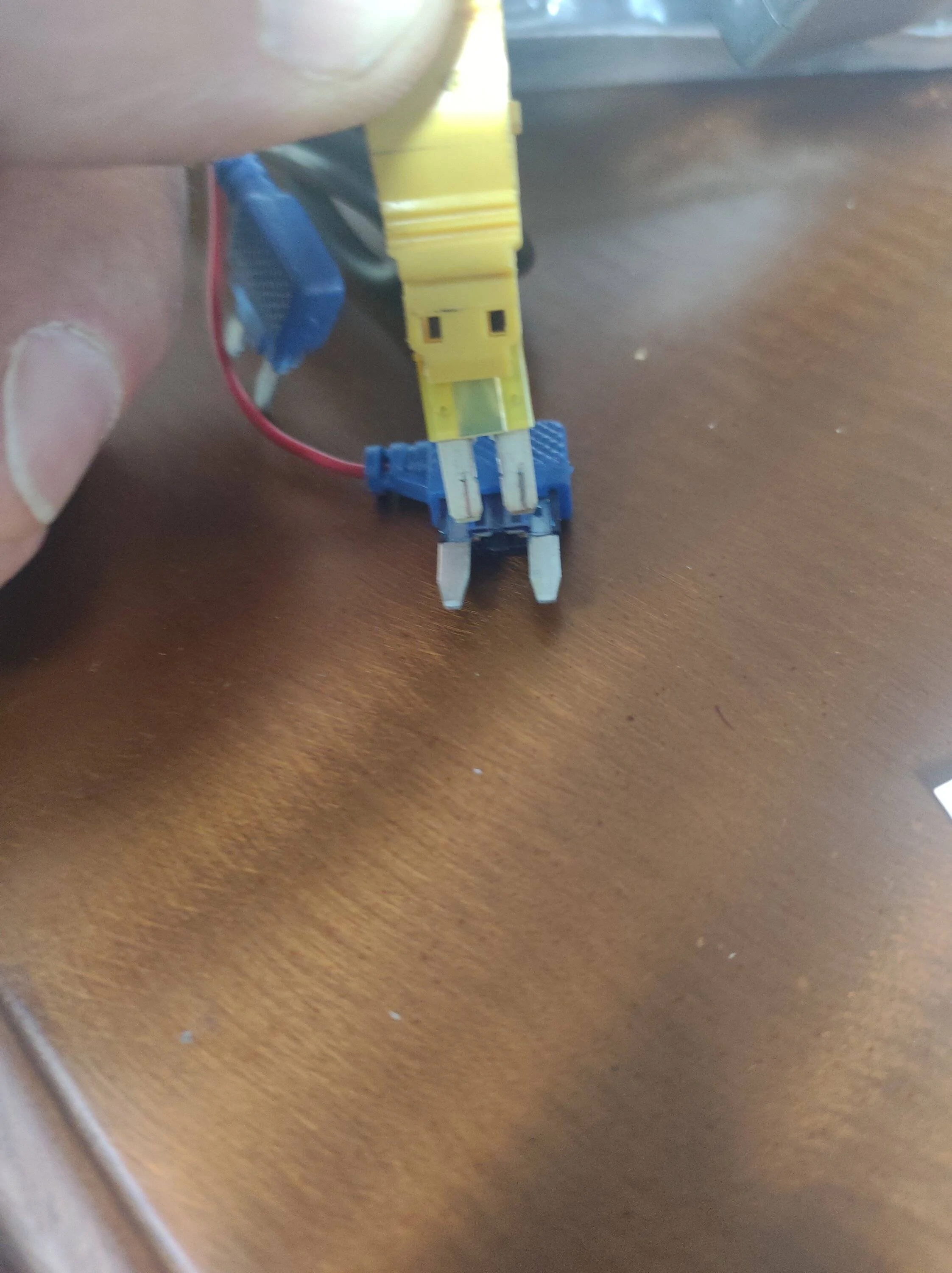

Did you end up taking out the original fuse and replacing it with what's pictured? My camera is a little different. A little larger on the prongs. 🤔 Now what?

I ended up installing two fuse taps. One in F102 as a always hot, and F52 as switched. I'll have to figure out how to wire in the backup camera set up. From what I understand I have to tap into the reverse circuit so when I put it in reverse it show the lines on the camera. Works perfectly so far.
