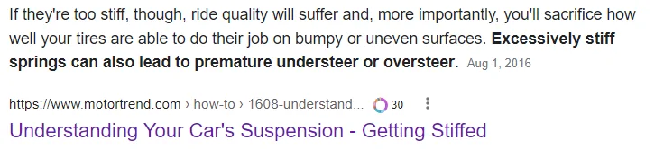

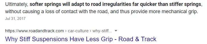

Yes, hard to understand - because it's physics. The lighter truck on stiff springs will result in a bump causing the truck to move up - it's lacking inertia the heavier truck would have so the axle, spring and truck would move upward more as a unit where a lighter spring would flex and compress before it was able to move the truck upward.
But Rubicon springs can't really be compared to max tow springs, either.
Max tow springs are a lot shorter than Overland springs and yet - the truck sits at the same height with the max tow springs.
My front Rubicon springs are the lightest they used. Couldn't find a heavier set.
I guess you have to define "Stiff"............ and then it's like anything else, there's a point of going backwards. You reach a peak and then anything beyond that makes things worse, not better.
