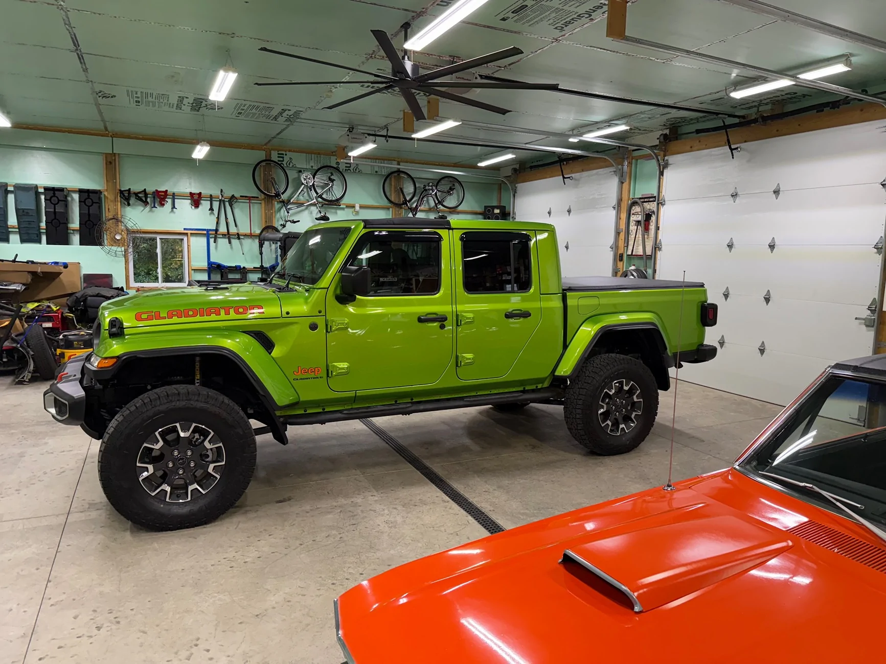

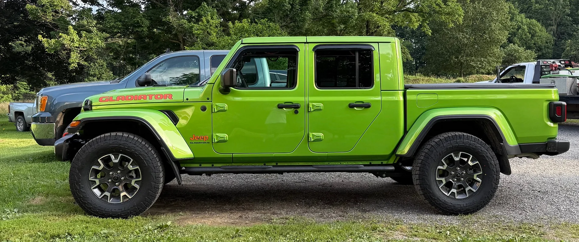

I have a 2025 Sport S and I have 35x11.50x18 on mine, I have 18” wheels on mine due to it being a Max Tow version. I ran the 35’s with a 1.5 leveling kit from TeraFlex with no issues at all. I have since upgraded to the AEV 3” suspension lift . First picture is with the 1.5 kit

Thank you for your response. And very nice looking Gladiator. Looks bad A$$.
