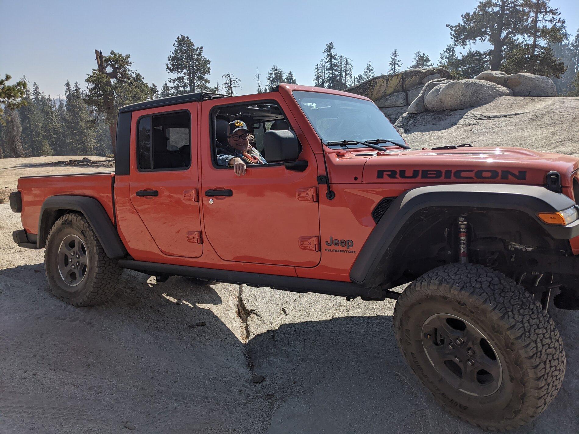

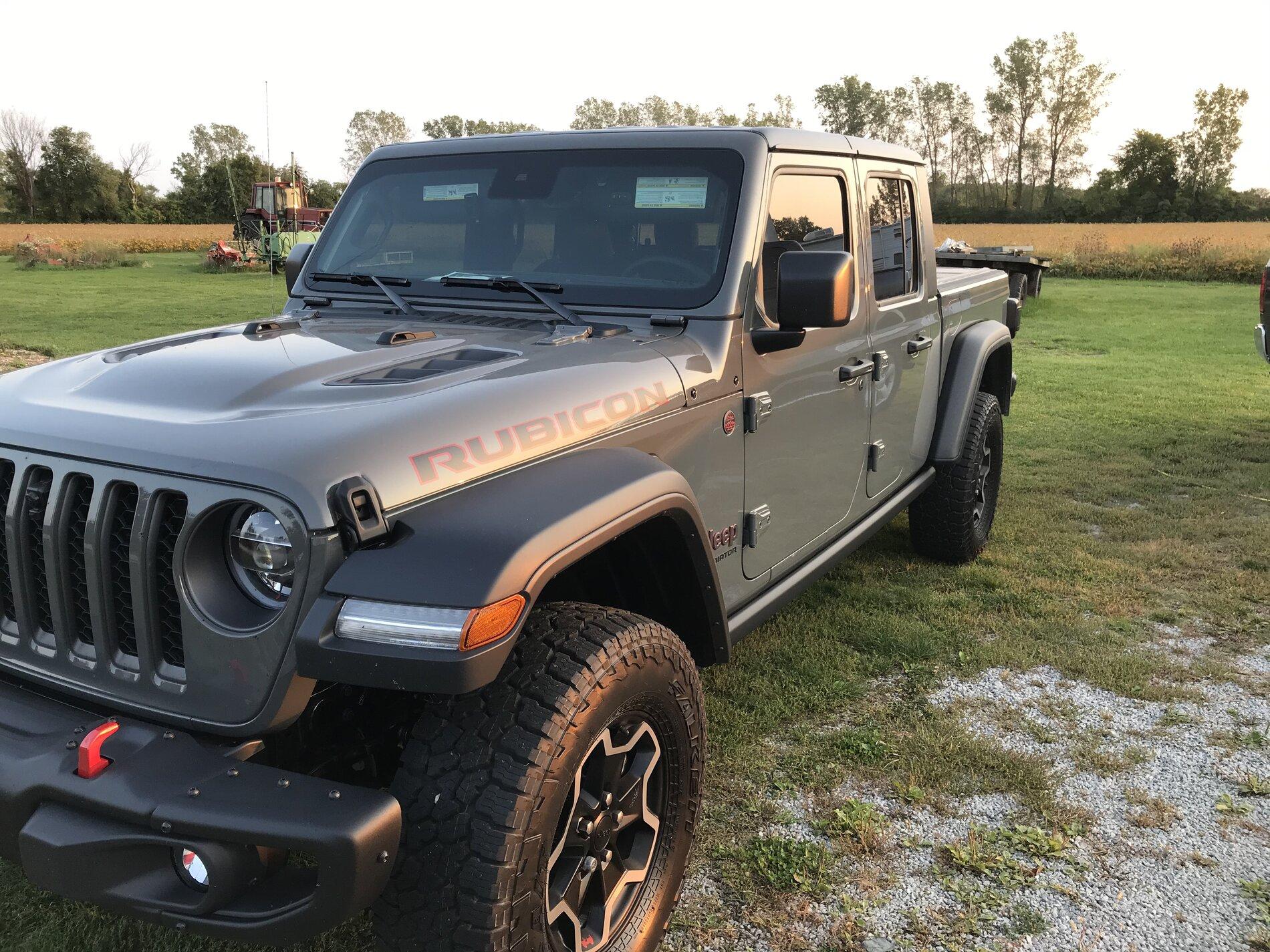

You’ll get all the nay sayers. But you’ll be just fine. The 12.5 works perfectly fine on stock Rubicon rim.
I’m running 35x12.5 duratracs on my stock rubicon rims.
The tires don’t look bulged. They will hold the bead better than if they were mounted in a 10” wide rim.
I got my tires at my local discount tire store. No issues.

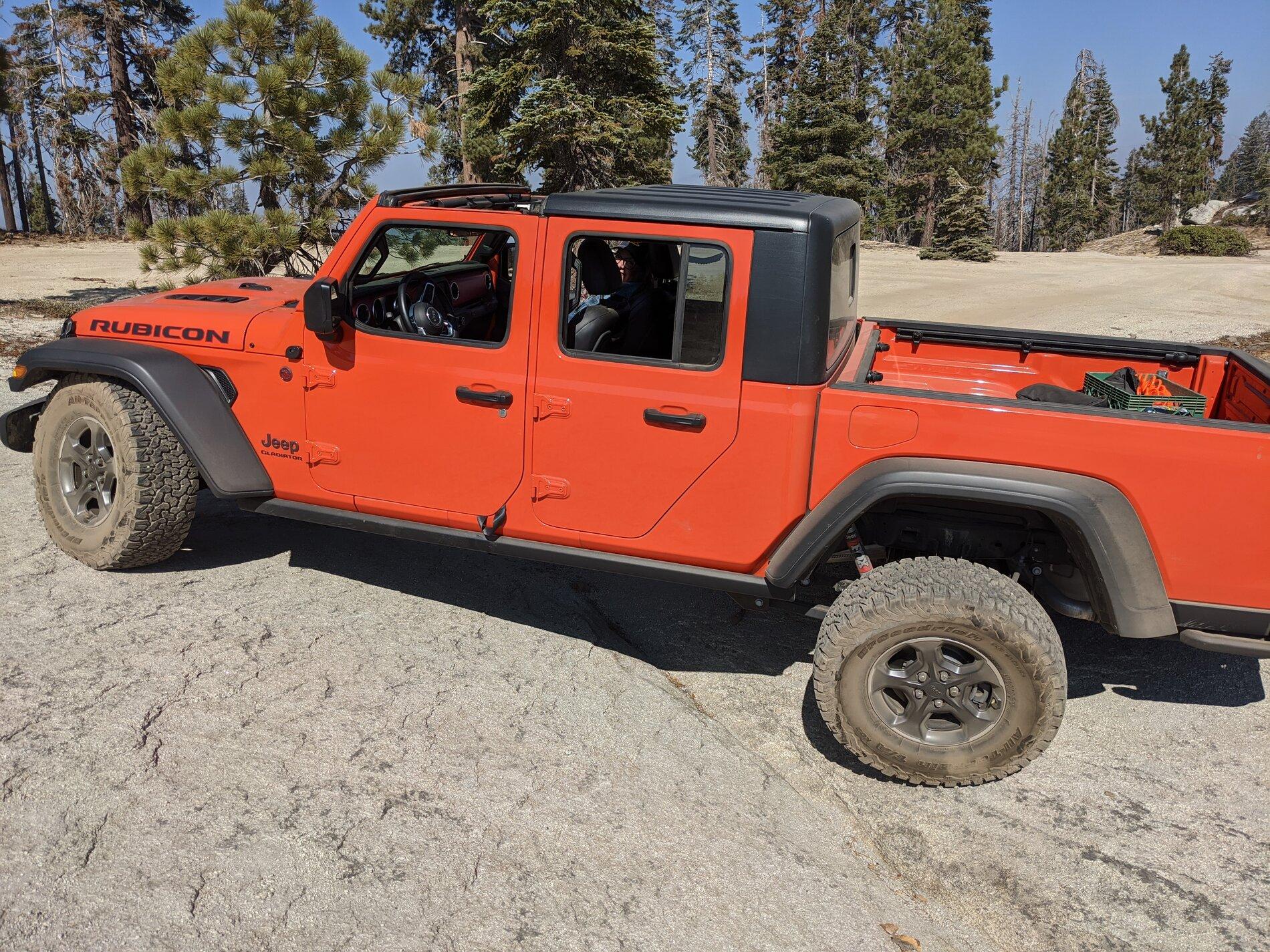

Exactly. I run 315/70R17 BFG KO2's, metric 35x12.5. They work well on the stock wheels, which I really like the look of. Of course I buy my tires from my local 4x4 shop, they know WAY more about any possible issues than I do and they don't turn a hair.
