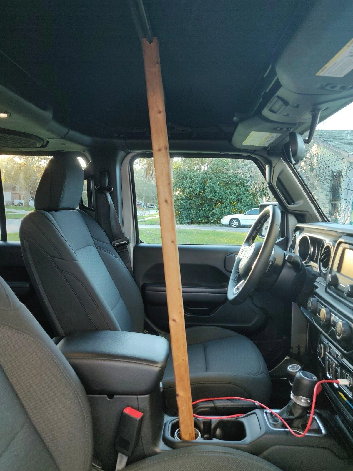

Found this on another thread and emailed to my dealership. They are going to take another look at the issue. Other pic is my temporary fix as I have to make another trip tomorrow.
Good fix, I saw one on You Tube who used an adjustable tripod. Dealer says my new top should be into or tomorrow and I cannot wait to get it installed and see if that fixes this.
Just drove 4 hours down I-95 and fix worked. I'll be seeing my dealership when I get back home. Hopefully they already ordered a new top. I saw the tripod idea too, that's why I tried my fix.
That's a pretty good idea. I'm still thinking of a soft top just the basic one to save money but all the bad stuff about them makes me not want one. Fun fact...only 5% of jts being sold are softop. Pretty cool
I finally got the new top put on and it fixed the problem. I was doing 85 on the PA Turnpike for a few miles this morning with only the normal soft top noise. I will upload a picture of the repair order from my dealership shortly. They did not replace the entire structure, only put new fabric on... but it did the trick.
