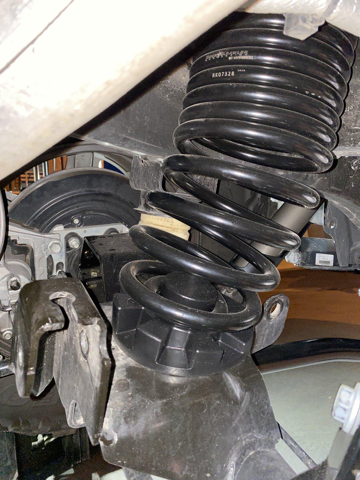

Another question......
What size are the rear coil springs? My order shows them as being 3” (RK07328). I thought they were updated to 4” springs?
The production kits have always been a 3" kit, which raises the front roughly 3 3/8" and rear 3"

I meant to say diameter. The rear spring is a larger 4" diameter?
Also 4WP is showing Part #: RK07460 and RK07328 as being part of my kit which does not include the seats.
Shouldn't those part numbers should have a K at the end of them according to the RK site. (RK07460) and RK07328K)

The spring seats will be in your kit box, not in the boxes with the springs, those part numbers are correct.

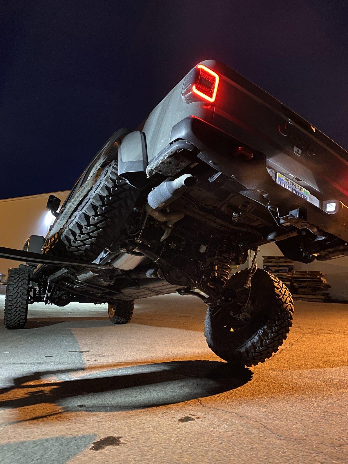

Got my Evo brake lines yesterday and took the time at the end of the day today finishing up at work to get them installed and swap to my Falcon rear shocks, then forklift flexed it in the back lot to check all my clearances. Should I have any concern for the full compression of the front coils at flex/bottom out? Still had another 3/4" of shock travel as pictured, couldnt tell if the bump stops were being hit yet. I used 2 of the front bump stop spacers after measuring shock travel vs bump stop location, didnt expect the coils to compress to bind first. Also had to extend the rear sway bar links another 3/4", they were basically pulling straight at 13" at full droop which I didn't like.
rear all looked good at full flex. measured 32" under the lowest point of the tire at full flex lifting either front or rear. Solid articulation, was hoping to see a full 3ft but oh well.

RK recommends 3 bump stop spacers up front.

@Rock Krawler Suspension, my rear spring seats are different than the ones in the instructions and from what i see others here have. Are there two different styles? The ones in the instructions that are different than mine look to support and hold the bottom of the rear springs better.
