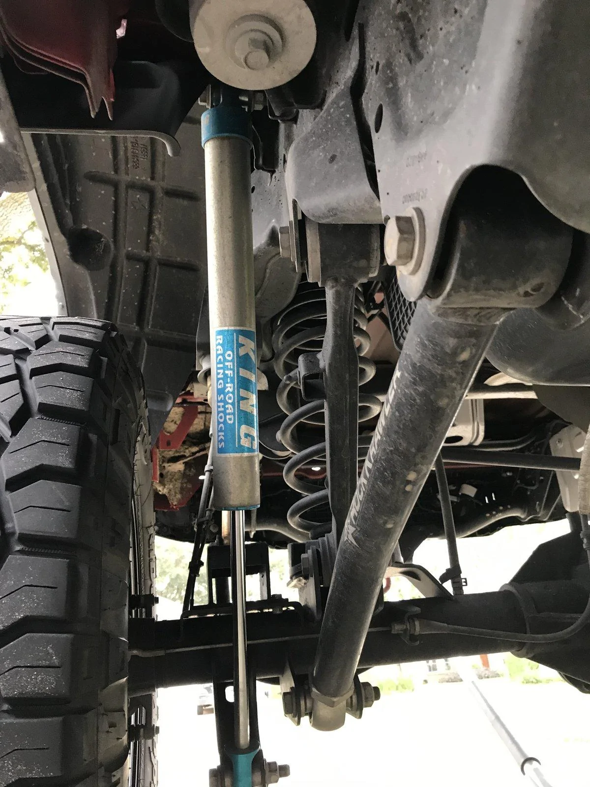

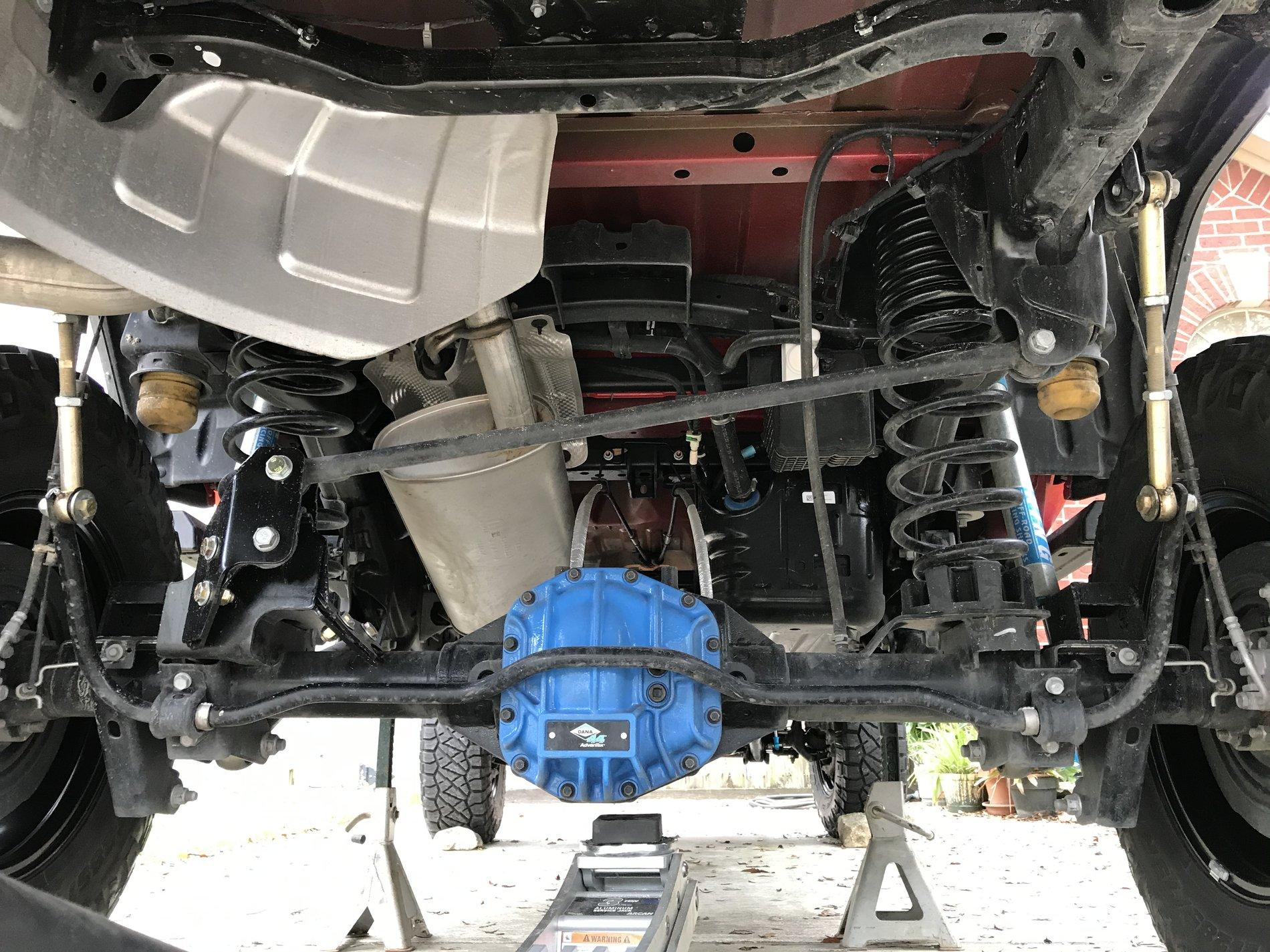

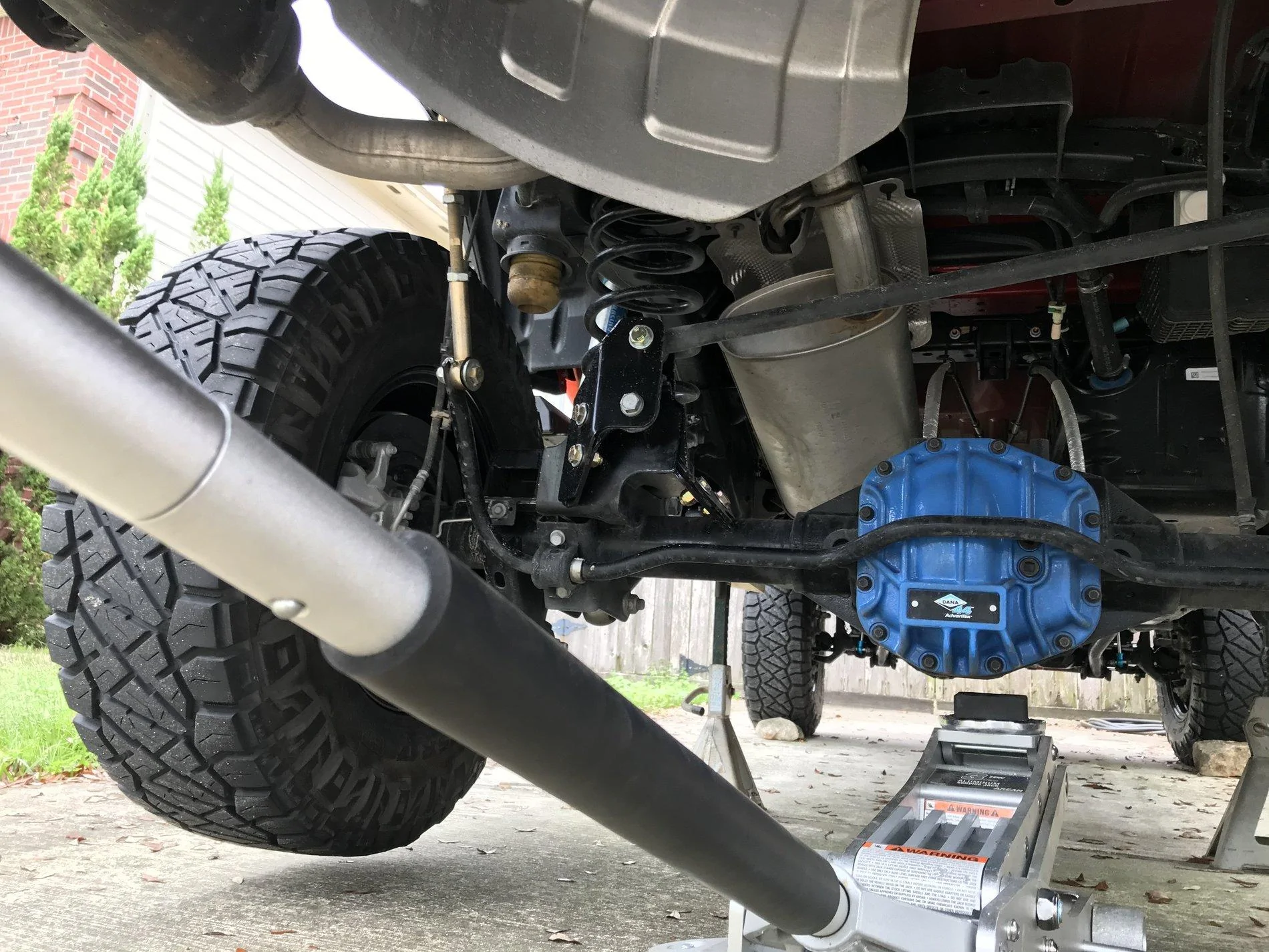

Ok today i drooped the rear unbolted the upper brake line bolts to give an extra inch or so. So it looks like the rear sway bar stops the axle & the rear brake lines are not tight but fully extended. I disconnected the bottom of the shock & measured them 30” long from center of eyes. The springs never unseated. I already ordered rear brake lines just for assurances. So i like the shocks do i need limit straps? If so how long?
