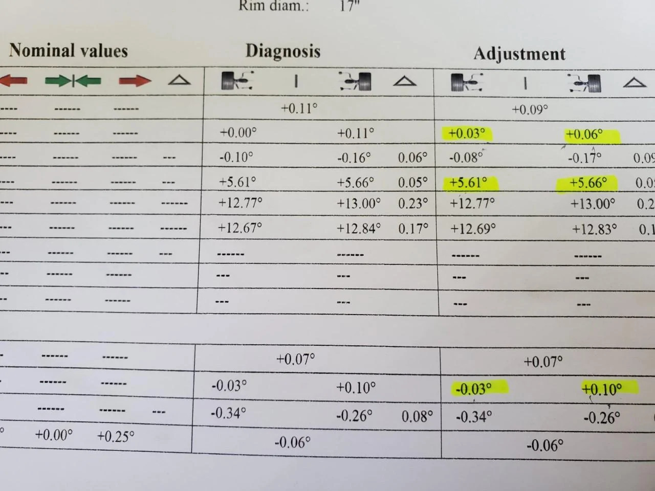

I just want to give a huge shout out to RockKrawler on the 3.0" Pro-X 'no limits' Stage 1 lift. I installed mine about 2 weeks ago or so. Recentered the wheel and drove it a couple hundred miles. Truck drove perfectly. I installed the last piece, my Synergy tie rod this past weekend and took it in for an alignment this morning. Have to say, the measurements that RockKrawler gives you for your lIft arms to preset them to is absolutely dead on. My alignment guy came out after setting the truck up and getting started and said to me, Dam... other then a little adjustment to center your steering wheel perfectly it is dead on the numbers and right in spec. Caster was perfect and when I installed the tierod. I set it to the measurement I had rotor to rotor and added about 1/16" toe in.
Next step is to install my tires. Attached is my alignement sheet.

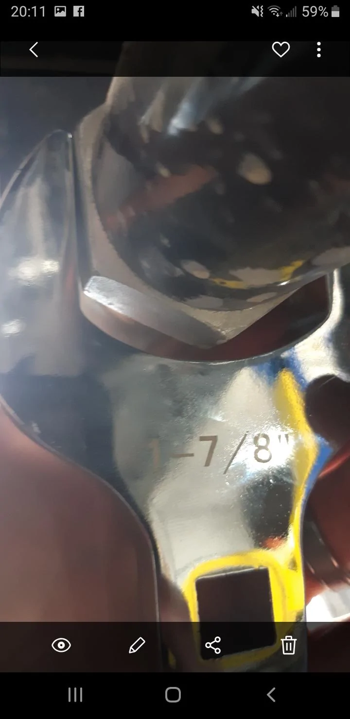

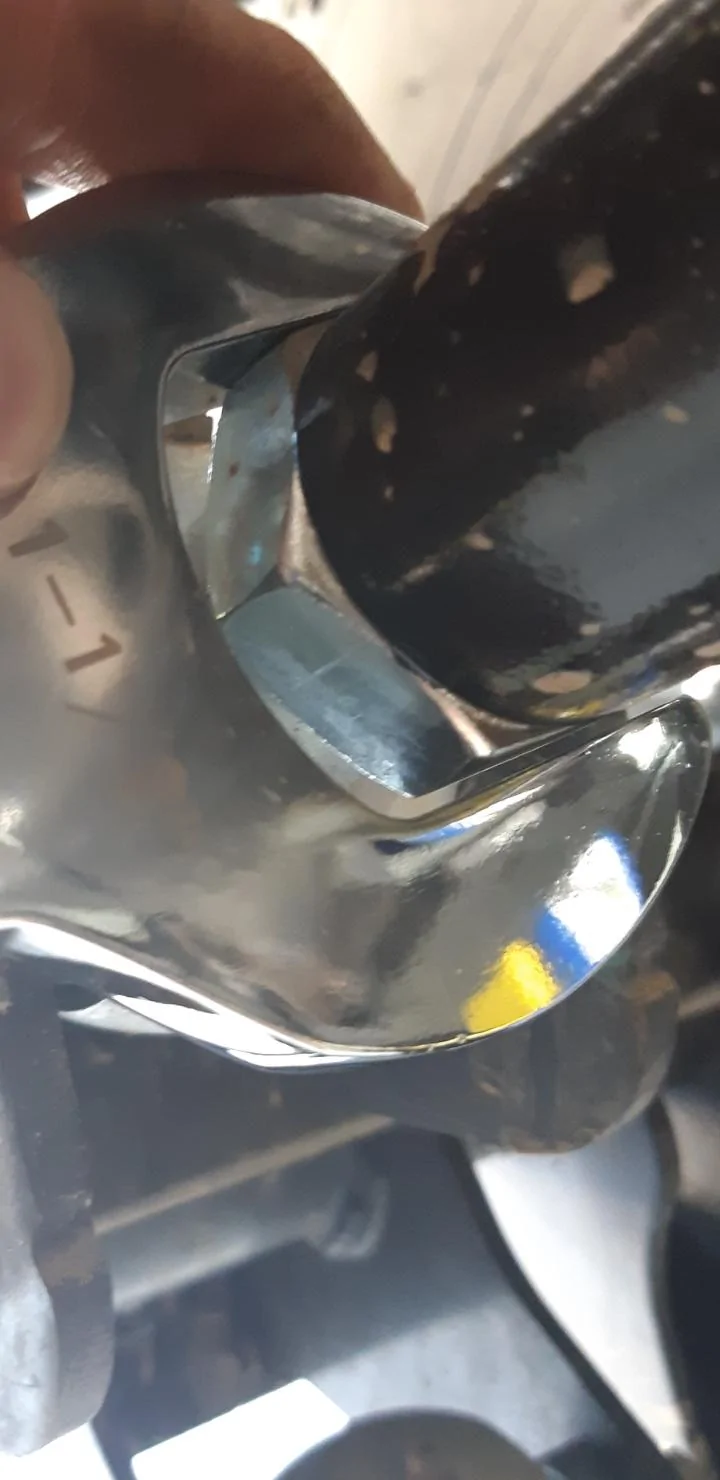

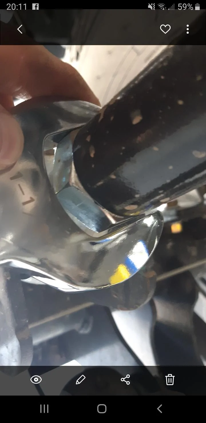

I know I've already gone over this somewhat in a earlier post but I wanted to follow up. I ordered crow foot wrenches to torque all of the jam nuts. I ordered the wrenches based on what RK instructions say the jam nut sizes are.. Well that was wrong, so I called and talked to Andy at RK he told me the two bigger size jam nuts were 1 5/16" and 1 7/8" so I ordered another set of crow foot wrenches to accommodate that... Well those dont fit either.. I know other folks have chimed in on here and said that's what size theirs were.. There is no way to torque to 275 ftlbs with those size wrenches.. The nuts seem to be metric.. Every SAE wrench is either too small or too big.. If you bare down on them with a torque wrench and a crow foot the size RK says the nuts are you will round them off.. Surely I'm not the only one that has had this problem..
I agree that my Crows feet had some play in them as well but I had no problem torqueing them and not rounding them off. Just made sure the crows foot was seated all the way on the jam nut. There is a lot of metal there to move and round it off, not an easy task. But, I pulled al my arms back out and torqued them in a vise, not in the vehicle, which makes seating the crows foot a lot easier. How did you torque yours?

I have them as tight as I could get them right now. 185, anymore than that I can jump the wrench off the shoulders of the nuts.. There is more than "a little' play in mine.. Those pics are with no force applied.

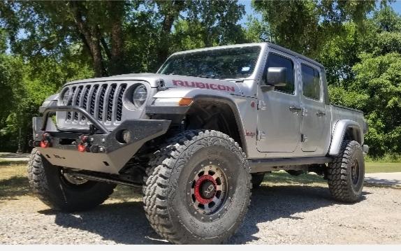

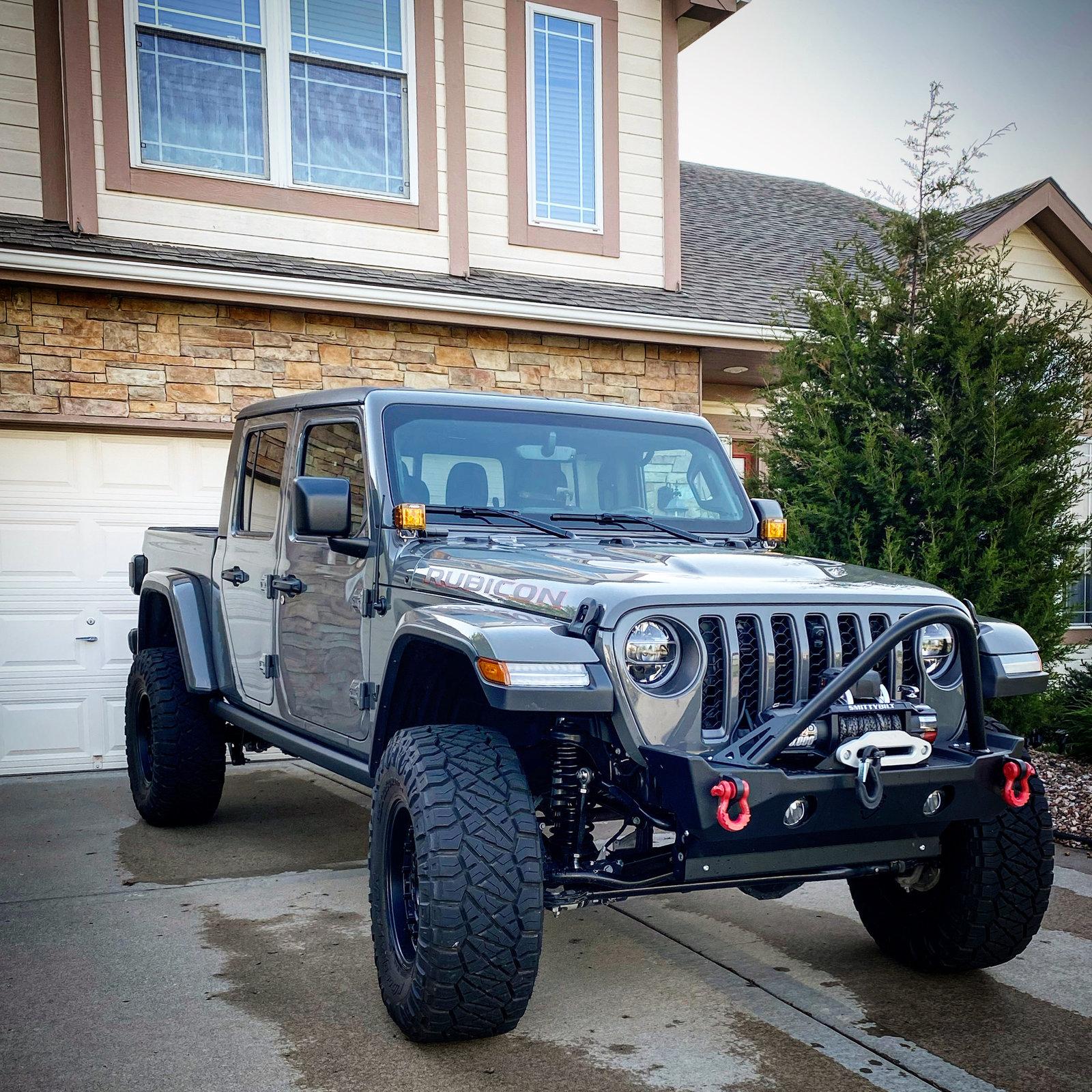

What a world of difference the lift made. Love it. Took me a bit longer then most of you at just about 24 hours. But I did do it all alone on the floor of my garage. As with modding anything there will always be something that you are going to have to work through on a "bolt on" kit. Quality of the kit is exceptional though. It was a good weekend!
Congrats brother!! Looks great!! Great color choice as well!!
