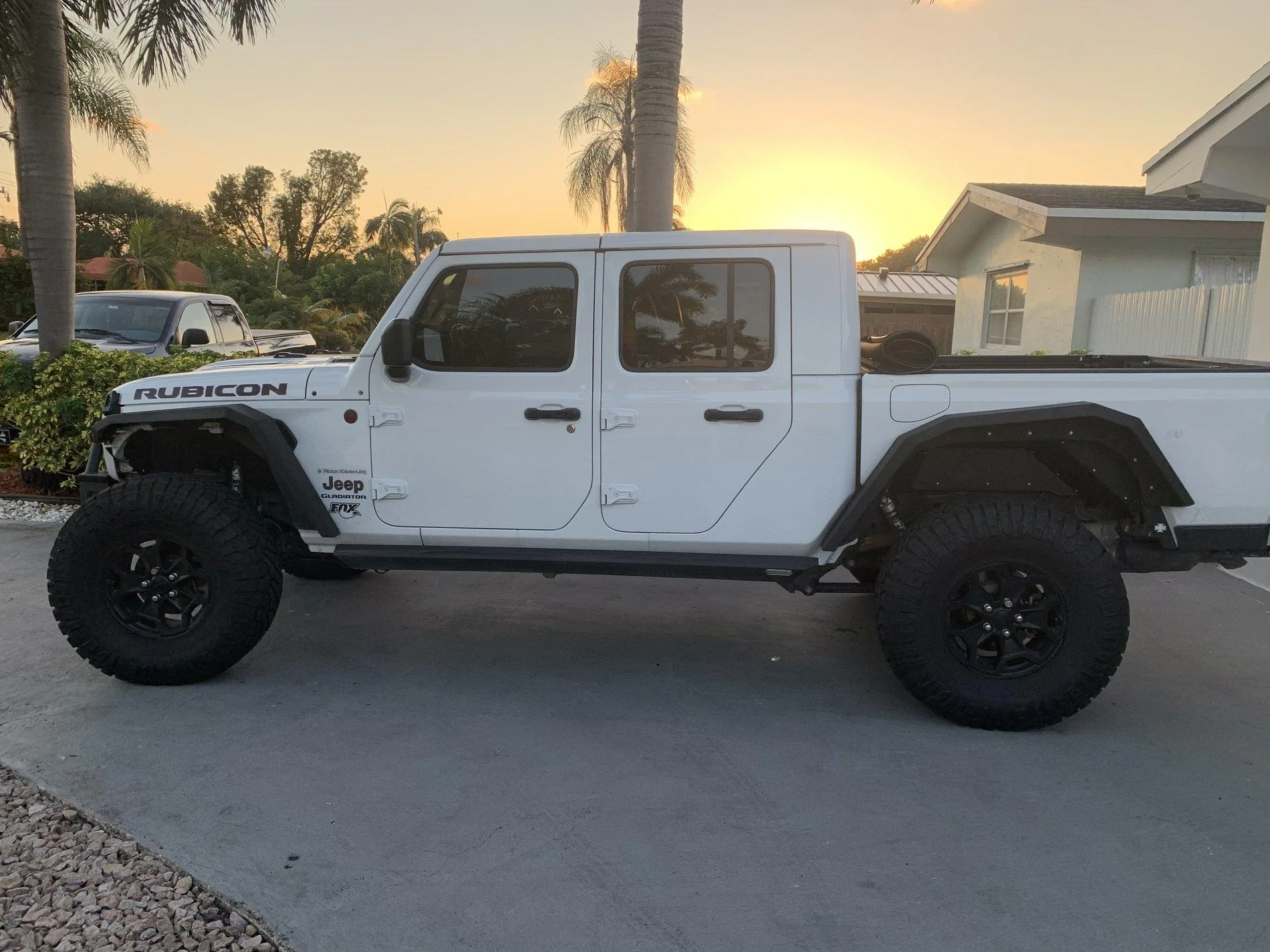

Well I'm about 3/4 of the way done with installing my Pro-X kit on my JTR. Starting this morning about 11am and knocked off about 6:30 this evening. Still need to finish rear, line up draglink and make sure tracbar is centered, and install my extended brakelines. Will be back at it tomorrow morning early.
All went pretty smooth. Drilling and tapping the rear axle was simpler than I thought it would be. But...installing the cradle...dayum...it fought us all the way. Had to wallow mounting holes on cradle and e brake bracket. It was the last thing we worked on and maybe we were just tired but it was a battle but alas...it is done. Can't wait to wrap it up.

I had to recenter my steering wheel due to readjustment of the track bar. It was off by about 70 degrees Clockwise and caused the JT to disable traction control and cruise control. Apparently there is a steering wheel position sensor that needs to be in sync with other things and because it was so far out of wack it disabled things and I would get the message to “Service Traction Control”. Easy fix to recenter by adjusting the drag link. Once re-centered all was god again.
AND when you’re done......... you’re in for a treat when you drive it. A much better driving and riding vehicle. Not a “Jeep thing” anymore LOL.
I look for any little reason to get out of the house and go drive it now. I pack up the wife and our 2 min-pins we go ride the back roads out here in our rural area every chance we get which is lot more than we did with the RZR we had. Hell, we all went to the car wash once just to go riding.
You’re gonna absolutely love the new Jeep you just created. ENJOY!!

I got my lift completed yesterday. Unfortunately I haven't driven it yet and still need to make sure front axle is centered and recenter my steering wheel. I had a slight emergency. My oldest son who is Army ROTC at Virginia Tech was sent home by the University as they continue to try and limit the campus population as much as possible. Anyway his Jeep Liberty's A/C compressor took a dump in West Virginia on his way home and I had to drive down and trailer him home last night. So before I left to get him I wanted to get my Gladiator done and off his lift. I figured I'll come back over this week and finish adjusting and tightening what I need to and bring it home.
The lift install went smoothly. My hats off to anyone who installed this kit on the ground. I originally planned to do it that way till my buddy said his lift was open all weekend. Took my youngest son and I about 10 hours total to install including installing new stainless brakelines and replacing my Draglink with a heavy duty Synergy. I have the Tie rod and stabilizer relocation kit as well but figured I'd install that at home right before I take it to be aligned. I have already sent a message to Rock Krawler because my kit was missing the rear bump stop pads. But no biggie, can install those easily enough later. Here are a bunch of pics of install, finished product, and my piece of roadkill....LOL
I did mine on the ground alone and it was a workout, lucky you had that lift available. Good work!

My hats off to you. Not saying it can't be done but having the truck on the lift definitely made it so much easier. Would of taken my son and I much longer.

Will get those installed asap after I get them. I really appreciate your assistance as well as your time when I had questions. Thanks again. Quick question, how does the position of the front swaybar look to you? I have the links adjusted to recommended length but notice the bar tilts up a little as compared to horizontal when stock. I'd imagine that even if I shortened them all the way they still wouldn't have the bar horizontal.

Brought my JTR home last night. Went back to my buddy's house. Tightened and aligned up the steering wheel. Was finally able to take the JTR for a ride. Definitely a noticeable feel. Very solid and stable. Haven't checked were my caster is at but I have none of that darty, squirrelly feeling in the steering wheel so it must be pretty darn close to where it should be. Was only about a 25 min ride back to my house but the smiles per mile were endless!! Very happy with how looks, rides, and handles. Next is to get my Synergy tierod on and alignment done, then my tires and wheels.
