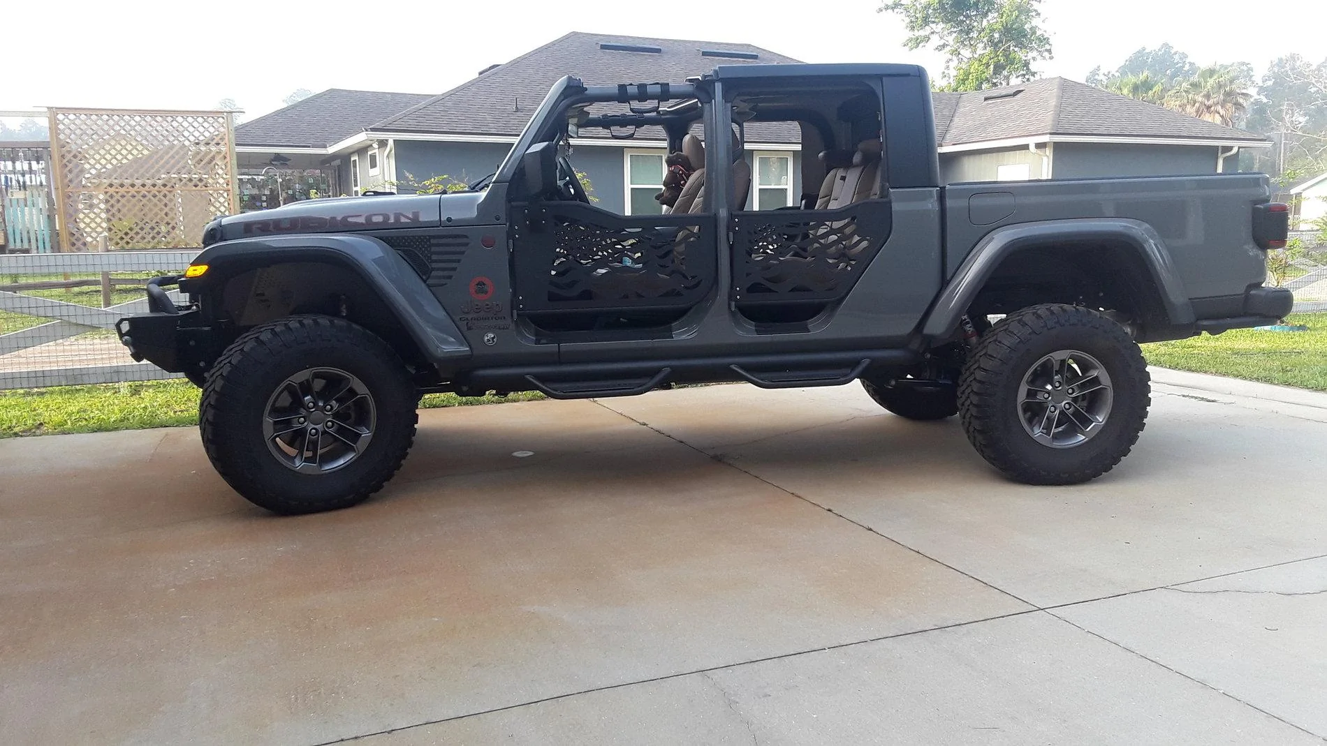

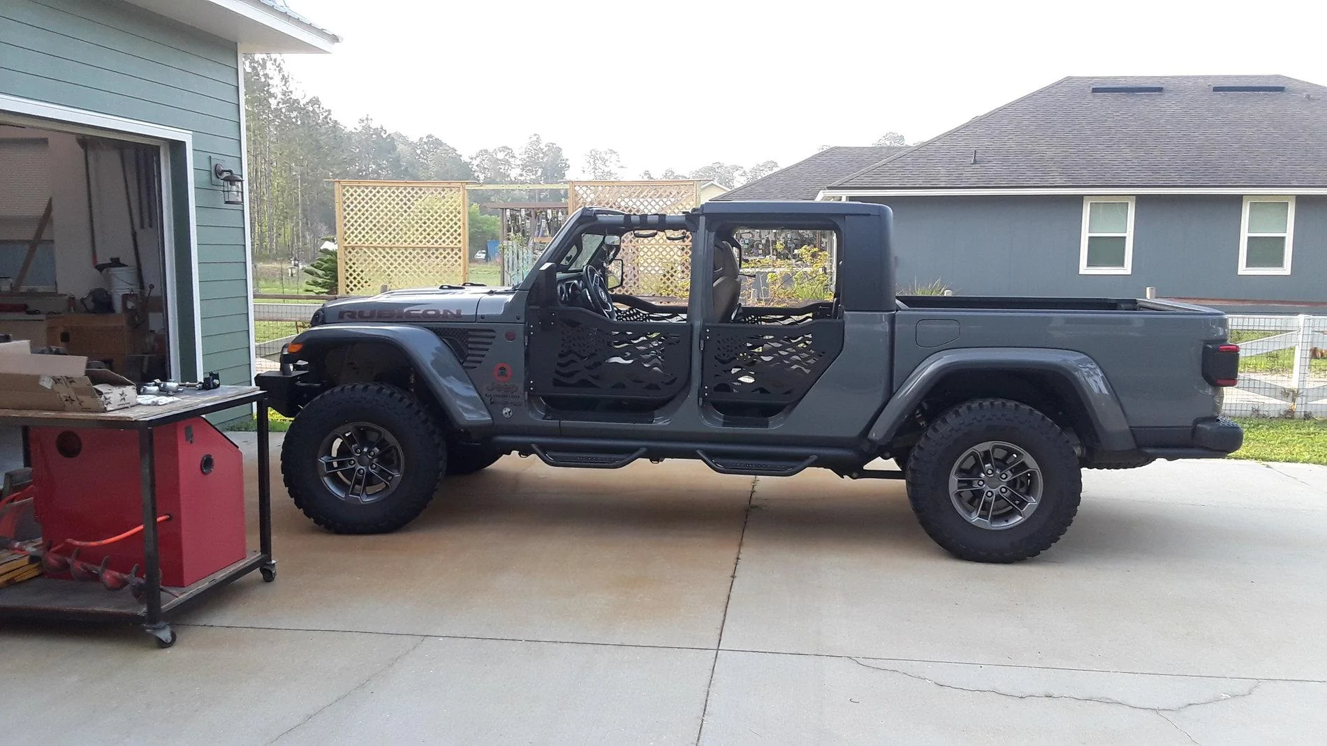

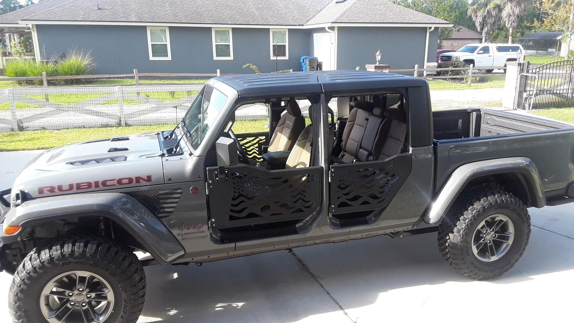

Just a big shout out to tech Support and Adam C. at RK.... Had an issue during install and Adam jumped right on it to assist... turned out I installed the Upper Rear Control Arms (JT Pro X kit) upside down (Adam, please put a pic in the instructions), got it sorted out and everything's great now! One man install, 16 hrs going slowly and pre-adjusted all arms on the bench prior to install I have prior experience with installations and the tools needed, except a lift).....Test drive and this kit already feels great! It will need 3/4 front spacers to level the front out and will run extended brake lines shortly as an extra measure of safety as they are at their limit. Alignment next week and final torque of all components... Thanks RK!
Looks great, can't wait to install mine.
Are the 3/4" spacers something you needed because of heavier front end items? Bumper, winch, etc or just to completely eliminate any rake?
