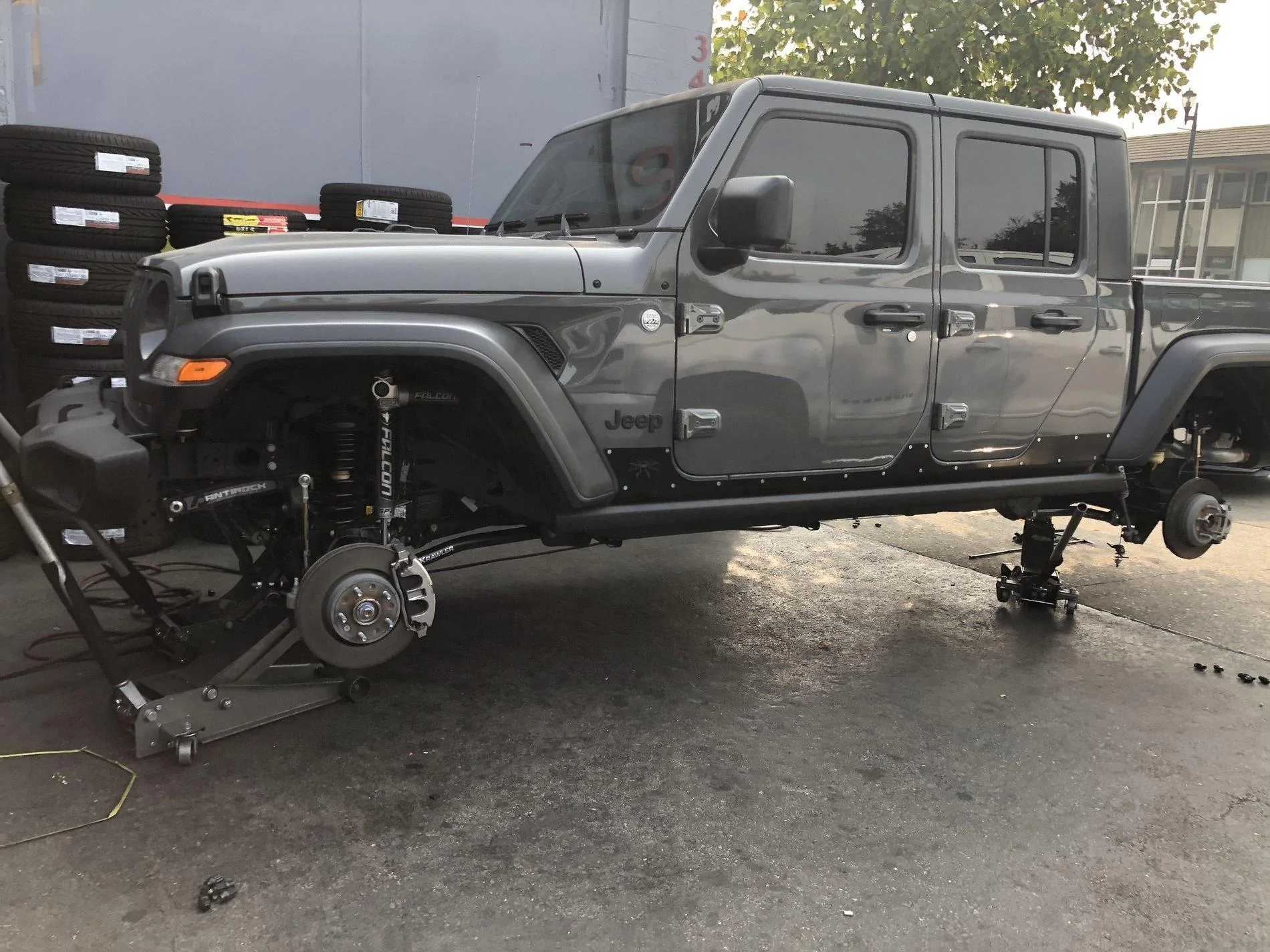

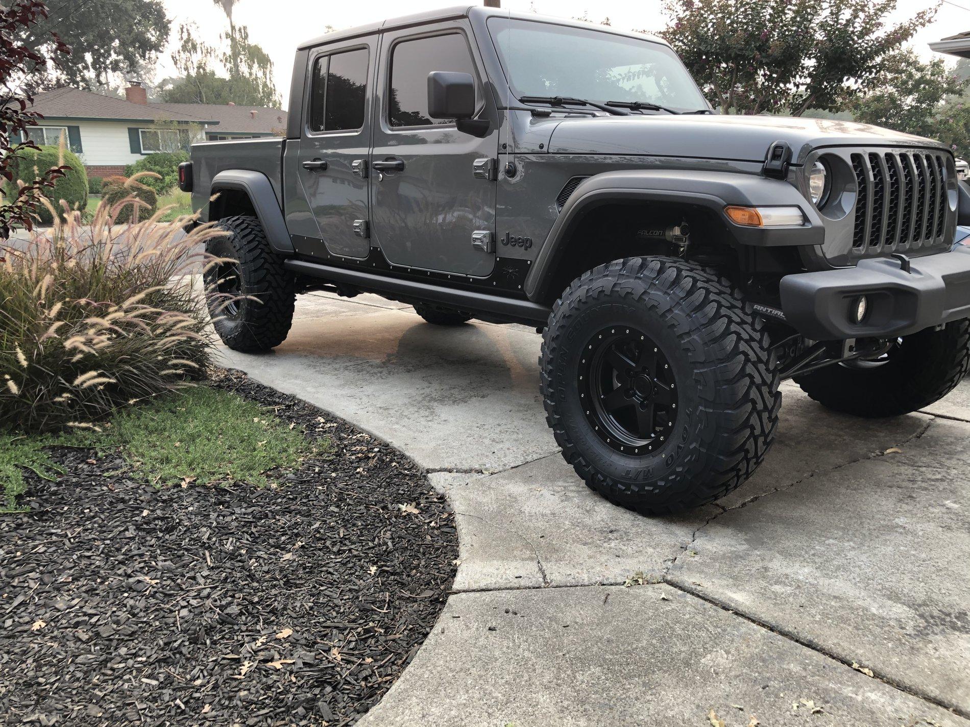

I just finished installing this kit topped off with some Falcon SP2 Shocks and 37s and she rides amazing. I will say getting the progressive springs Installed in my drive way was a little more work than I anticipated but we’ll worth the effort :note picture was taken at a tire shop while getting my 37s installed. Gears following in 2 weeks.

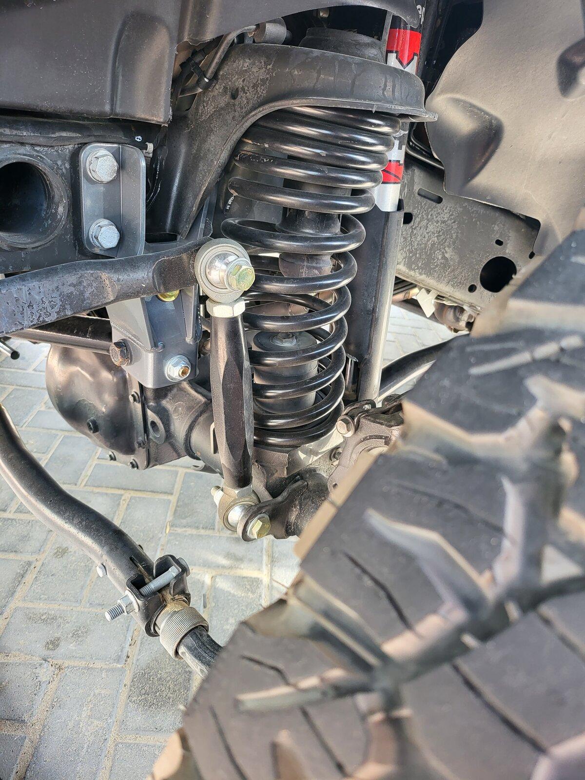

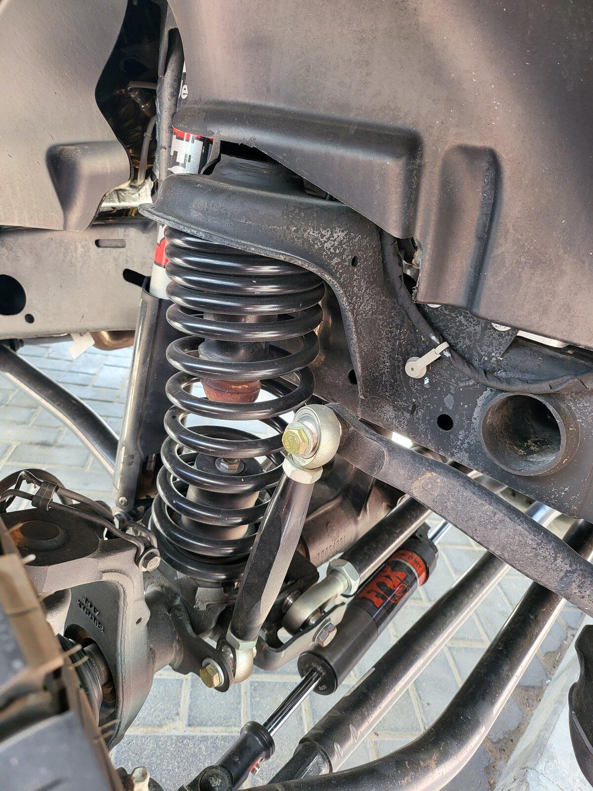

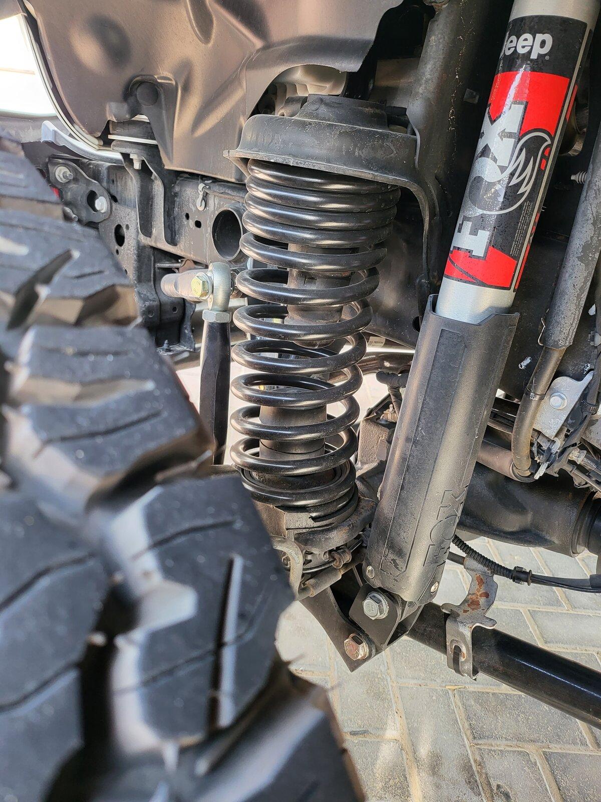

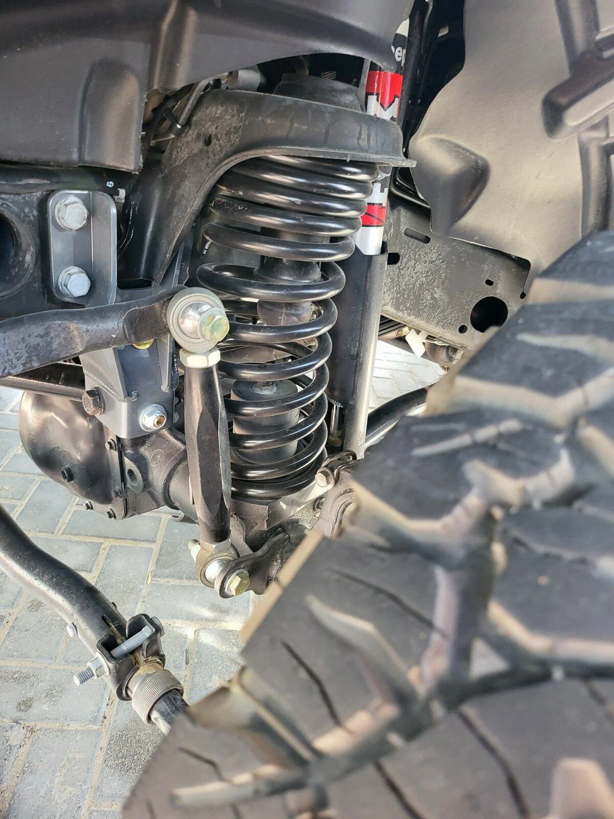

Hope you can help me with a Technical issues I am now facing with the kit.
I noticed my front coil spring bow forward, what would be the cause and the solution?
Pictures 📸 attached

could be a handful of things, do you have a printout from the alignment rack? Have you double checked that both of the rubber nipples on the top coil isolator are sticking through the mount? I can see one of the nipples in the photos but I can't see the other.
On another note, the brake line brackets that you have ziptied on your lower control arms should be removed entirely from the brake line.
Ill get some better pictures from the top and will remove the brake line bracket.

I can confirm both of the rubber nipples on the top coil isolator are sticking through both sides passenger and driver.
Gotcha, so check caster and see where that's at. Low caster numbers will drive the springs forward like that and in taking a 2nd look at the photos, it looks like thats going to be your answer.
Ok ill get that looked and then report back. I thought maybe I needed to purchase correction coil pads but I noticed I had them already provided In my RK Pro complete kit.
Yup, they're already there and positioned correctly.
