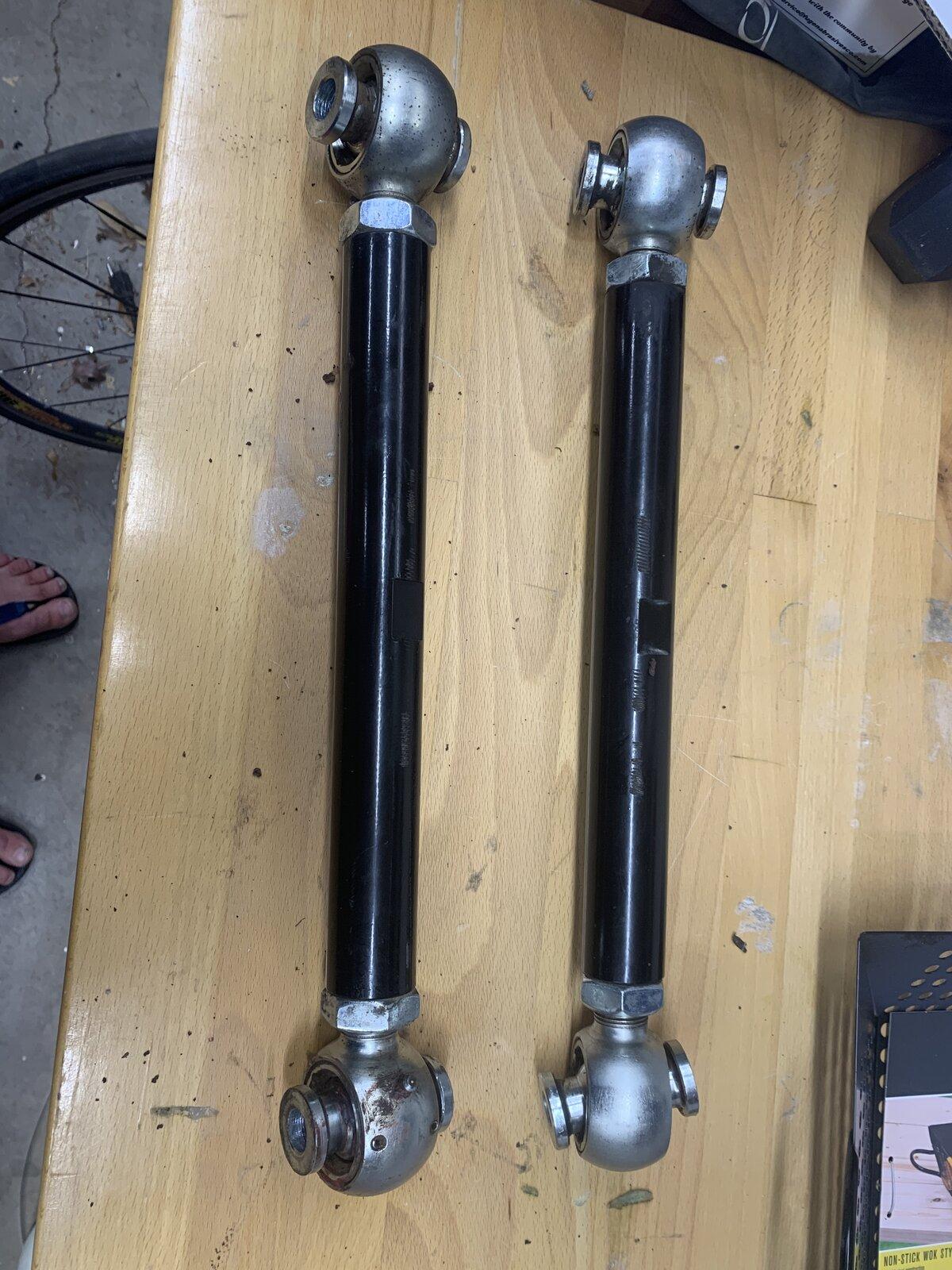

FYI I have JT rear lower arms for sale since I upgraded to 4 link. See classified for more info.
Jeep Gladiator Rock Krawler 3" X Factor JT System 33C8CF11-AACE-4453-8CF9-E0A6BD0B0B58
