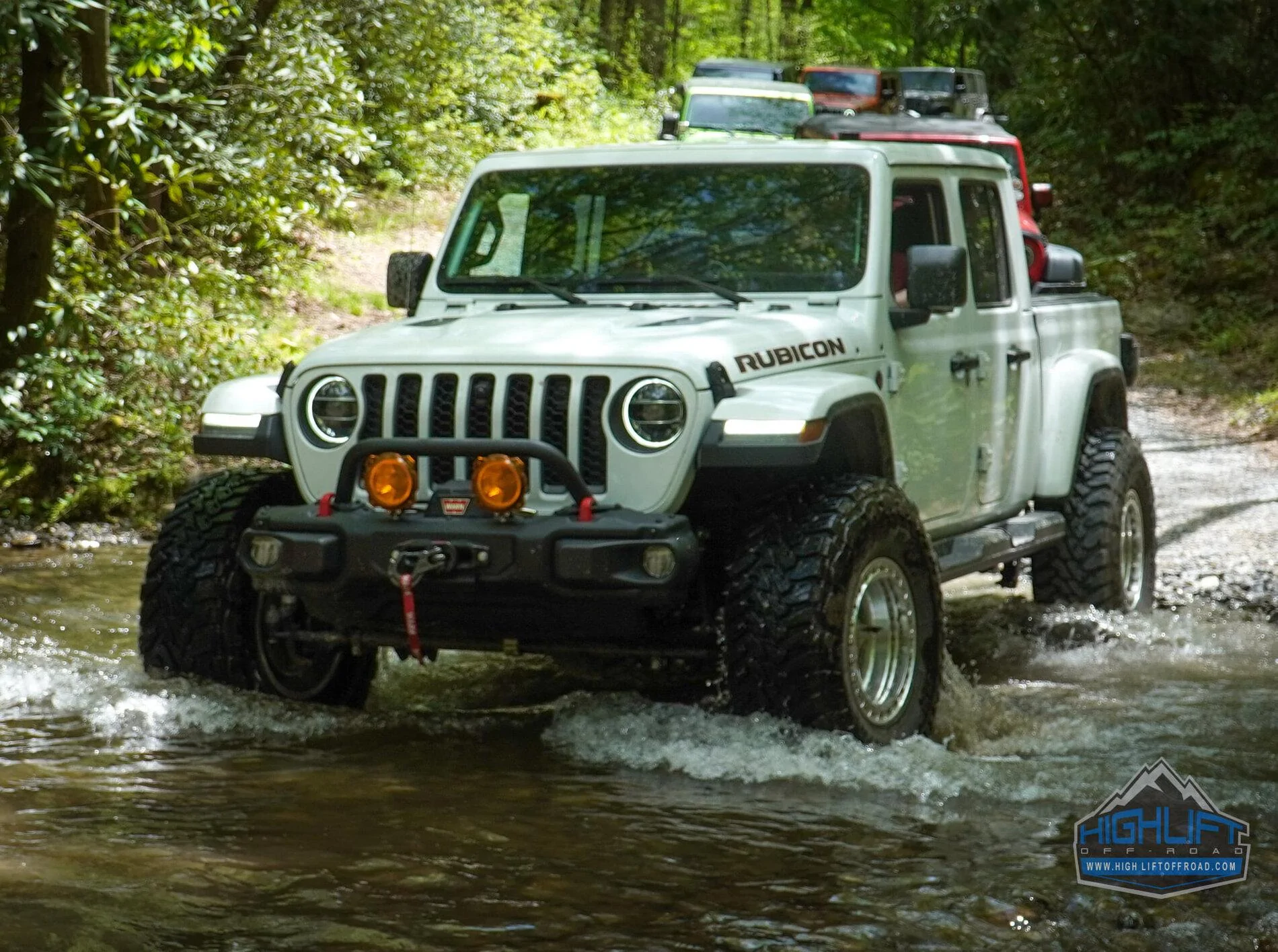

So just curious I have the 3.0 Stage 1 Pro-X No Limits with the 2.25 RRD Shocks.
Most of the time on the road or slow speed off road it is great and the manners around turns feel good. When driving on rougher roads at like 10~20 mph if you go into a dip or hit a bump it is super jarring like you are slamming the bump stops. Could just be the nature of a softer shock, and not seeing anything else hitting or rubbing.
Right now I do have some Falcon 3.3s on order to help with dampening but curious of any other thoughts since those will be awhile and would prefer that money went to axle shafts or the like than buying new shocks but it could just be a preference that they are too soft for me.
The rest is amazing so no regrets at all just curious what others have seen.
