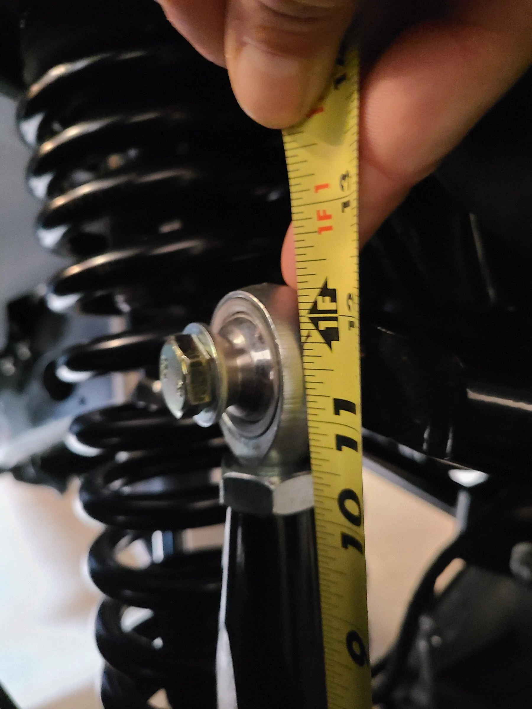

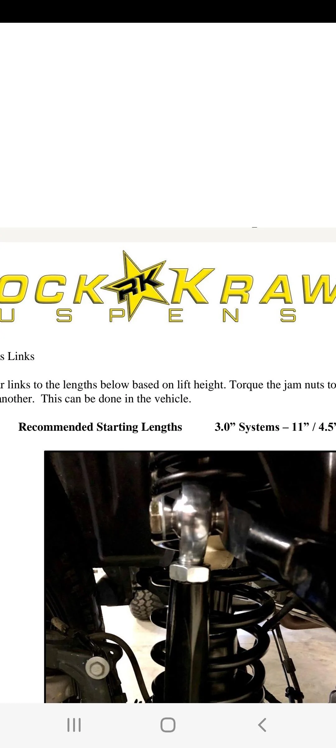

I installed my 3 inch X-Factor lift on my JTRD last weekend and came across that the "No Limit" links in the front would only go to 11 3/4 center to center when bottomed out vs the directions stating 11 inches. I know I ran across someone in this thread that had also posted the same question but I could not for the life of me find it. Anyone had this same issue or question? What did you end up setting the no limits links to? Did I miss an installation manual update?

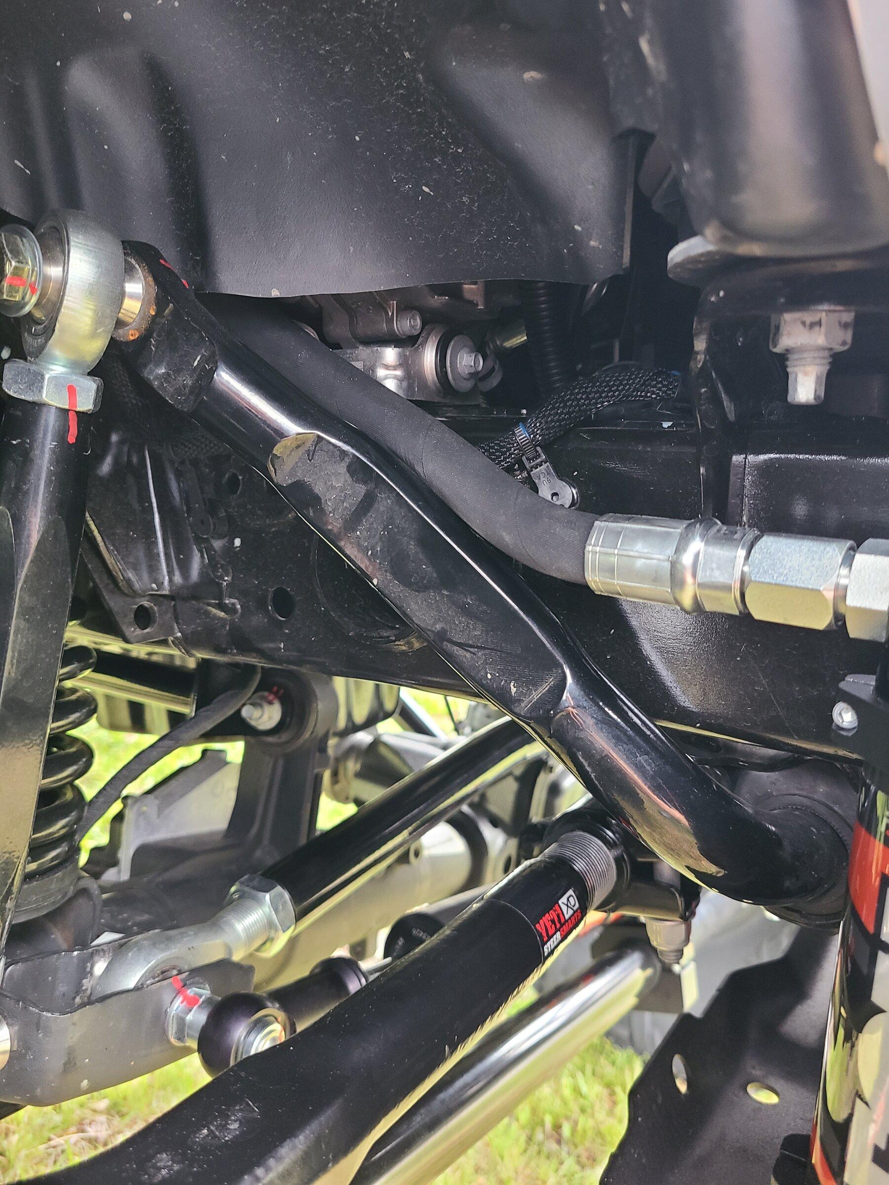

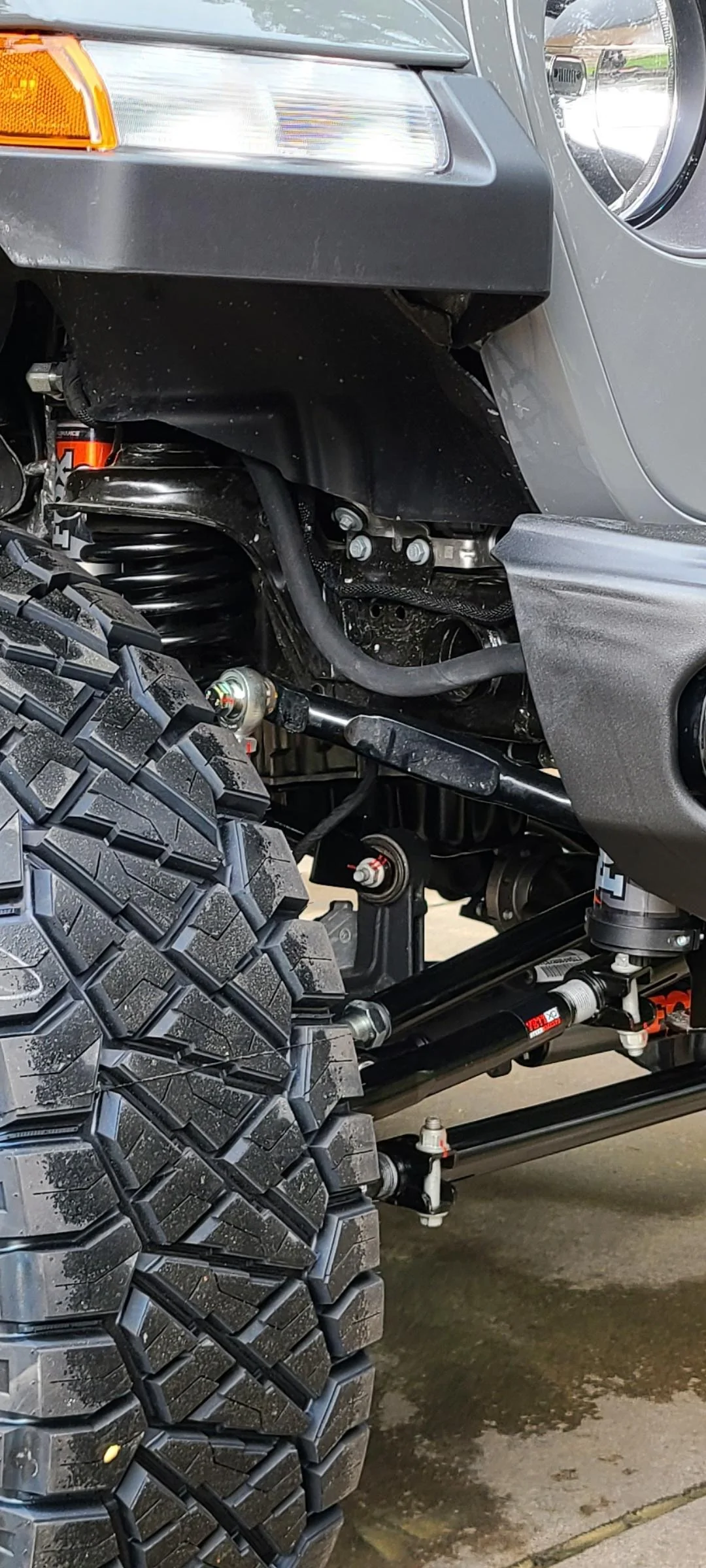

Adding onto my questions above. I tried to get this answered through RK but didn't get a straight clear answer. Got the Jeep out and tried to get it to limit out so I could check all of the clearances and bump stops etc. The only issue I see is the front "No Limit sway bar links" are pushing up into the Fox 2.5 resi hose in the front and almost pinching it. I will need to make a bracket to hold hose out of the way and trim some of the fender liner to feel good about it. This brought me back to my question above that I never got clarity on? Are the "No Limit" links to long?? They get a ways up there when you get the front almost fully compressed with the sway bar disconnected. @Rock Krawler Suspension

Is the sway bar horizontal while sitting on level ground ?
Here is a photo of it sitting in my driveway. It looks like it is definitely not horizontal.
With the "no limits" link that I was sent it is as short as it can be. There wouldn't be a way to get it to adjust down to horizontal.
You can see the reservoir hose in that photo as well and how much the sway bar pushes it up.

Looks like the links are to long, should be horizontal to the ground

They actually look fine to me. Obviously you don’t want them to rub your reservoir hose so you would need to fix that by maybe getting a tighter fit to the frame, run it higher or just reroute it.
The sway bar doesn’t have to be exactly level to the ground. It’s fine if it has an upward angle. At full flex you don’t want it to lockout straight with a chance for it to flip the other direction.

This. If it is flat, and you flex ou you run a high risk of flipping the sway bar and let me tell you, that will be a mean lesson learned.
