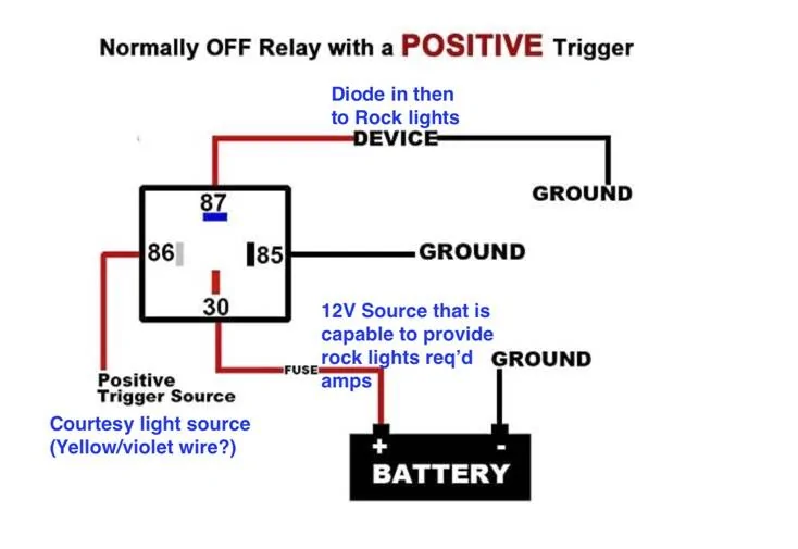

Once the courtesy light wire input is verified and it is only 6v at key fob unlock, then here would be a diagram for incorporating a relay. Since you have the Aux switch option there is a 10 amp 12V source under the glove box. Check your owner's manual.
Any reason not to put the diode and switch on the line feeding into pin 86? That will reduce the power going through the switch as well.
