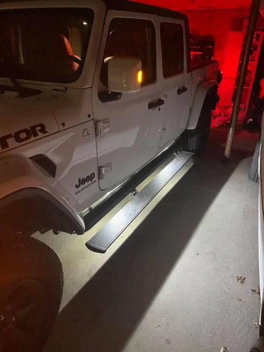

I actually used these for my side step lights. AMP has a blueish/purple look I didn't like. They are used (quick on/off) every day and i've been using them for about 2 months. Theyve been great and I doubt you will use rock lights daily.

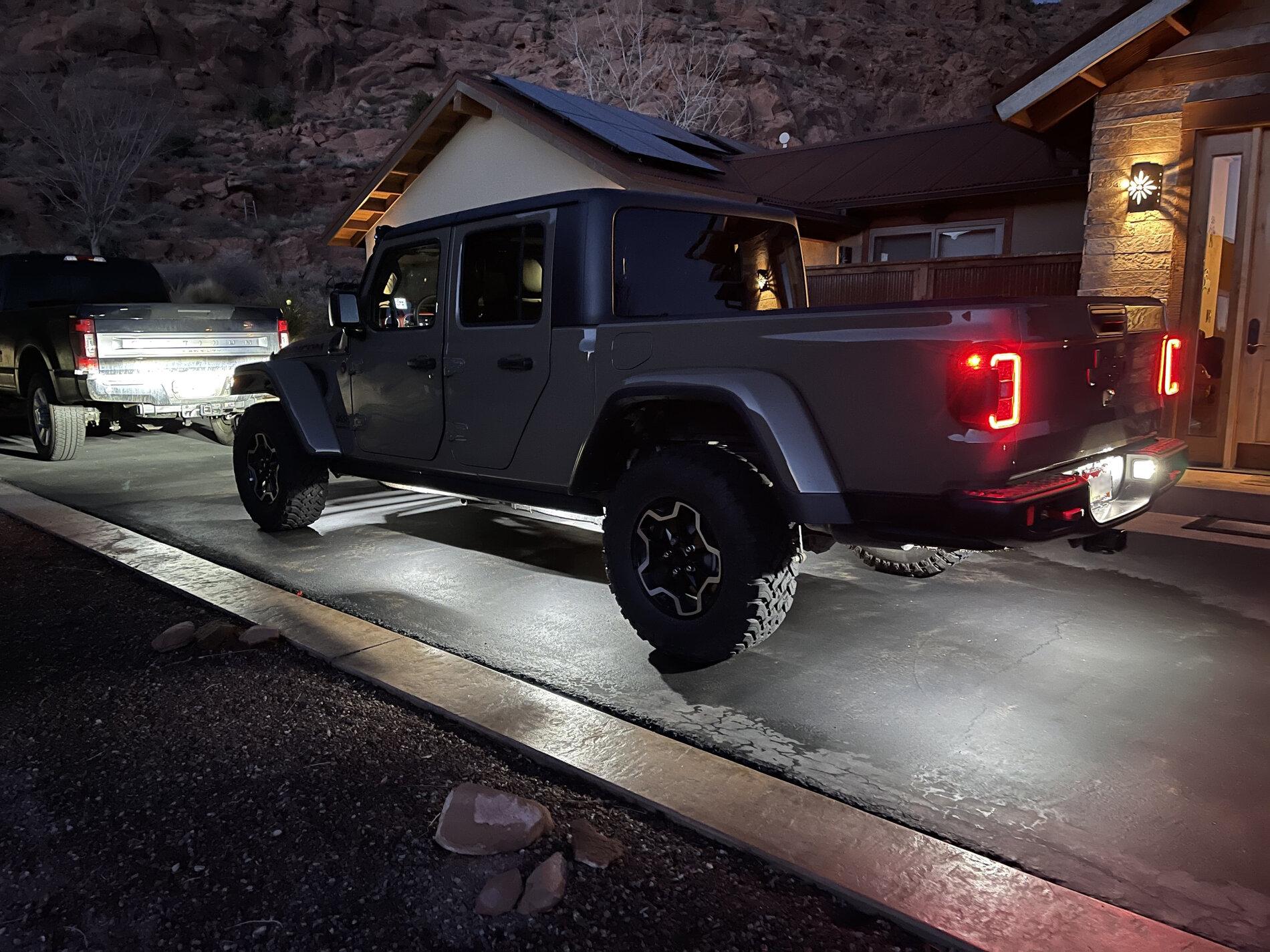

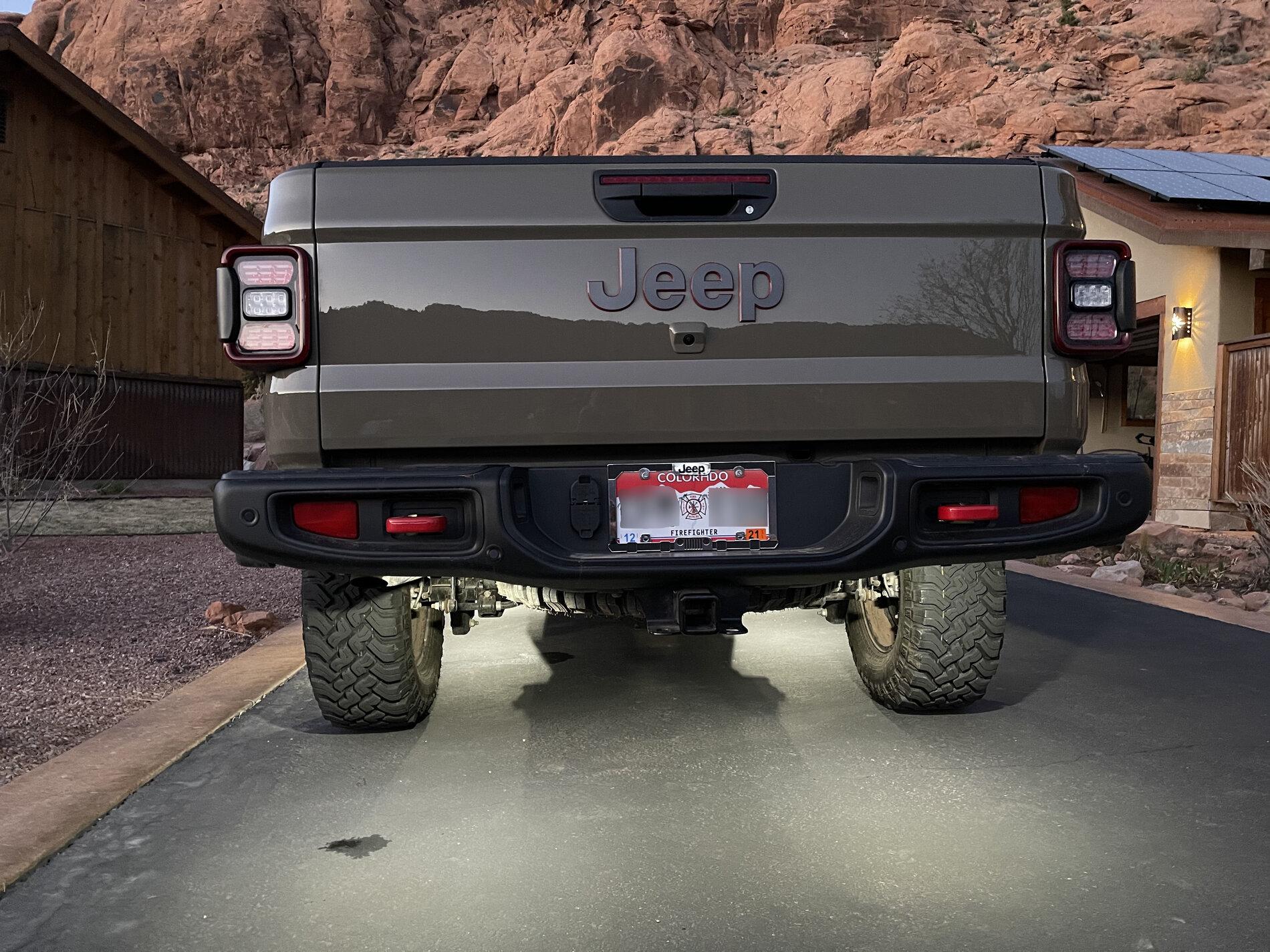

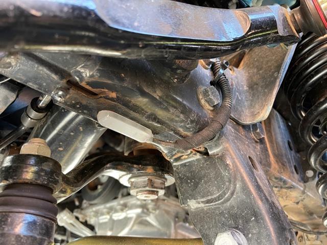

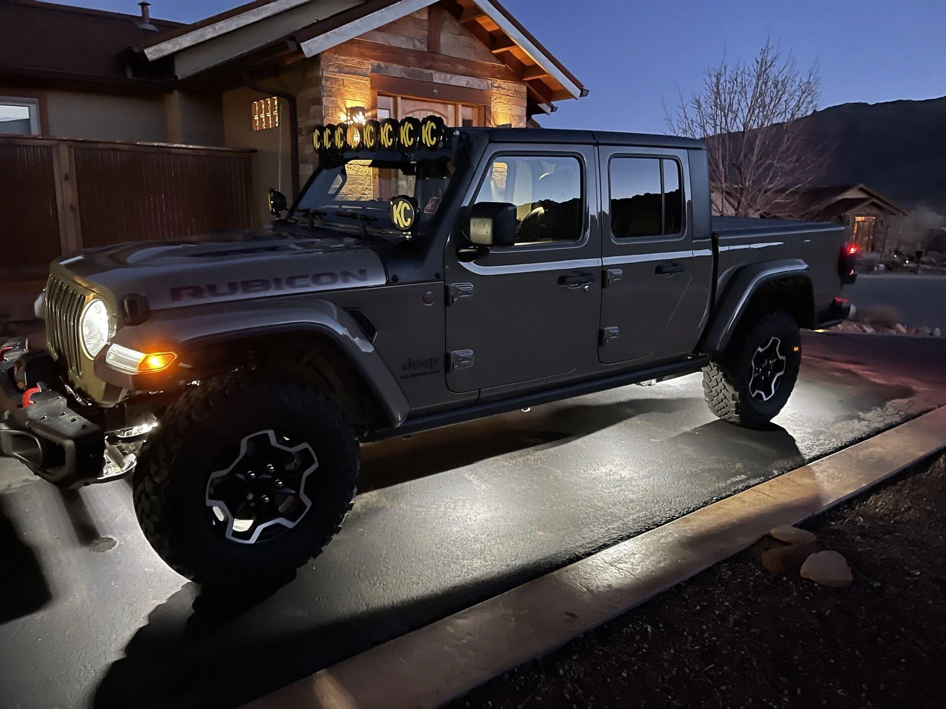

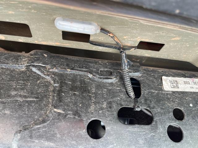

Just a quick update... weather got nice enough to get these installed. Finding places to install it was a bit challenging in order to keep away from the exhaust (heat). The best way I found to route the cables was through the frame. That made it clean. The folks from Dixie 4 Wheel in Moab said to do something like that as they get annoyed about having to remove and move rock lights when they install lifts. They said the frame was a good way to go. Using an electrician's fish tape made this dead simple. If anyone wants to see my mounting locations, I am happy to share it. In any case, here is the finished product...

  • The rear 2 are just in front of the hitch frame. There are 2 nice holes in the frame right near them where you can fish the wire through the frame.
  • The next rear two are right below the rear doors on a black metal pad, just in front of the rear tires. Again, a nearby hole in the frame is accessible for route the wires.

  • The front was the interesting location. They are on the frame near the pitman arm. You need to be careful because that is a moving part. You will be sure to use several zip ties to keep this in place.

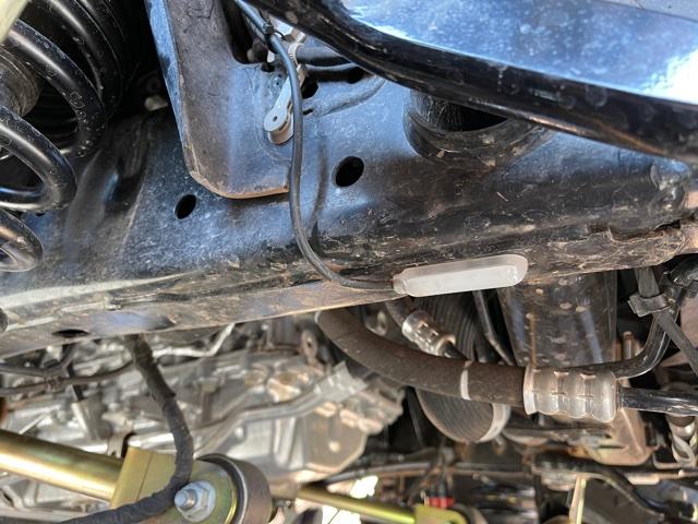

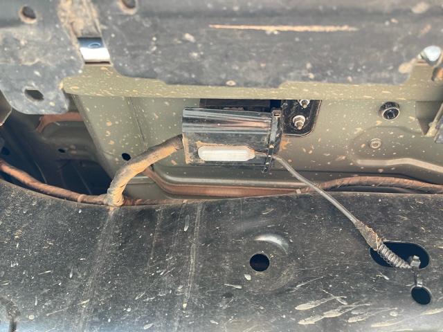

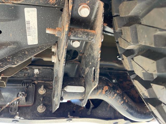

Sorry for the delay, I just remembered to get these. The following pics should show the locations. I will show the passenger side as the driver is identical. But I will show passenger and driver front. All routing was done through the frame using fish tape.
Rear Passenger:
Jeep Gladiator Lux Lights for Rock Lights? image7
Passenger rear door (below):
Jeep Gladiator Lux Lights for Rock Lights? image6
Passenger front door:
Jeep Gladiator Lux Lights for Rock Lights? IMG_4515
Passenger front engine frame:
Jeep Gladiator Lux Lights for Rock Lights? IMG_4516
Driver front engine frame:
Jeep Gladiator Lux Lights for Rock Lights? IMG_4517
