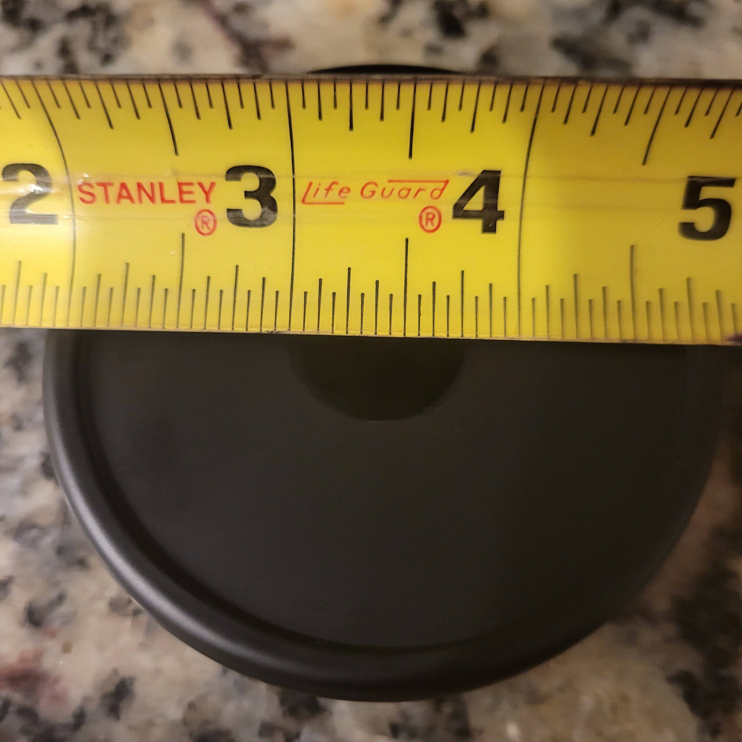

Took some measurements when I got home. Center cap hole is just over 3/4".
Jeep Gladiator Rock Trix Custom Jeep Center Caps 1000005208
I will need to bore out to 2 1/4", so I think I'm going to try the conical step bit and if I screw up the first one, I got another 4 to work with. Ordering the bit @WILDHOBO referred me to. More to come once that arrives. Thanks everyone for the suggestions!

Good luck. You should video the drill press action. Everyone loves a nice part flying across the room. :). In all seriousness, maybe make a similar piece out of wood with the same 3/4” hole and test run it with a 2 1/4” circle drawn onto the test piece.

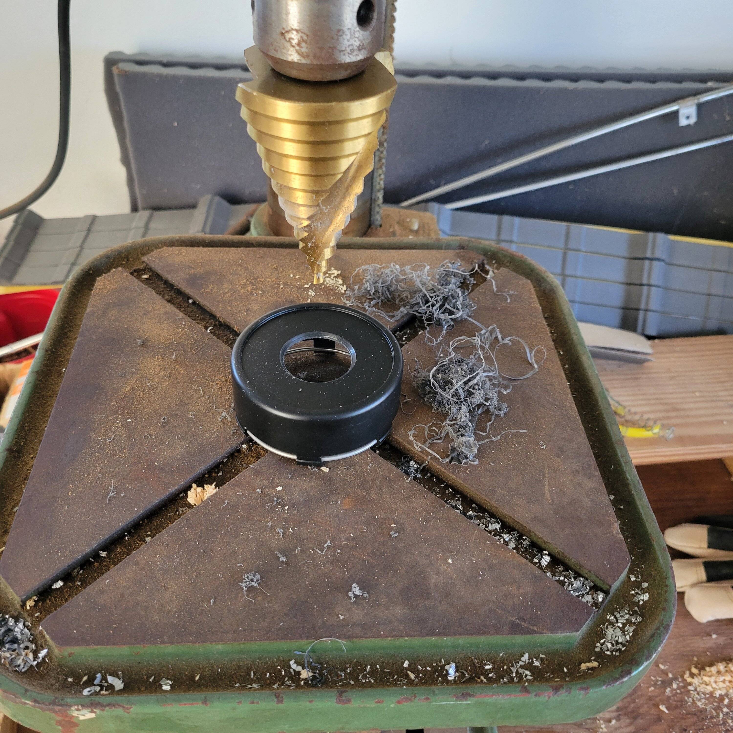

Well, I got the bit Saturday and decided to get started on reaming the center caps. And I luckily did find my chuck key!
I put it on my lowest belt drive (240 rpms) and slowly made progress. My clamp for the press is currently holding another project together, so I couldn't use it. I just put on leather gloves and held it as steady as I could (yes, I know; off my a$$). Surprisingly, the bit self-centers quite well; mic-ing all the way around has shown it's staying within 0.01" from center.
Jeep Gladiator Rock Trix Custom Jeep Center Caps 1000005224
But unfortunately, I've got just far enough today to realize another problem....
My table won't allow enough depth with the diameter of the conical bit. So, I'm going have to devise a base with at least a 2" hole in the center to allow more material to be removed.

2x4's under the center cap.
Exactly. I had to use one of my step bits to drill some plastic recently. I had the same problem. I just clamped wood underneath. It worked great. No need to have a hole. The bit will just continue through.
