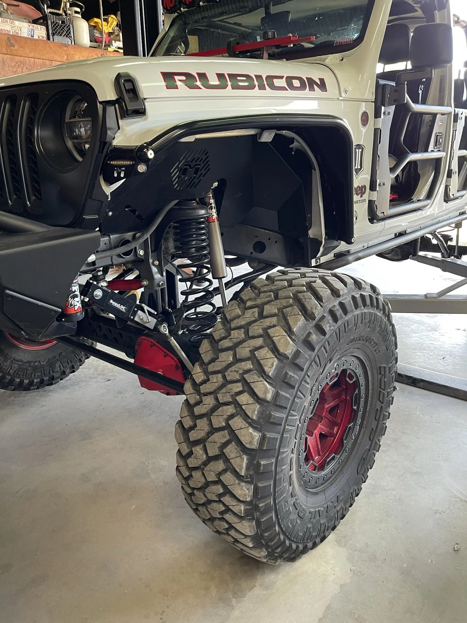

Congrats on the lift. I installed mine a couple weeks ago. I installed fox 13" stroke shocks. They seem to flex out perfect. I will know more after next weekend.

I bet that is a good fit. I am currently running the RK RRD shocks with a little over 11" of travel and there is plenty of room for more. What is your collapsed length on the Fox shocks?

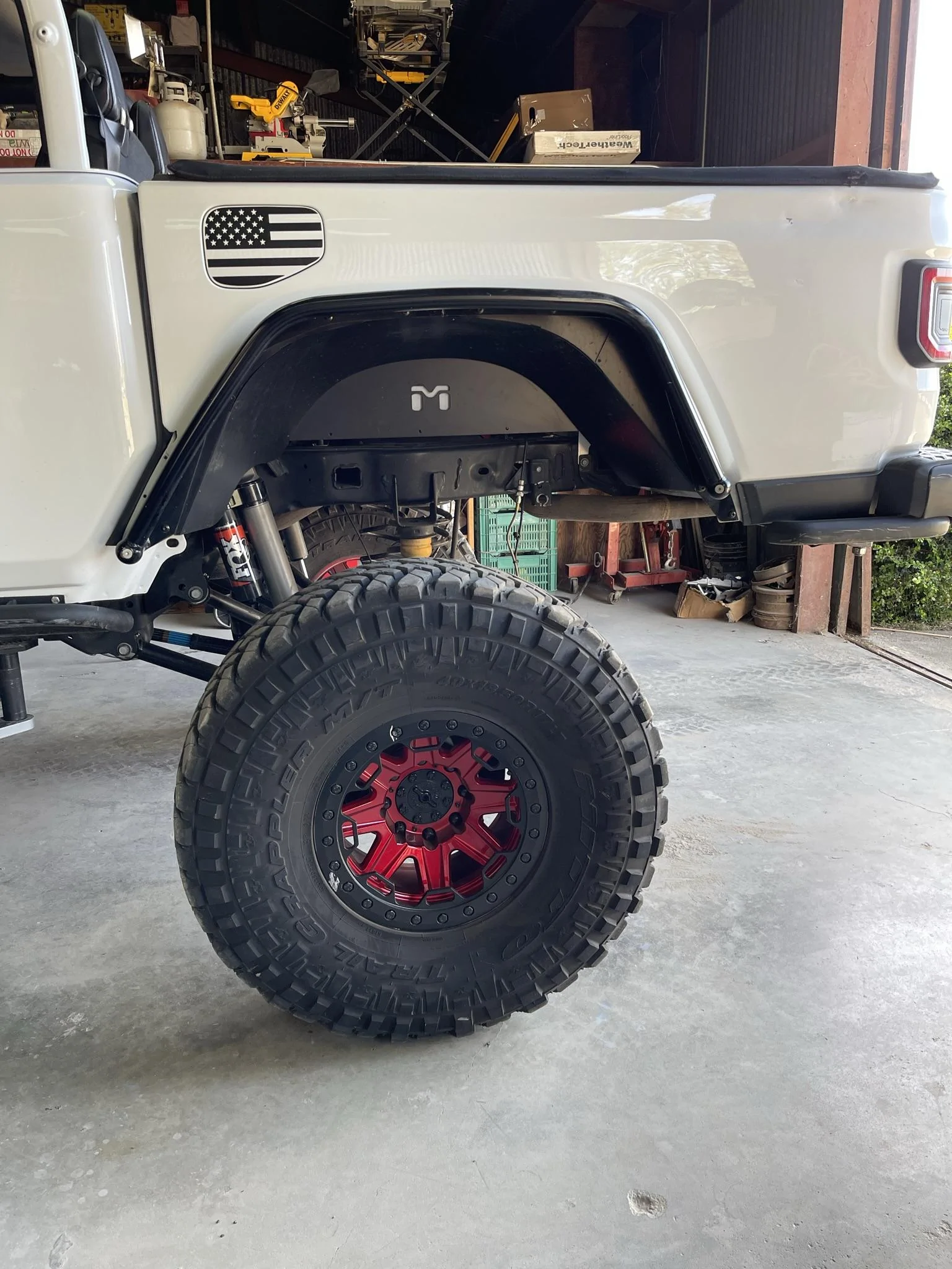

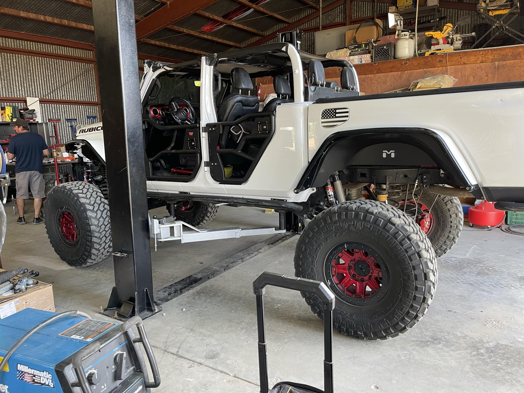

Ill have to measure them. I tried flexing my truck out this weekend but it flexes out so much that the the stretched side spring falls out. Here it is at almost full droop on my car lift. The rear still had 2-3/4" to go down. I may try to fab an upper mount that lets the shock fit higher up. I could not lift it off of the ground completely due to my rear brake lines and abs wires being too short. keep in mind that these brake lines are custom length and about 2" longer than aftermarket extended lines.
Following. Looking great! Was that a rear spring that popped out? Curious what height lift you guys have and what your plans are for the rear swaybar? Are you thinking limit straps to keep the spring in place on full droop?

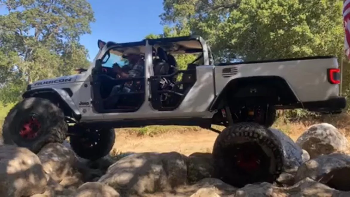

Yes, Its the rear springs that fall out. I plan on making something to hold the spring in place top and bottom. The photo is from a video. Its not very clear but gives you an idea of how much flex im getting.
