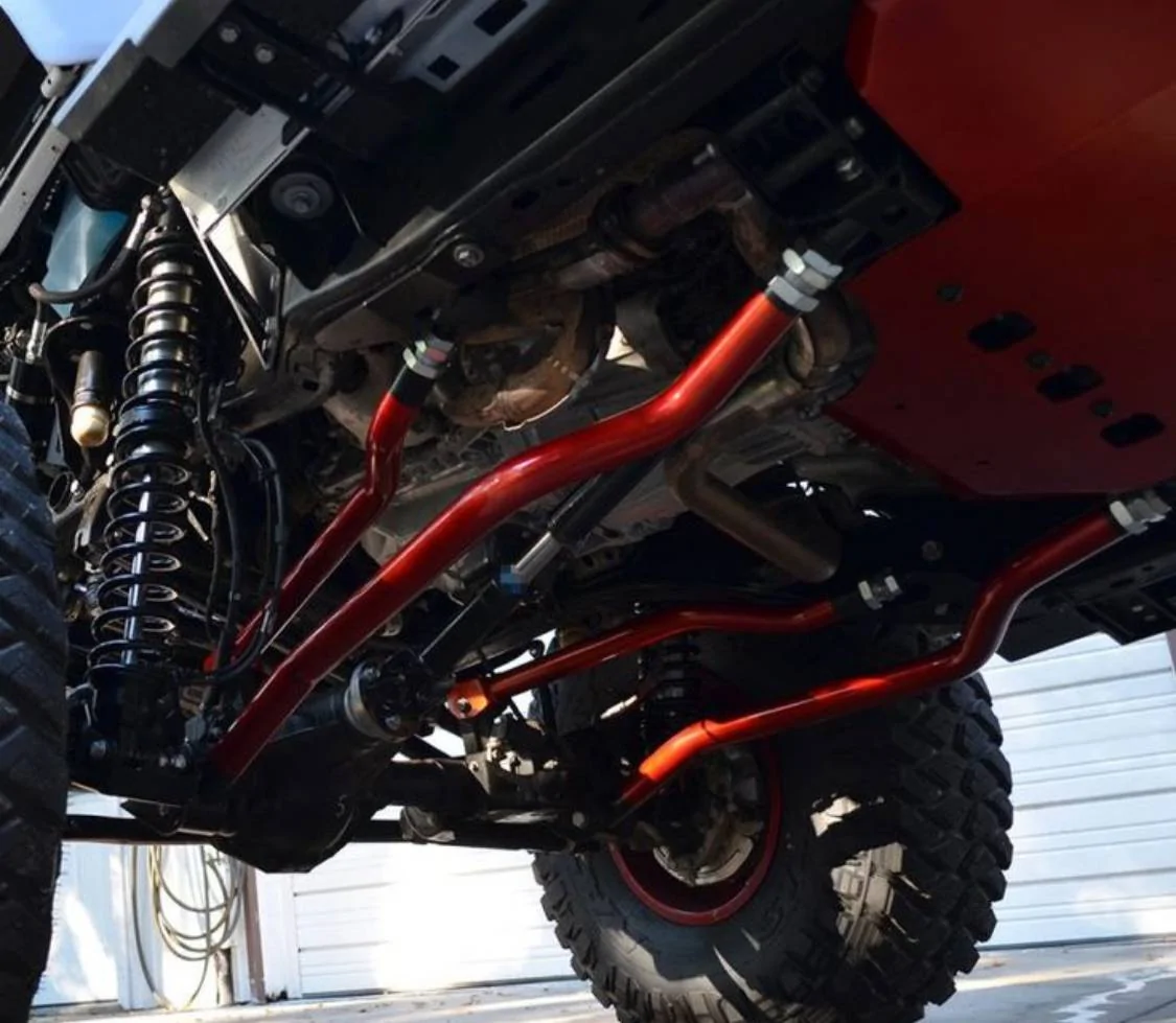

This isn’t necessarily true. The evo kit relocates the mounts along the sides of the frame rail and has a bend in the arm… literally gaining frame clearance.
Any pics of it installed from a side perspective on flat ground that show the arms? I looked a little and couldn't find any.

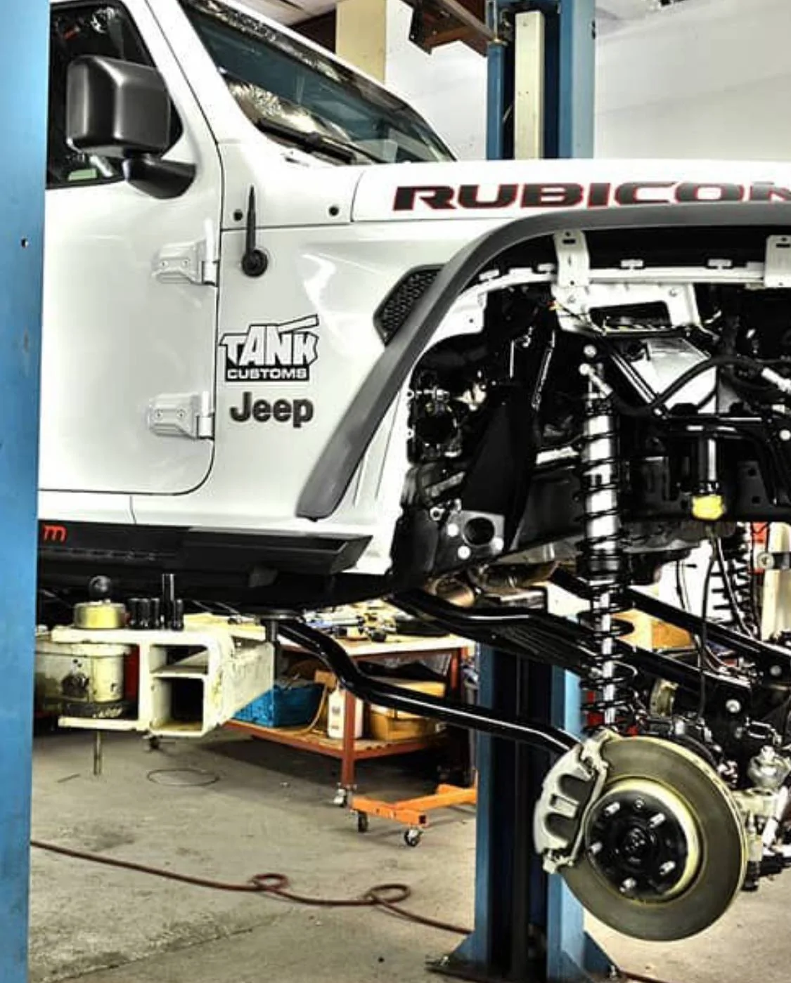

The clearance there is impressive! I’ll have to retract what I said earlier about loss of clearance.
My only gripes would be running a bushing at one end to keep the arm from flopping over and the strength loss from running a bent arm.

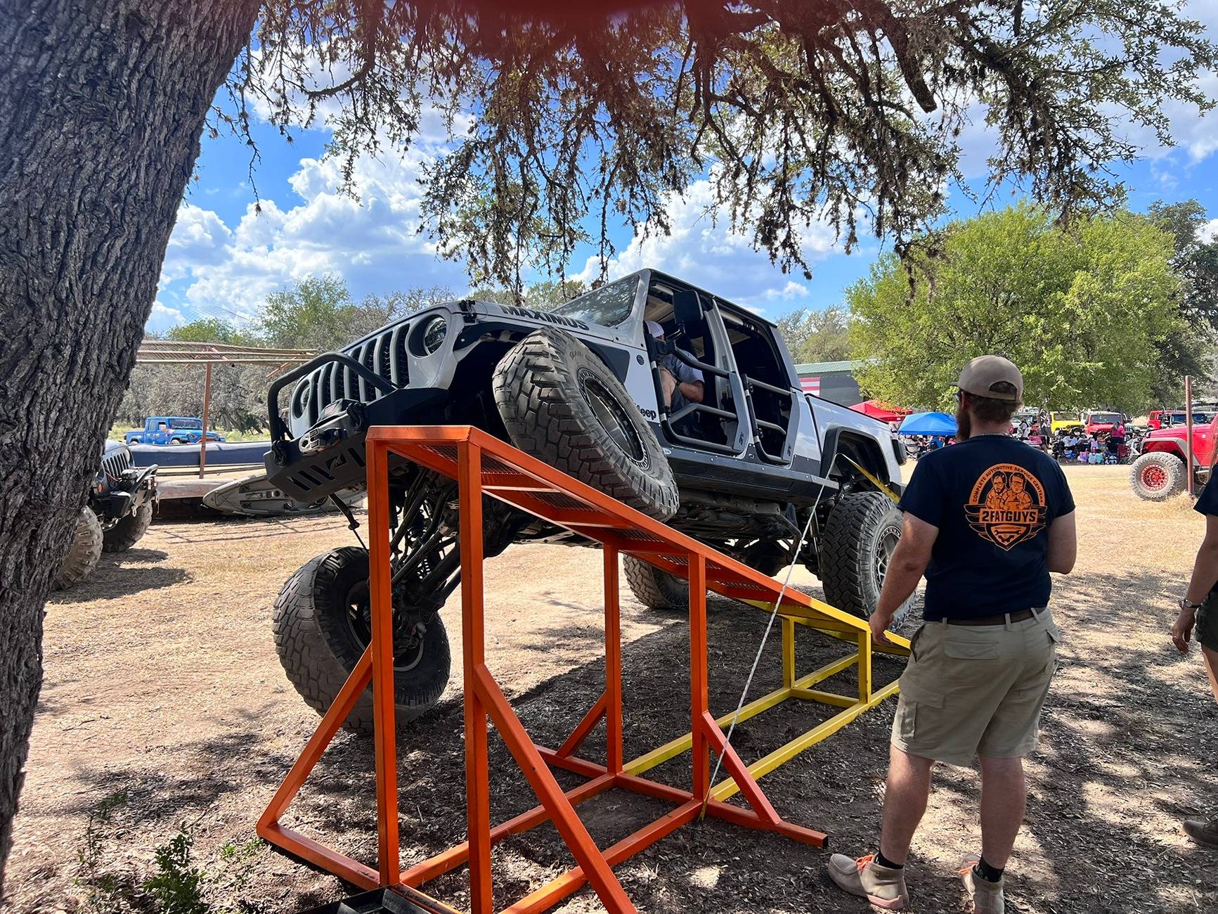

So, Mel and his Daughter race their gladiator with this setup up front and trailing arm rear. I mean, things can break- and things Definitely break when you are racing… I just don’t think I’ll be going that hard with the gladiator/jeep… side by side ? sure! Jeep nah.
