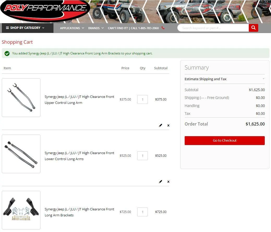

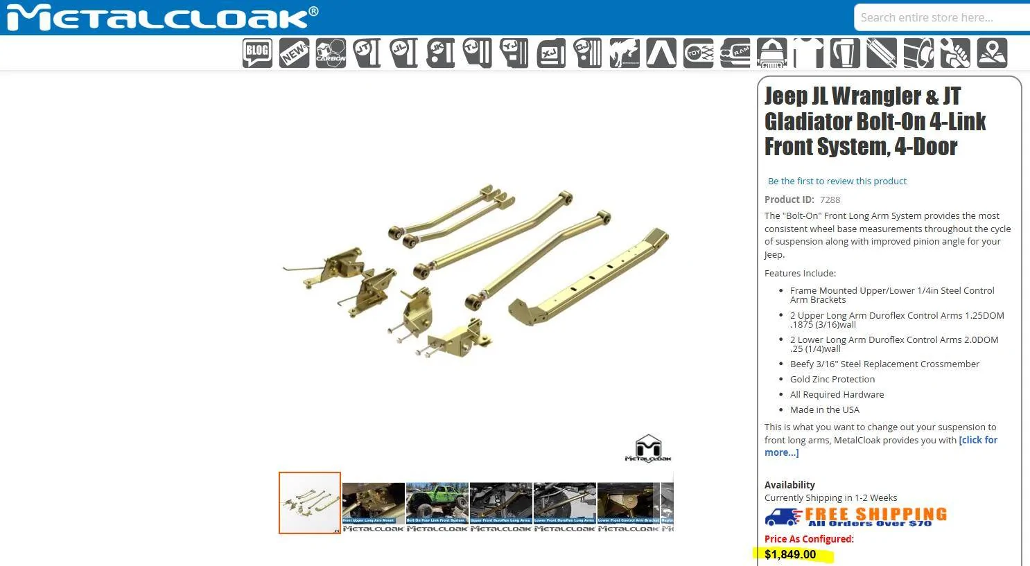

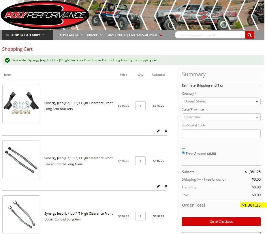

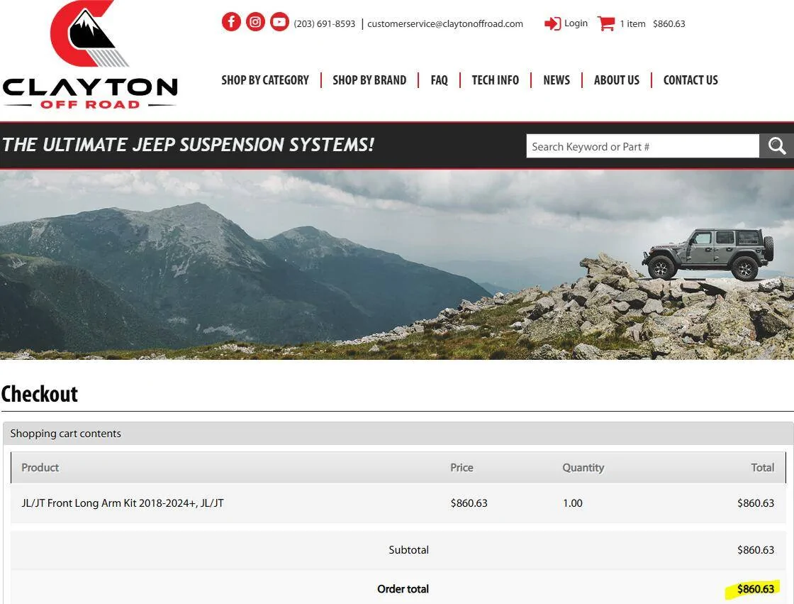

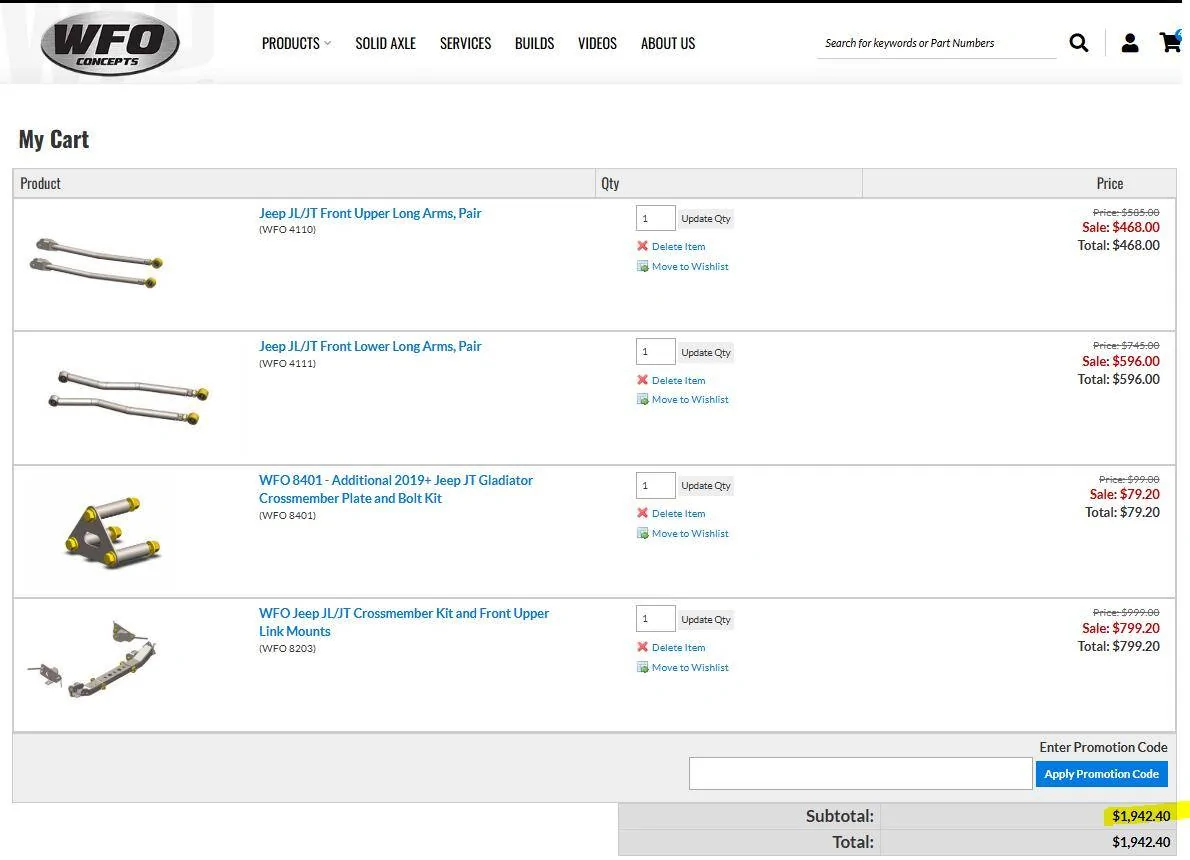

Curious if anyone is pulling the trigger on the Synergy Front Long Arm Kit this Black Friday (or any other discounted long arm kits)? Really tempted for the price. Compared to WFO and even the new Clayton long arm kit, the Synergy lower long arms seem to be about 3in shorter than the others and don't tie into the crossmember for strength. I know Clayton doesn't use the crossmember, but their weld-on brackets are moved back closer to it than the Synergy brackets. Curious to get other's thoughts.
Synergy is free shipping:
Jeep Gladiator Long Arm Brand Selection 1732212397373-08
WFO: shipping ~$250 additional
Jeep Gladiator Long Arm Brand Selection 1732212649955-4o
Clayton is free shipping:
Jeep Gladiator Long Arm Brand Selection 1732212802027-gk
Clayton is in a little different category as their long arm upgrade kit is a radius arm long arm kit. If you have a clayton kit already you can reuse the front upper control arms, they are relocated to a bracket on the extended lower control arm. I don't know a lot about radius arm kits but I have read about their tendency to have more significant caster angels during articulation.
Correct, and apologies I didn't clarify that in my post. I guess I should have used Metal Cloak's true 4 link long arm as another example. They too utilize a new cross member for their bolt on kit. Personally I just can't get on board with the gold color of their stuff.
