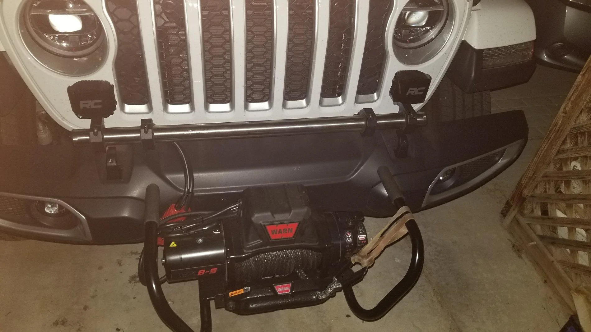

I created a light bar above the bumper using the Mopar light mounts that attach to the frame. It wasn't my original plan, but the bumper was in the way and the lights wouldn't attach to the mounts.

That looks great....not sure what you mean by the mopar light mounts...care to explain alittle more to a newbie

They are available from a lot of places, I bought a set off Ebay - Mopar Part # 82215428.
https://www.ebay.com/itm/2018-2019-Jeep-Wrangler-JL-Bumper-Mount-Light-Bracket-New-Mopar-OEM/283552298109?ssPageName=STRK:MEBIDX:IT&_trksid=p2057872.m2749.l2649
They are angle brackets that bolt to the frame just behind the bumper. It provides two brackets to mount lights on. There's a rise in the bumper just in front of the bolt hole in the bracket. The mount on the lights I bought isn't tall enough to clear the rise in the bumper. I got some stainless steel hardware from Home Depot to mount the bar. I used a 1.5 inch long 3/8 inch bolt with two nuts between the bracket and bar mount to get the space needed to clear the rise in the bumper.
Instead of getting longer bolts and spacers just for the lights, I got a stainless steel tube and some bar mounts. I attached one set to the brackets to hold the tube, and used another set to mount the lights. I was going to paint the bar flat black, but decided not to after setting it in place and looking at the color contrast. I did get some black plugs that pushed into the ends of the tube. I ordered another set of lights to put out on each end of the bar, and am debating a 20" light bar to go in the center.
This is the steel tube. I bought a Used-Like New for $24. There were no issues with it. I went with a 3 foot, 1.75 inch O.D. The space will accommodate a bar up to 4 feet, and the mounts will work will multiple O.D. sizes.
https://smile.amazon.com/gp/product/B004TUEF5I/ref=ppx_yo_dt_b_asin_title_o07_s02?ie=UTF8&psc=1
These are the plugs I put in the end of the tube. https://smile.amazon.com/gp/product/B06XK4FY1Z/ref=ppx_yo_dt_b_asin_title_o07_s03?ie=UTF8&psc=1
These are the bar mounts I used. https://smile.amazon.com/gp/product/B0714CYKBJ/ref=ppx_yo_dt_b_asin_title_o07_s00?ie=UTF8&psc=1
These are the lights I put on it. https://www.ebay.com/itm/Rough-Country-Chrome-Series-3-Wide-Angle-OSRAM-LED-Light-Kit-70904/312724441503?ssPageName=STRK:MEBIDX:IT&_trksid=p2057872.m2749.l2649

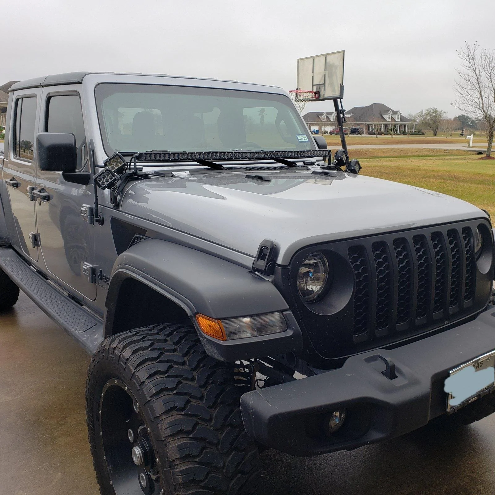

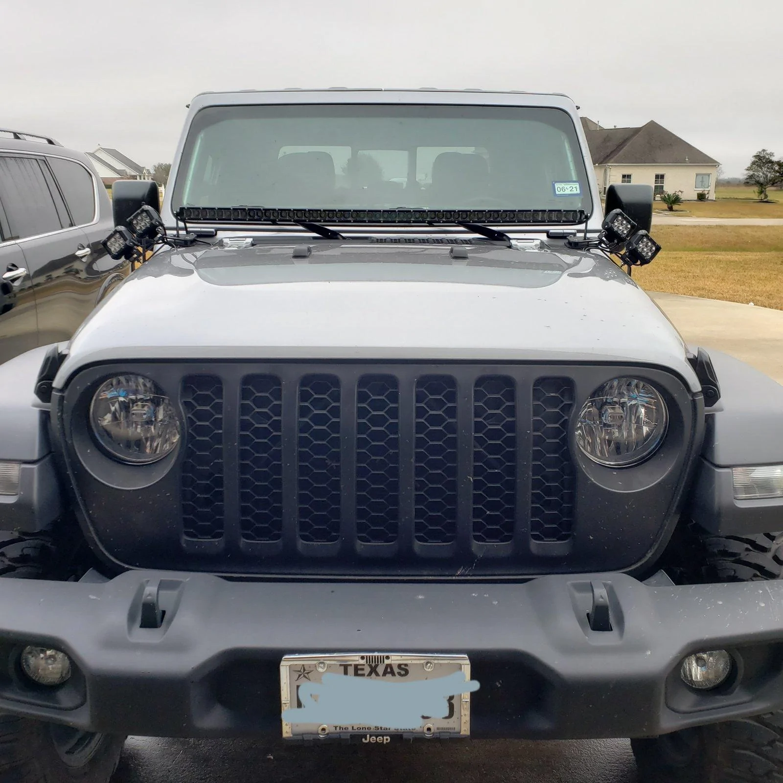

I installed a 50" single row and 4 3" pods and they put up great light. A little glare from the hood but not bad.

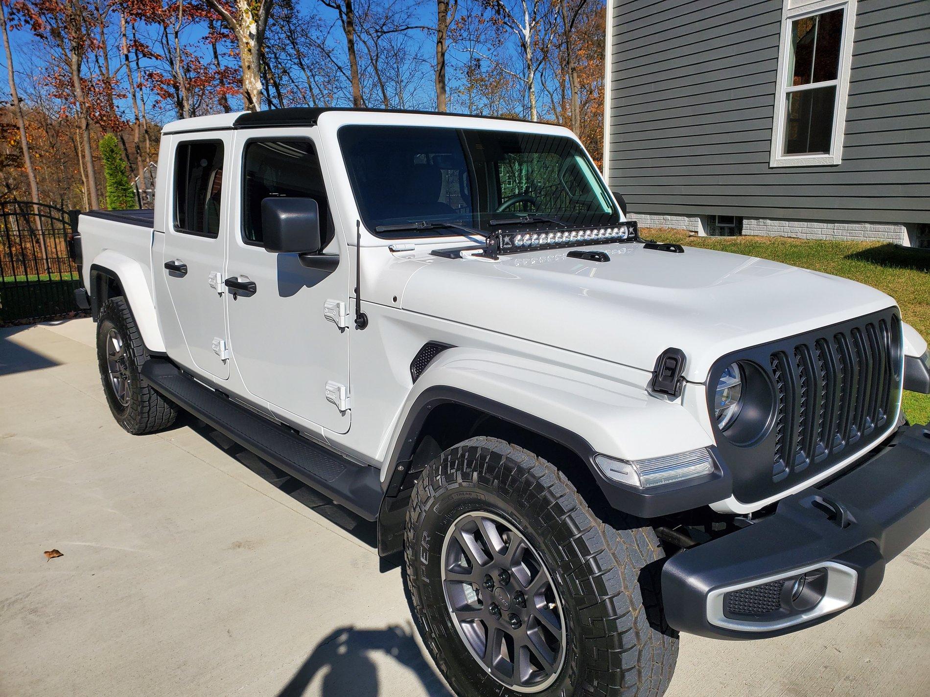

Mine is hood mounted (rigid radiance), and there is no glare off the hood at all. One thing I didn't anticipate is that it blocks washer fluid though. When I eventually get a steel bumper I may mount it there, but I like the way it looks and the back lighting of it is subtle and I can run it on the road.
