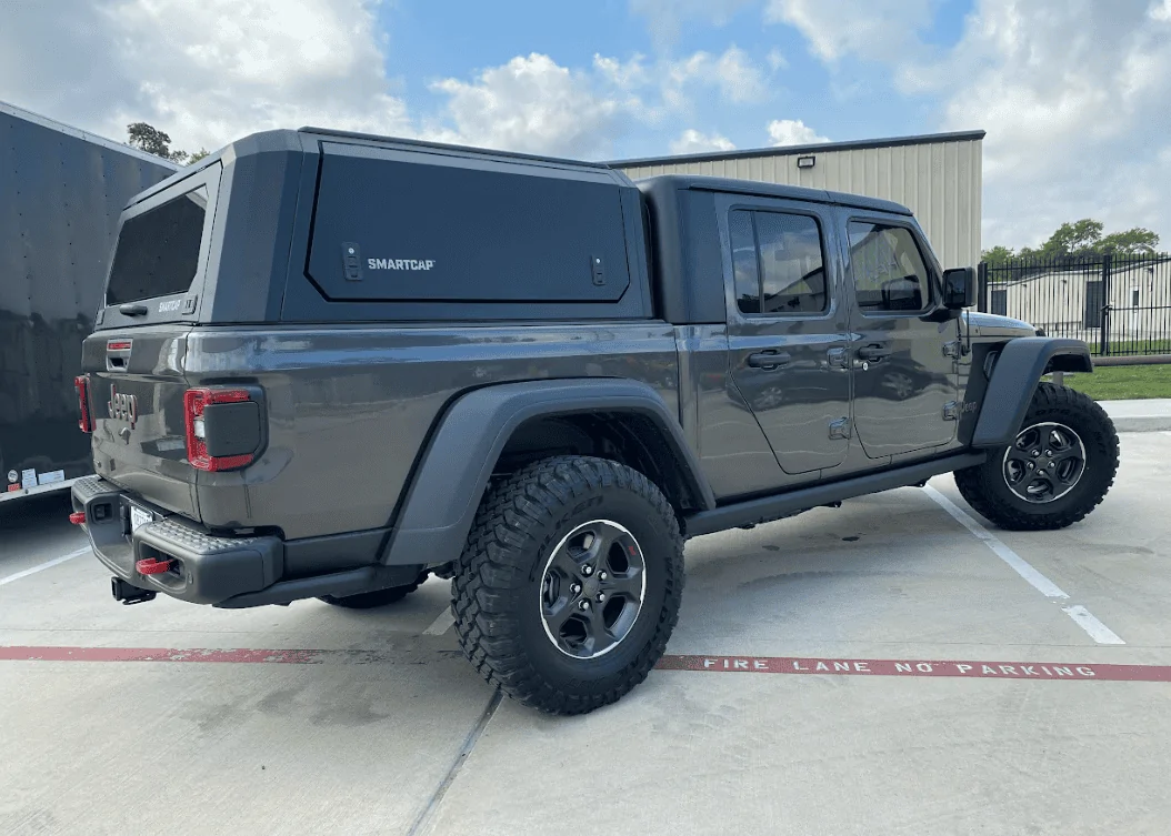

I'd like to allow someone else with the T-slot system to chime in. However, as for the RSI Smartcap installation, it was pretty straightforward and not that difficult as long as you have plenty of hands to help.
Once you put the RSI on, guarantee you’ll love it! It’s extremely useful, and looks sharp! It took me a week or two to get used to, and I don’t regret it one bit!
I've included a couple of pics and some advice I wish I would have known to help explain.

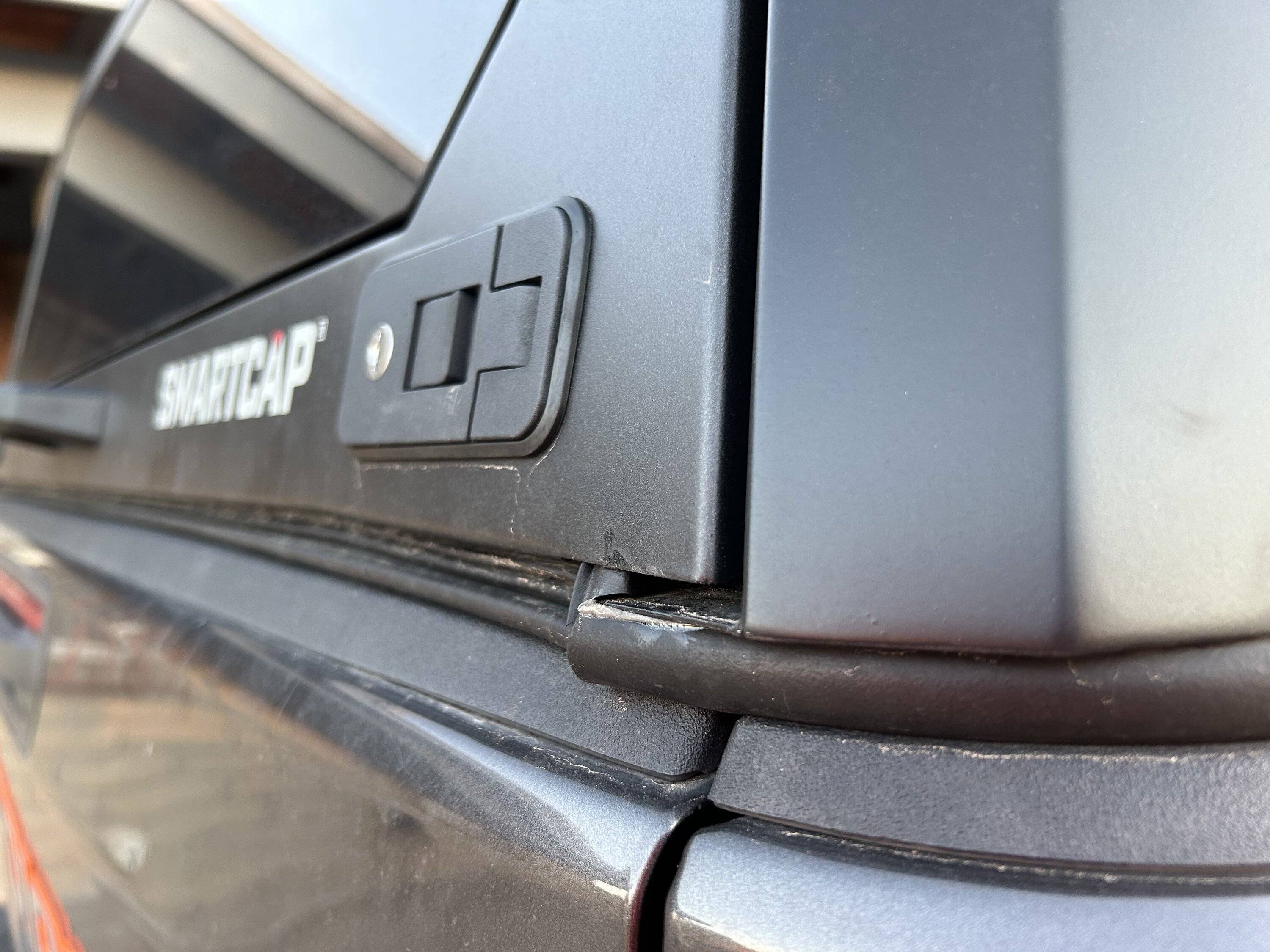

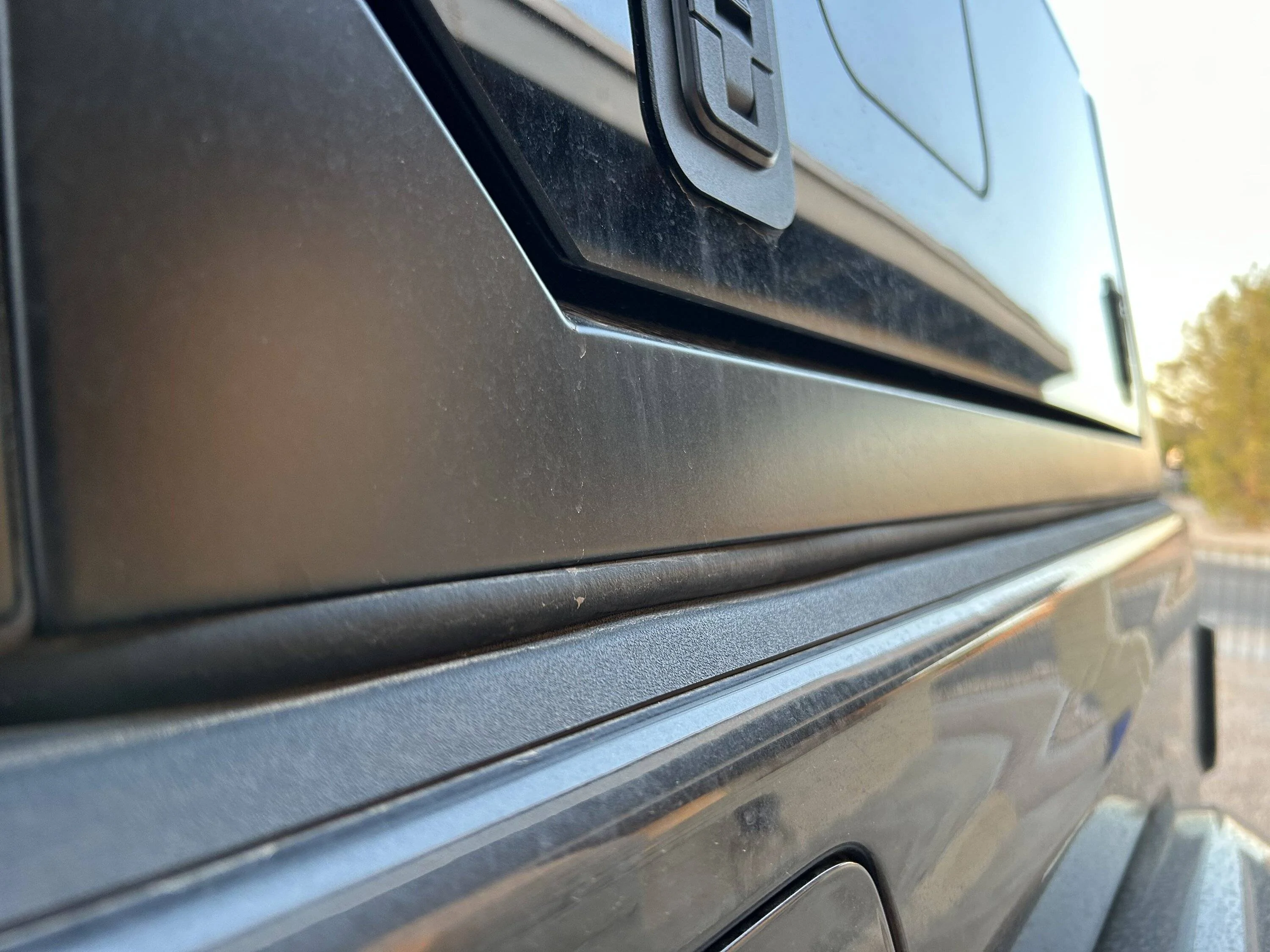

I would assume that you would probably need a new gasket to put under the cap to seal it, to be on the safe side.
The most challenging part (from my experience with the 115, AZ heat) was trying to get this corner of the cap and the gasket to stick. You will see that I tried my best to get this aligned, and for some reason, it was just a pain in the butt. Just take your time.

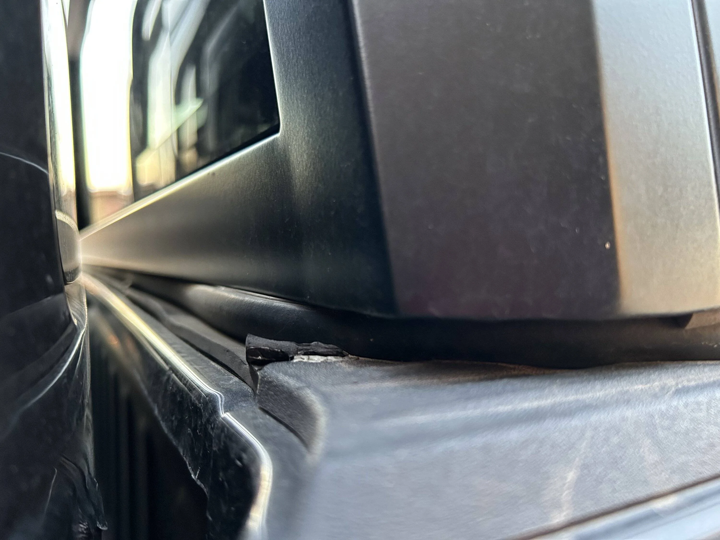

This is all preference, but some individuals install their Smartcaps like this, or put it back towards the rear seats a little bit more, but then you will notice that there is an angle that seeps into the gasket. We just preferred the edge since the water ran off smoothly, and no leaks.

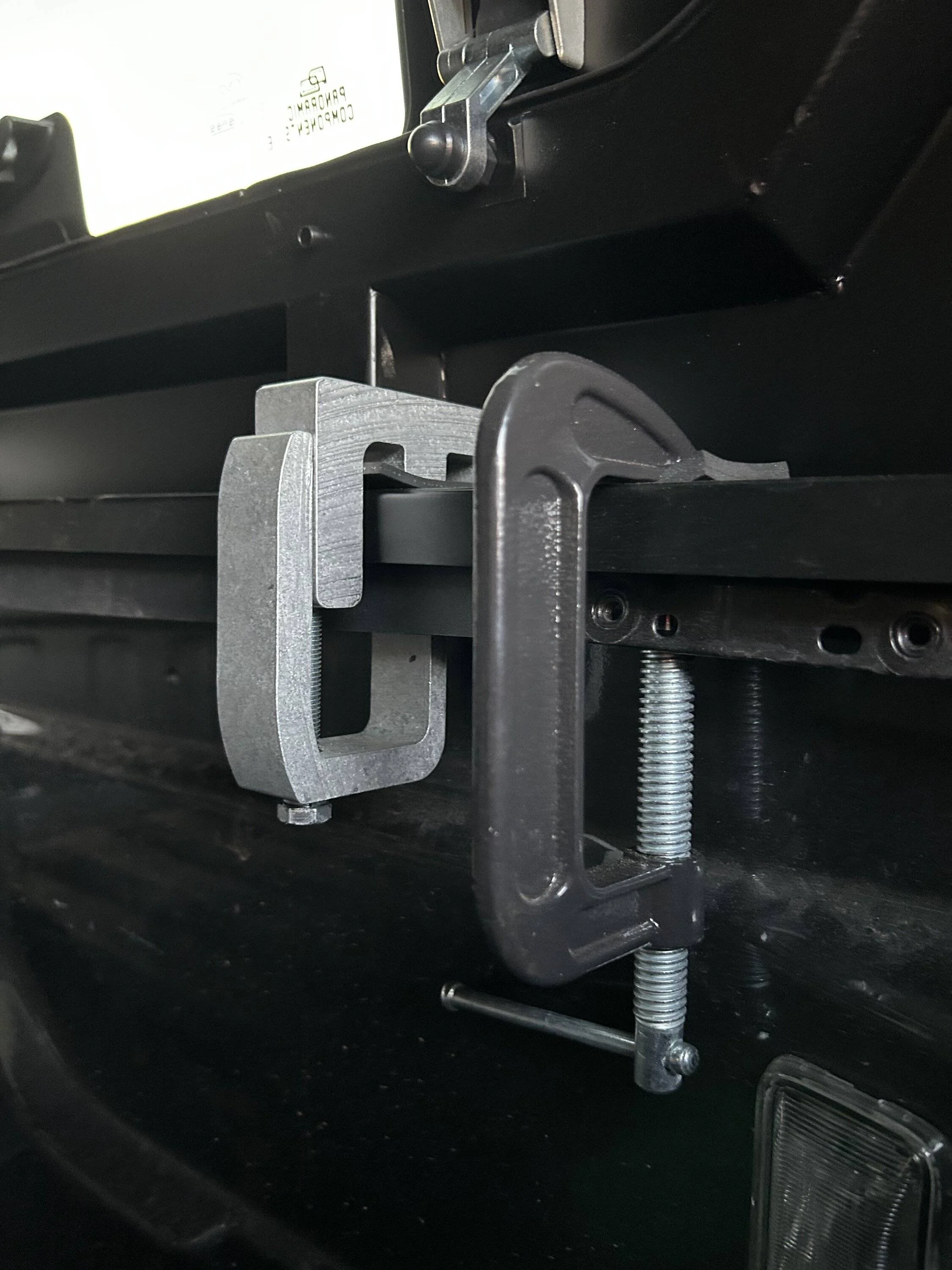

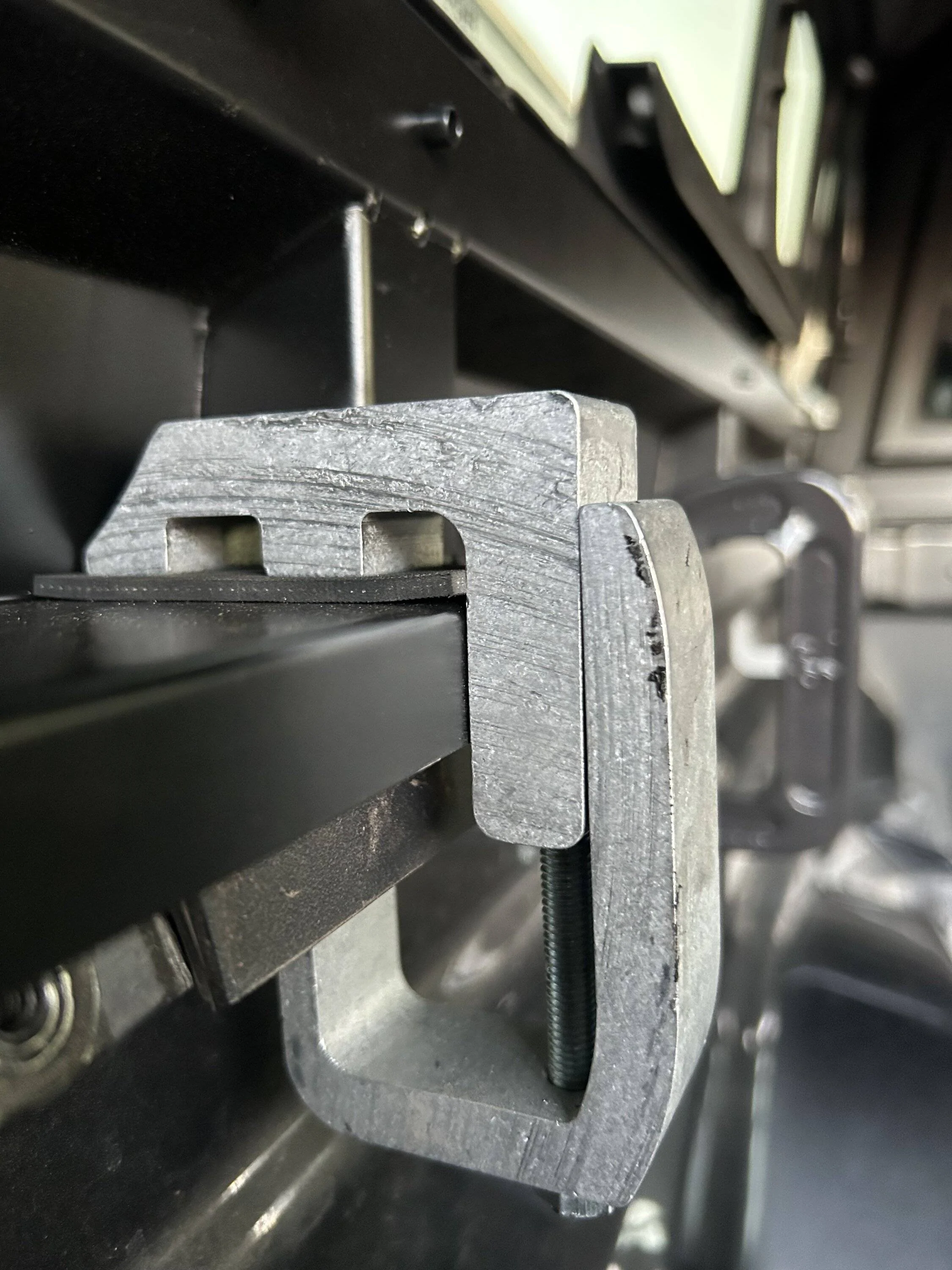

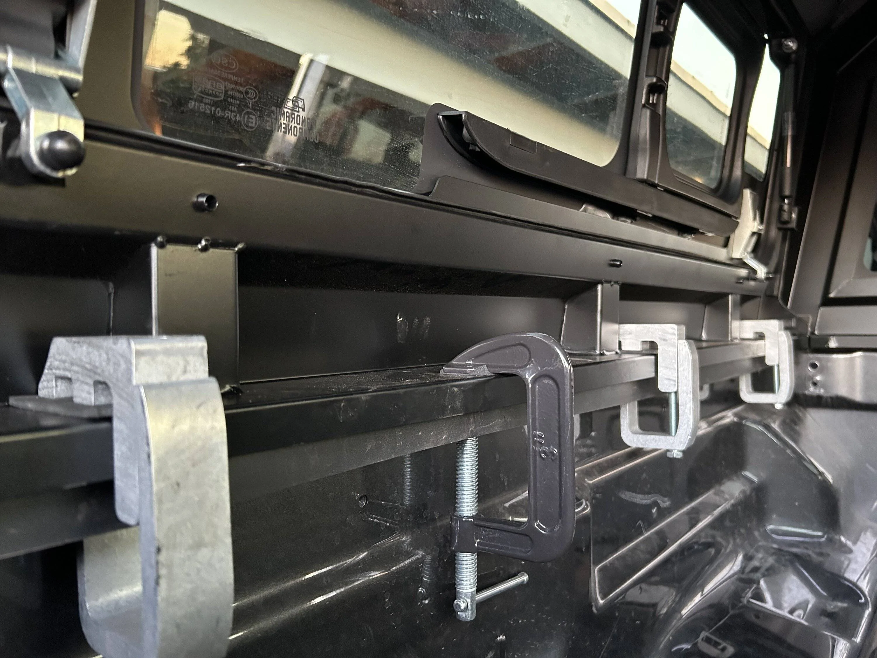

Depending on if you decide to clamp the smartcap down, you will have rubber gaskets to prevent damage from scratching the metal. I wanted to add some reassurance, so I went to Harbor Freight and purchased these 3in clamps and some weather stripping to help clamp it down a lil' extra.
Hope this can help a little bit!
