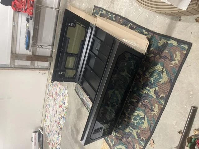

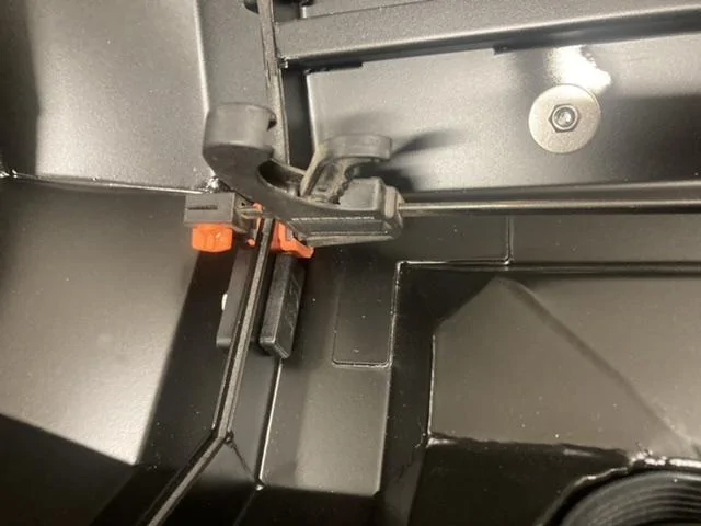

Updated from an hour ago, have sides and front on, all by myself not going bad, one photo shows the clamp I am using to hold it together , makes it alm eadily , starting the back now!......Jack

A SmartCap install followed by picking crab... that sounds like a heck of a good day!!!! Just make sure you do not try and flip the cap over yourself. The guy that did that on the forum was a bit lucky he didn't damage the cap or the D gasket. Also, when you and 3 others put it on the back of the Gladiator, try not to slide it on the bed rails to protect the D gasket.

Even with a helper, I found a clamp or two sure helped things go smoothly.

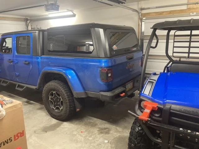

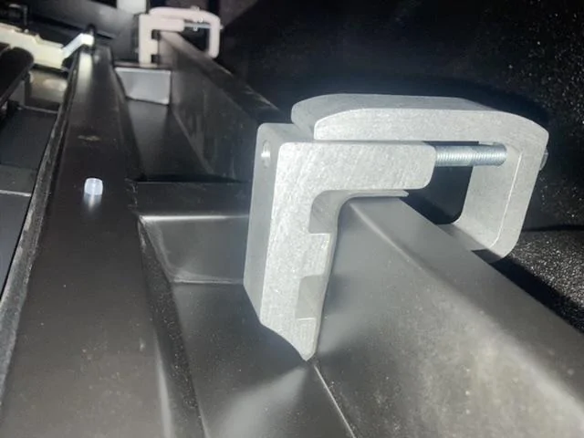

Just about done, had an early Christmas today also, top is on, lifted with son in law and daughter, did not go bad. I did use the clamp scratch pads, cut them about in half and glue taped one to all eight square pads, set cap then gasket was ok but we decided to add another piece of the scratch pads to the two corner pieces and also the rear two clamps. But had to play with remote control gladiators with grandson.
Used strips of rubber roofing under the clamps and I consider it an improvement made the strips long enough to wrap around edge that touches outside wall of cap and also wrapped down over lip so there is no metal to metal point of contact, I really like the cap!

I would also add there is serious value in it’s appearance. I’ve already had someone comment about keep”building them with campers” because it looks factory.
