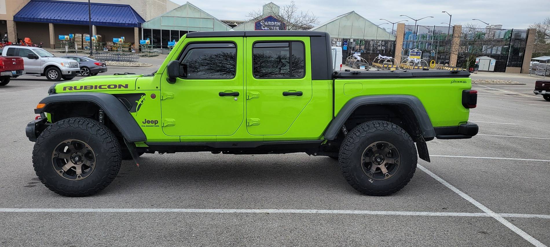

This my Rubicon diesel with the Mopar 2" lift and 37's. It also has Warn Evo 10 and factory steel front bumper.
Jeep Gladiator Rubi diesel lift advice that maintains rake 20240227_120433

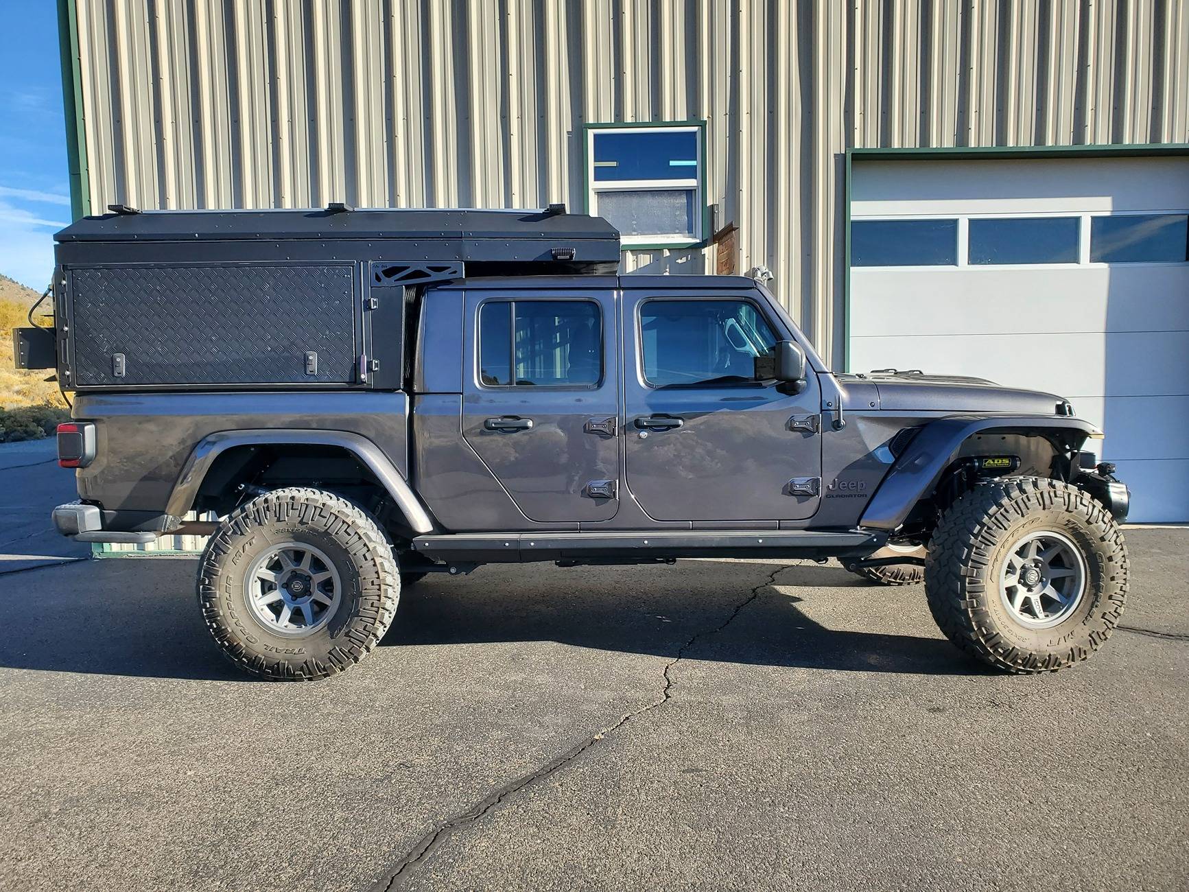

I have Clayton 3.5 HD's in the rear and Synergy 4.5" gas as the Clatons were to stiff. With ADS 3 tubes bypasses etc rides incredible in any terrian. I weight aprox 7400 lbs all extra on the rear.
It sets dead level with a full tank. So adjust the springs heights to get the stance you want. I'm on 38's.
Jeep Gladiator Rubi diesel lift advice that maintains rake 20241025_092002
