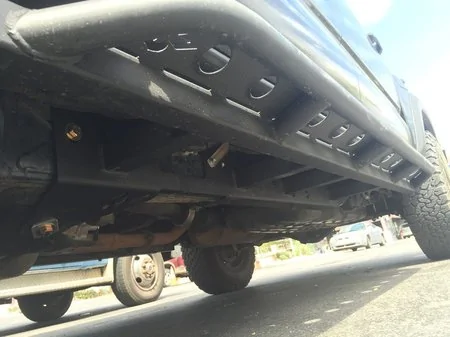

I hear that. I have Poison Spyder bolt-on frame mounted slides on my JK. Just say no to body mount, especially with such a low breakover angle

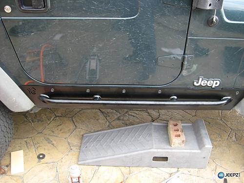

Can you show me with a photo of what you mean? If its bolted to the body, wouldn't it be higher than the frame mounted sliders?

The thing on the Rubicon sliders is that they bolt through the pinch seam holes, and usually three body bolts on the underside. The one Steffan is showing uses rivnuts. You have to drill into the body and install the rivnuts to use that. However that specific model is a combination of body armor and a rail (though the rock rail looks a bit high on the body to me). It's not a bad option.
Good frame mounted rails will simply provide more protection to the body around that pinch seam.
This isn't to say that the Rubicon, or other body mounted, rails are bad. They aren't. It's just that you get better protection with frame mounted rails.
