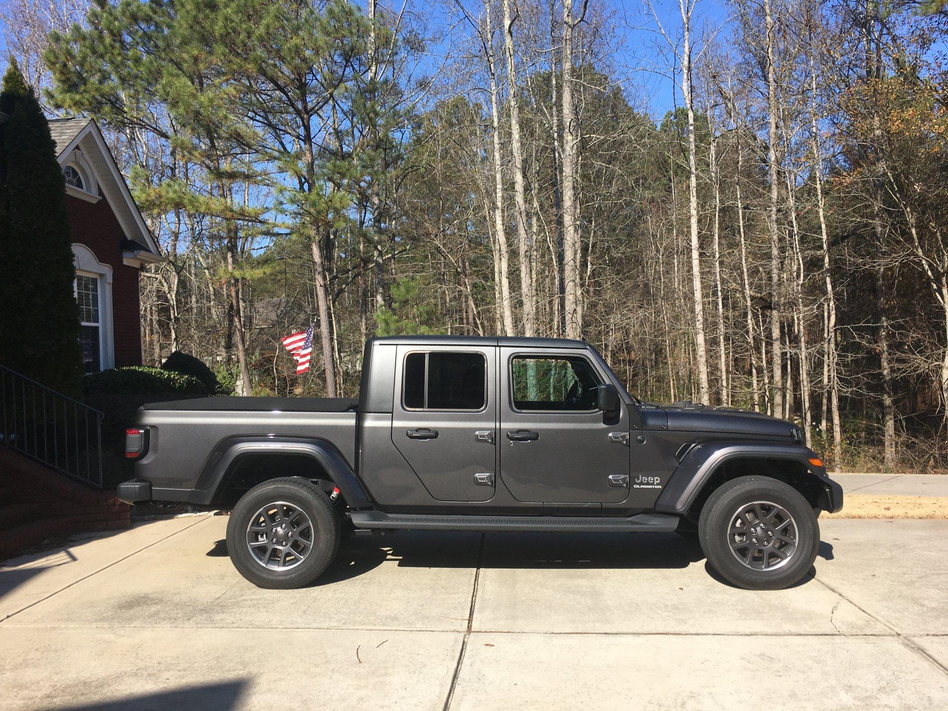

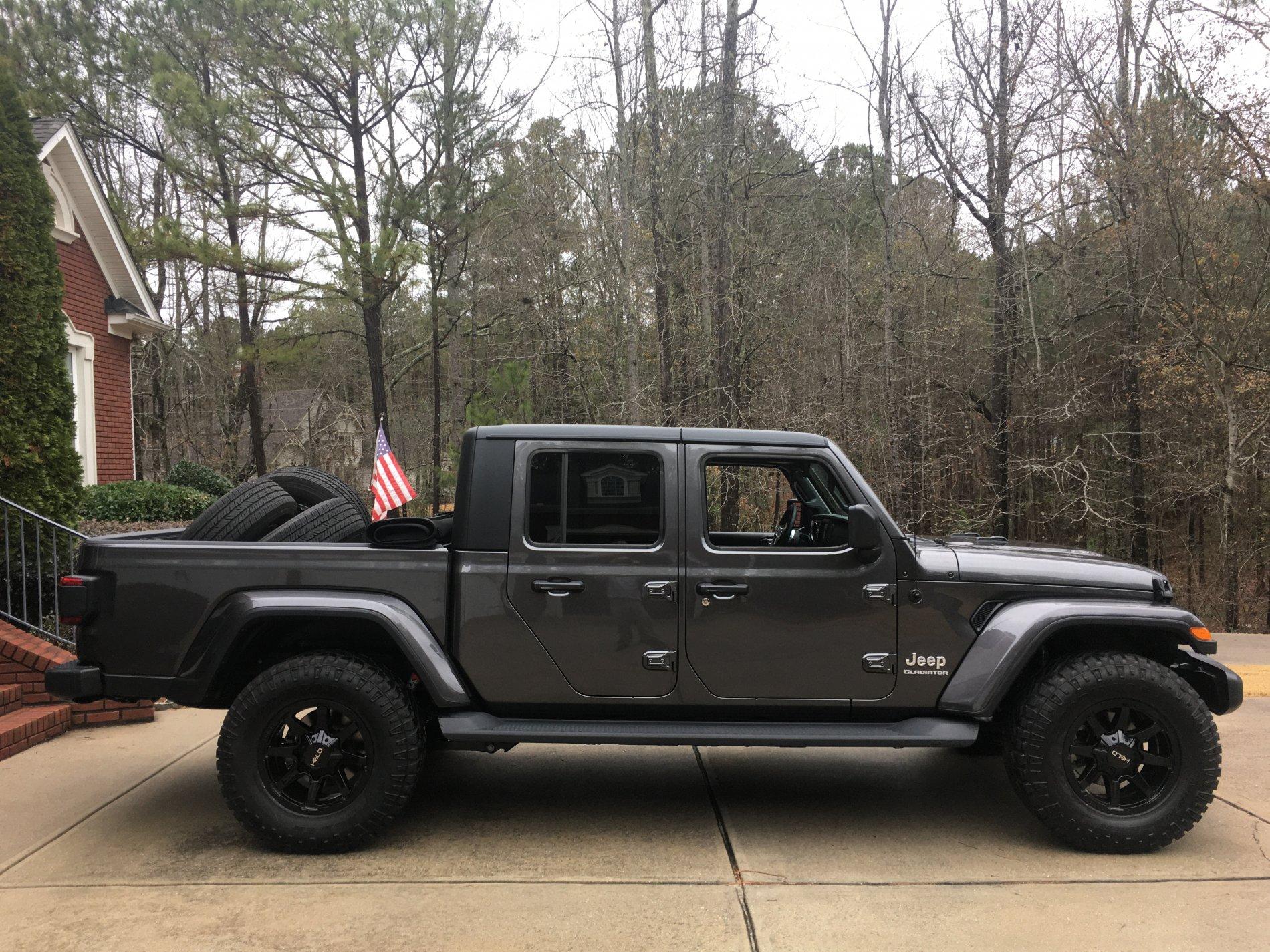

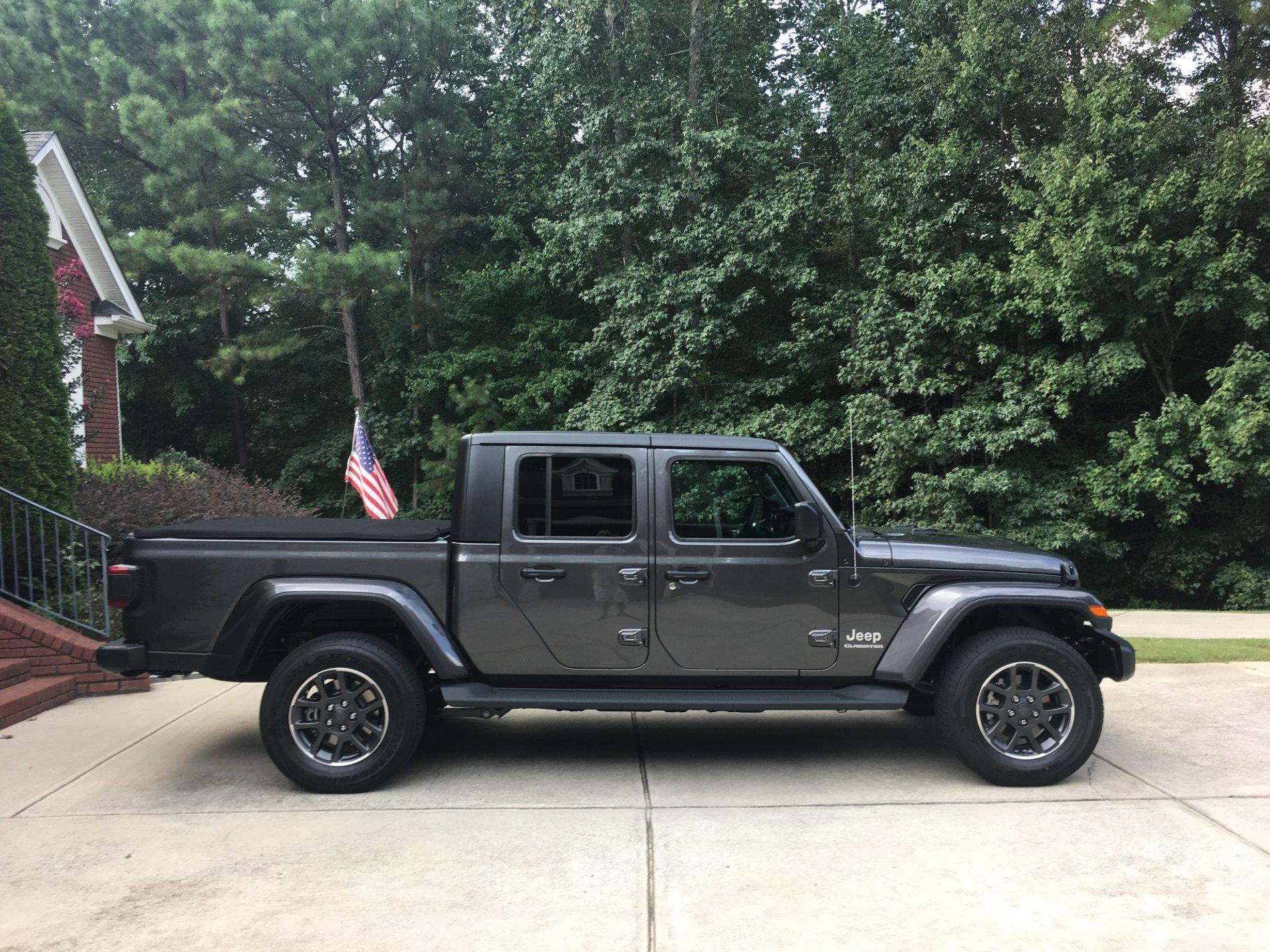

Buzzlb
James
Nov 13, 2019
412
773
Atlanta
Gladiator Overland: The Overcon ‘82 CJ-7
See mine and other posts on the details, gained 3/4” back & 1.25 front. No change in the ride.

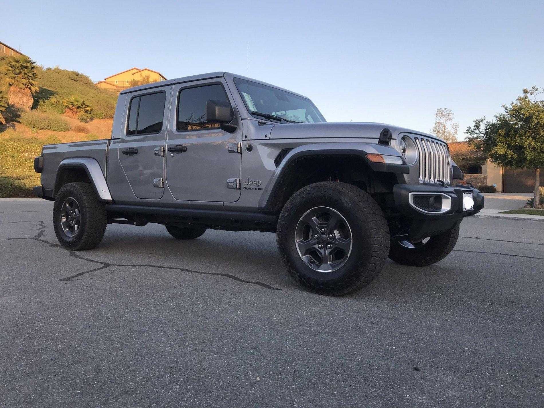

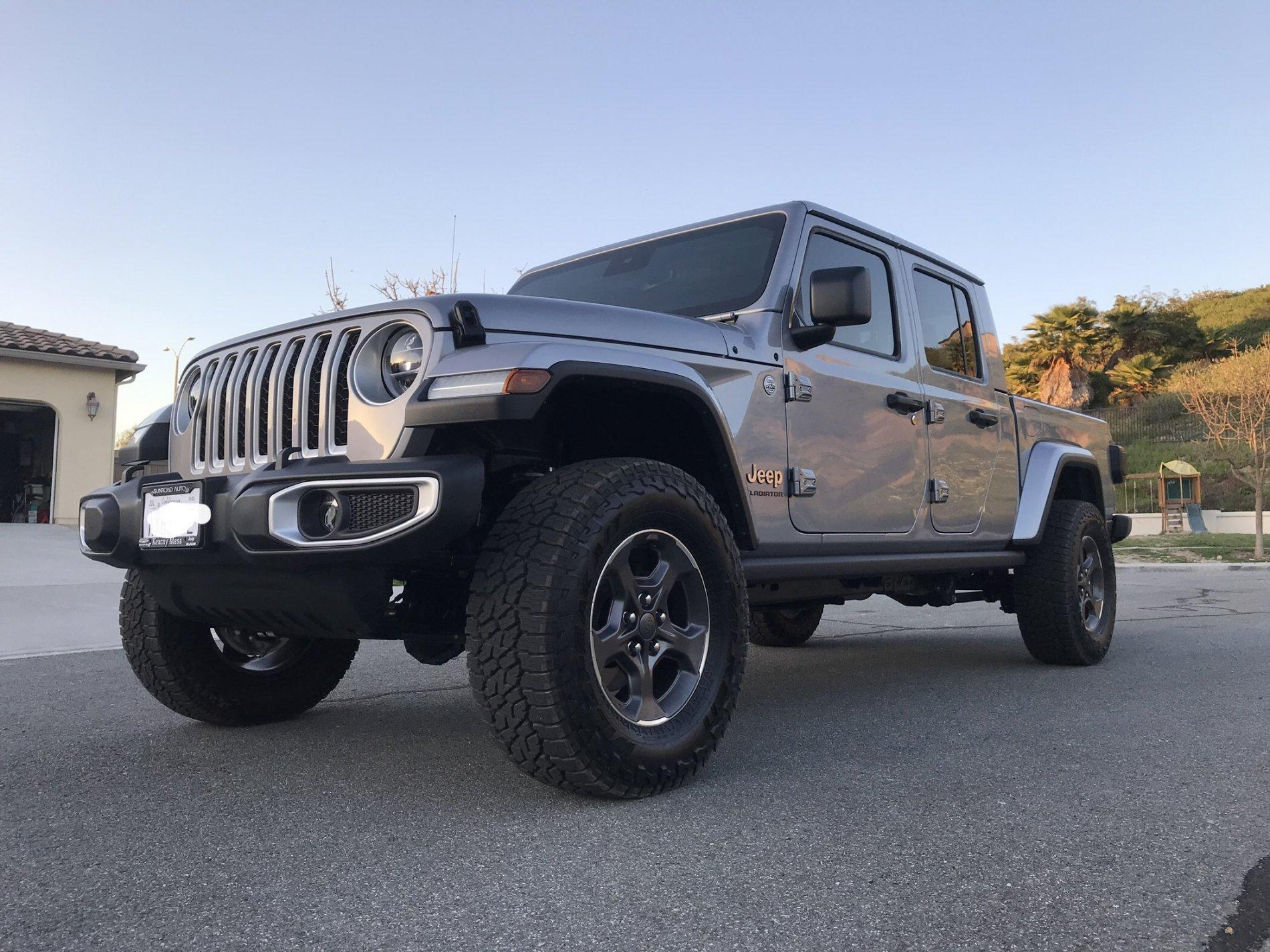

teleportJeep
Marco
Mar 31, 2020
94
127
San Diego
gladiator
I just installed springs, shocks, tires, rims from a rubicon along with a 1.5 teraflex leveling kit at the front, no kit at the back.
At the front it gained 2.5” and at the back 3/4”
It took me about 4hrs to change everything out.
Hope this information helps.
