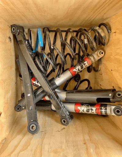

NOT ignoring you brother, I had to work today, and I think @Ole Cowboy and @WXman pretty much hit it before I could sit and type.
I would think adding the Rubi Fox suspension would firm everything up perfectly.
I know @steffen707 did a lot of homework on this before he bought my OEM Rubi/FOX suspension to do this setup on his.
Well I tried to do a lot of homework, but not much was available. In the end I just took the plunge and said oh well. Now I gotta read about these leveling kits and what all that business is.

I appreciate everyone's insights! I came across some comparison info that is helpful too, that should parallel to the JT.
https://www.shocksurplus.com/blogs/news/jeep-wrangler-jl-suspension-overview
Looks like the main difference per the JT manual is the Rubi's hydraulic rebound stop. From the website:
The Hydraulic Rebound Stop within the main shock absorber body, is attached to the working piston. If the rebound stroke of the shock (extension cycle) achieves max travel, the internal Hydraulic Rebound Stop will then act as an internal shock absorber for the working piston.
What does all this mean for the ride in a Wrangler JL Rubicon?
Going overbumps, rocks, and other obstacles will be a more forgiving ride. As the shock rebounds from being compressed on an obstacle, any maxxing out the droop or extension of the shock will be dampened first by the internal bumpstop before transferring that energy to the vehicle, and then the passenger.

While I think grabbing the Rubicon take-off stuff is a great, inexpensive option... I would not pay a premium, especially for the springs. I plan to put dual-rate or multi-rate springs on at some point as it results in a much more connected feel. My Wrangler Sport with Metalcloak springs feels a ton better than any Rubicon JK/JL/JT I've driven. If they will come out with a shorter spring that works with the fox shocks then that's great, otherwise I'll have to have a lift and different shocks.
As far as the difference... as "they're just better" is vague.
Springs hold your vehicle up, or push it up when it gets compressed.
Shocks slow down the push-down. You can have different pressure and gas/oil in shocks that help with this control. The Rubicon Fox shocks are tuned for the Gladiator and those springs and will have smoother movement over bumps. Probably they'll be less prone to friction when doing too much travel... so they'll last longer and work better under stress. Fox seems to be the go-to for all factory provided performance shocks these days.

I found someone trying to unload their Rubicon suspension takeoffs for $300. That price seems to be in line with Rubicon takeoffs in the Wrangler market, but a little cheaper for a Gladiator. They say these only have 200 miles on them, so even with some exaggeration on the "newness," I'm probably looking at components with less than 1,000 miles.
It only has 2 of the 4 sway bar links, and doesn't include the 2 front isolators. Any idea if the Overland already has isolators that will work with these components, or will I have to buy a pair? How much would it cost for the 2 shorter sway bar links?

Overland has those isolators
