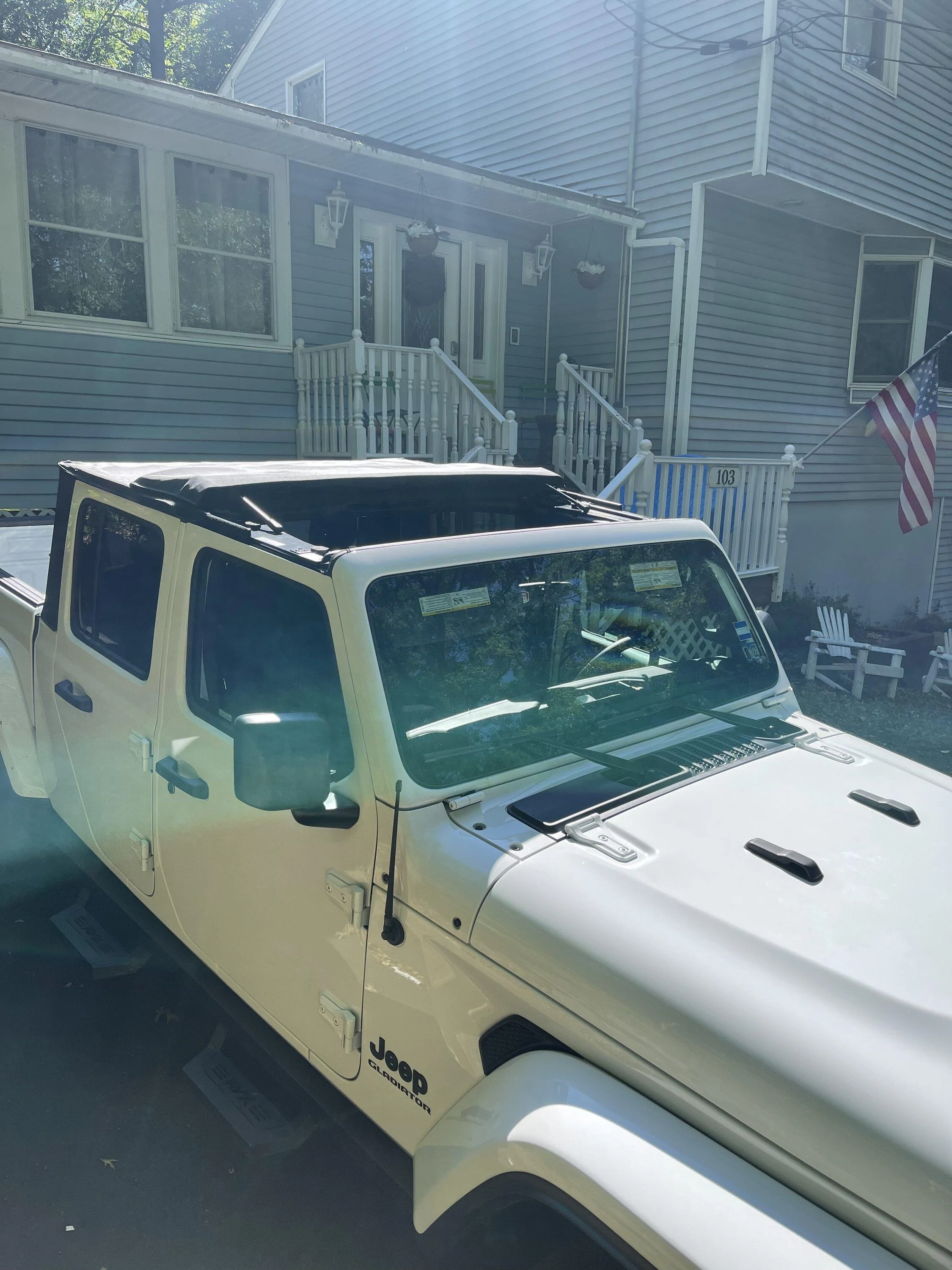

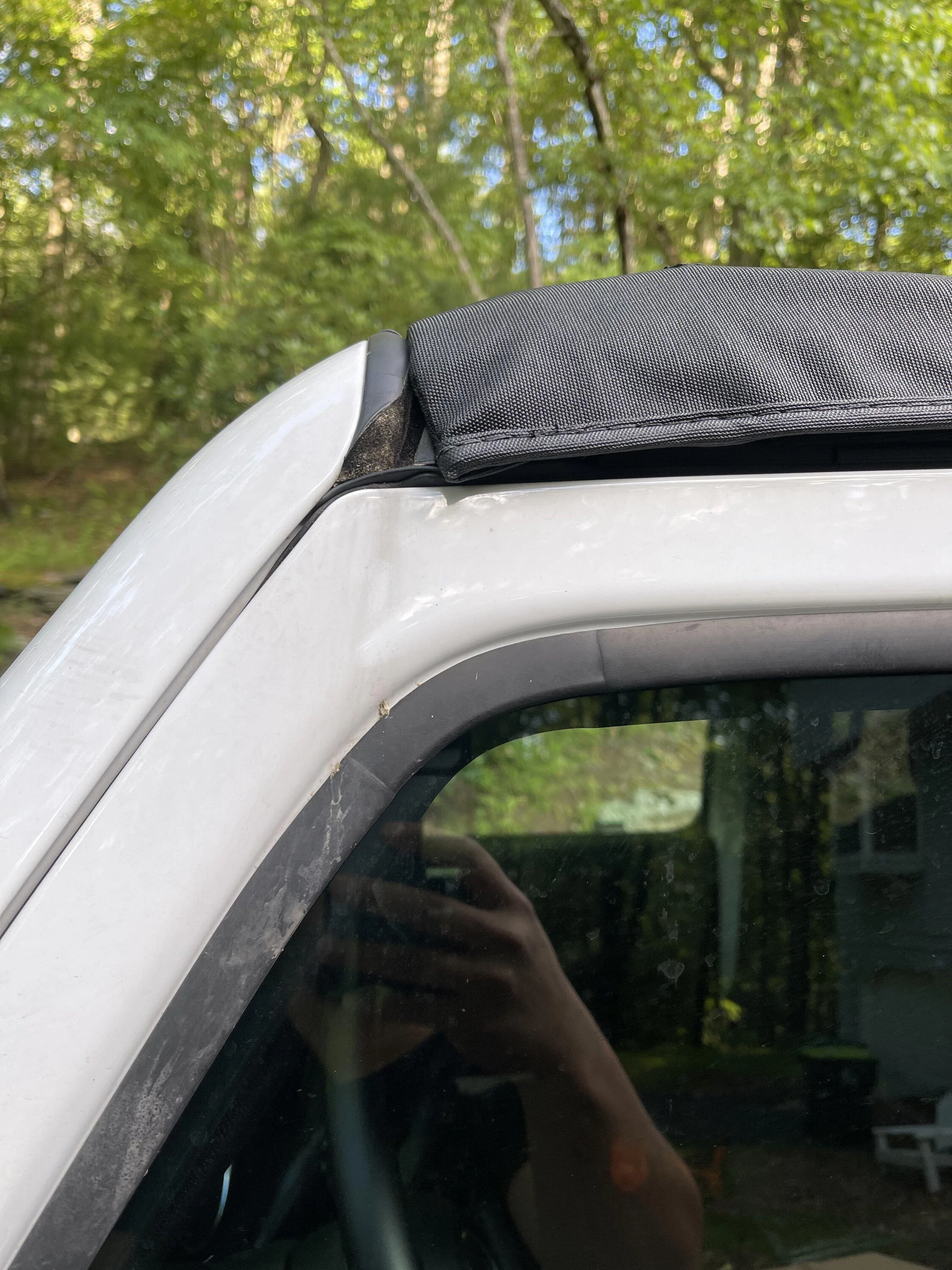

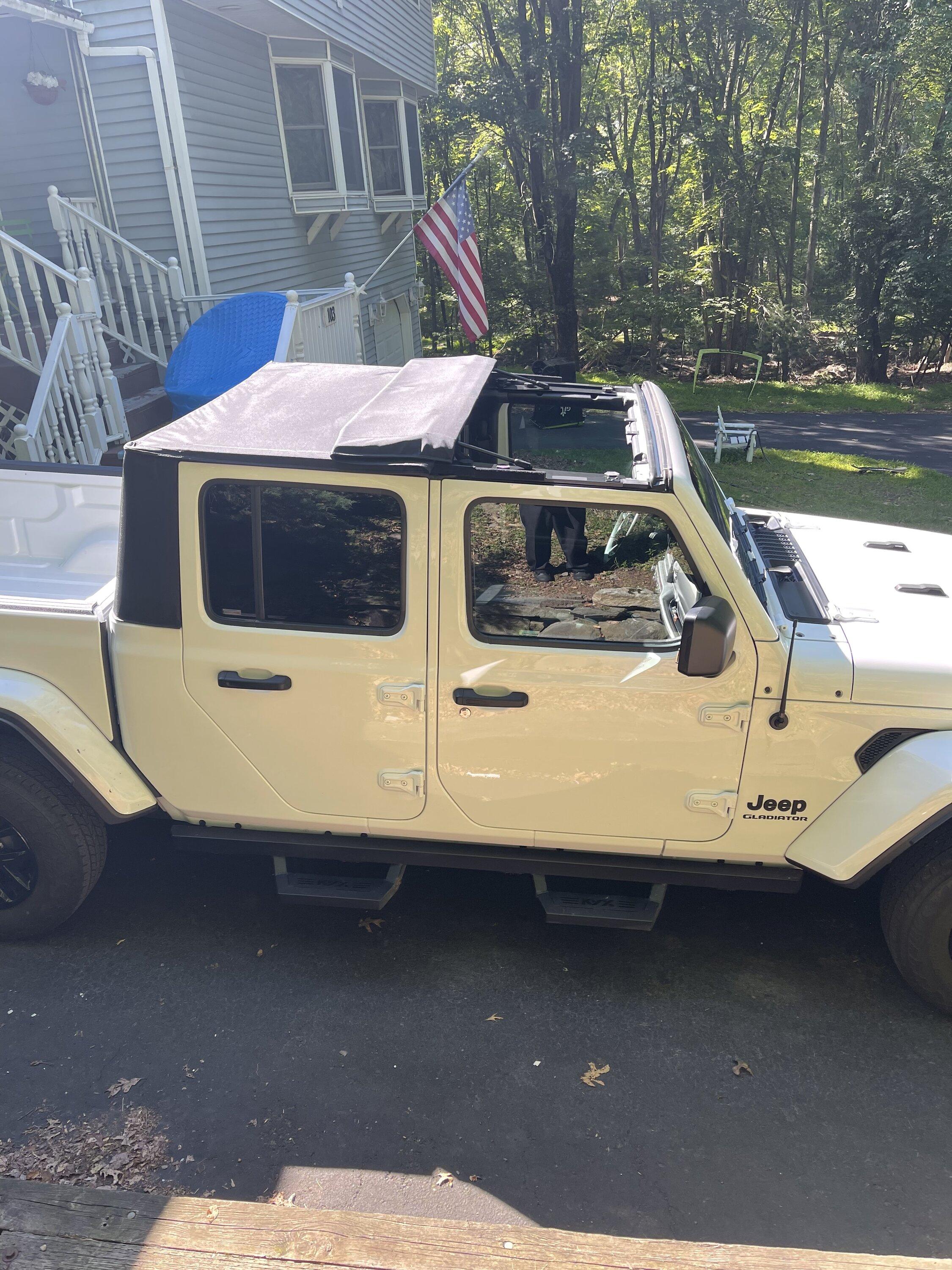

Mine goes back on memorial day weekend ...
However I want to experiment so I am looking for either a broken factory top or broken sunrider I just need the front header panel so I can adapt it to use factory clamps
I also plan to modify the side brackets so it sits right
atvsmurf
y
Mar 21, 2026
Beckley WV
Gkadiator
ASE certified Pharmacist

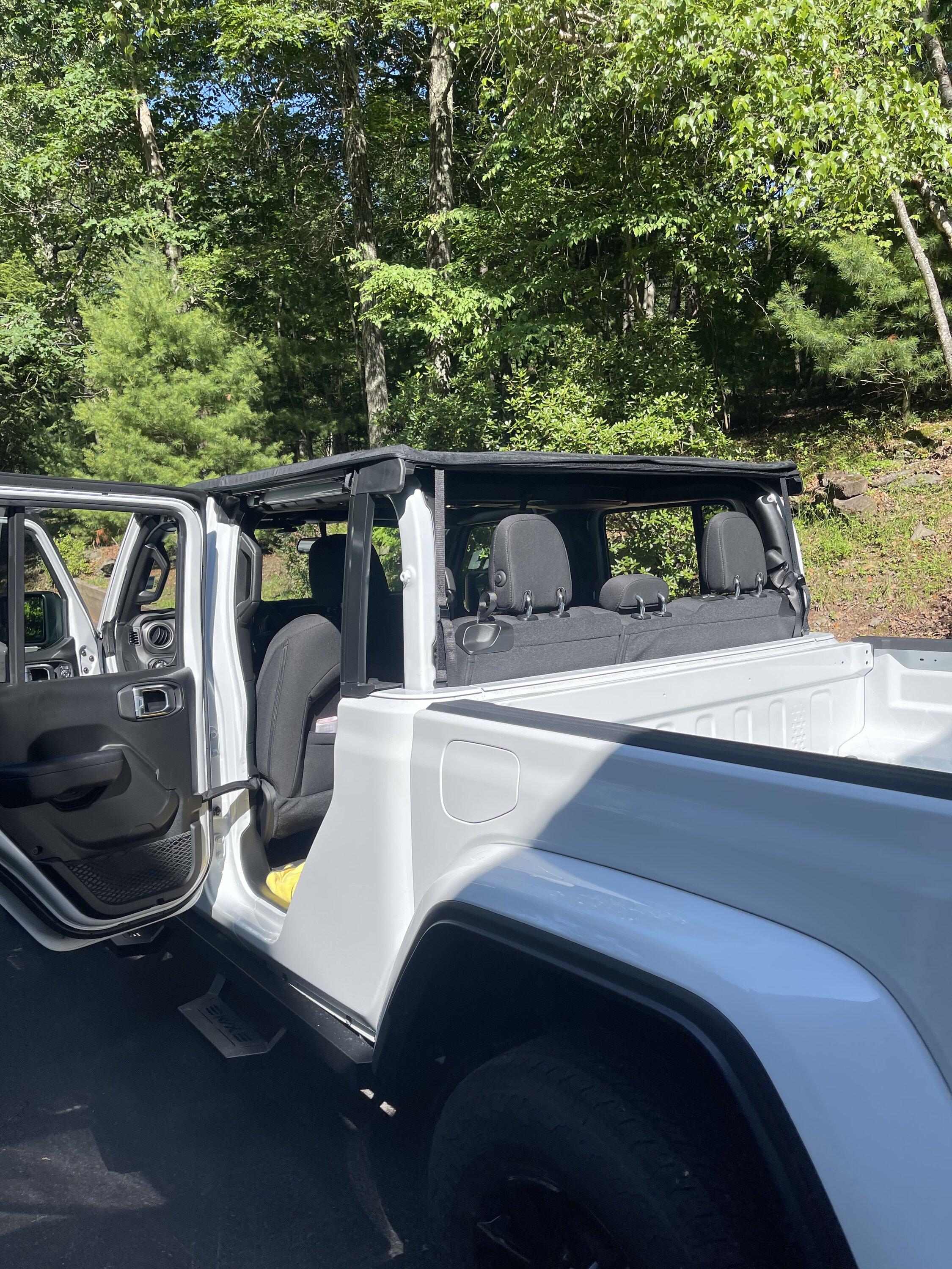

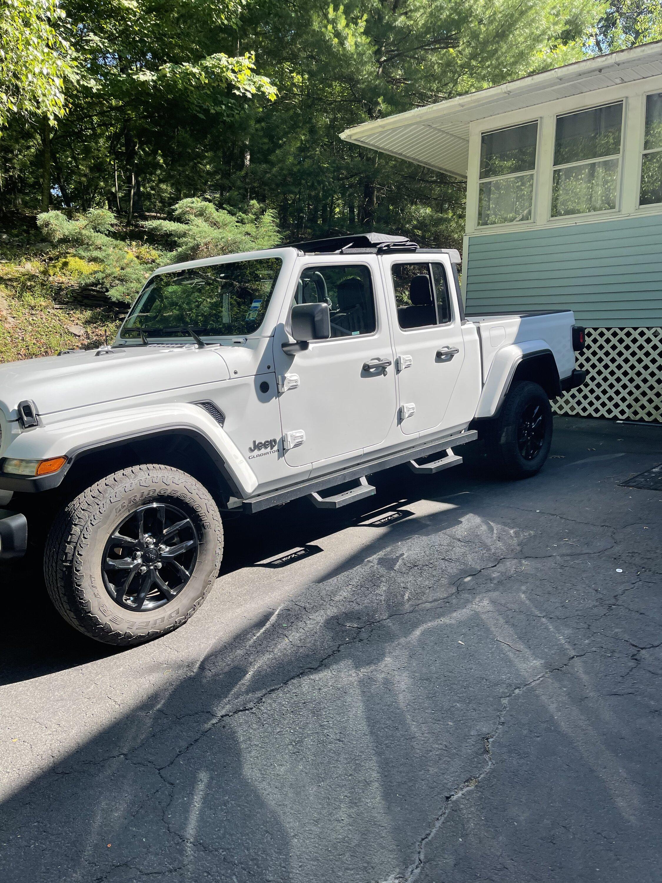

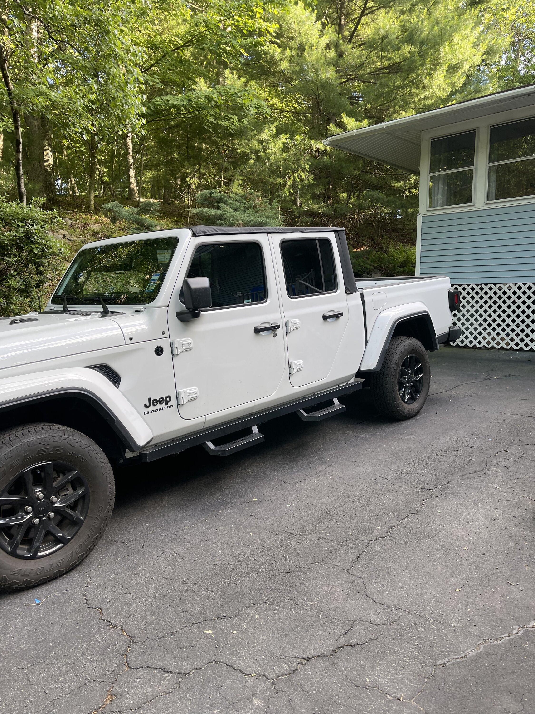

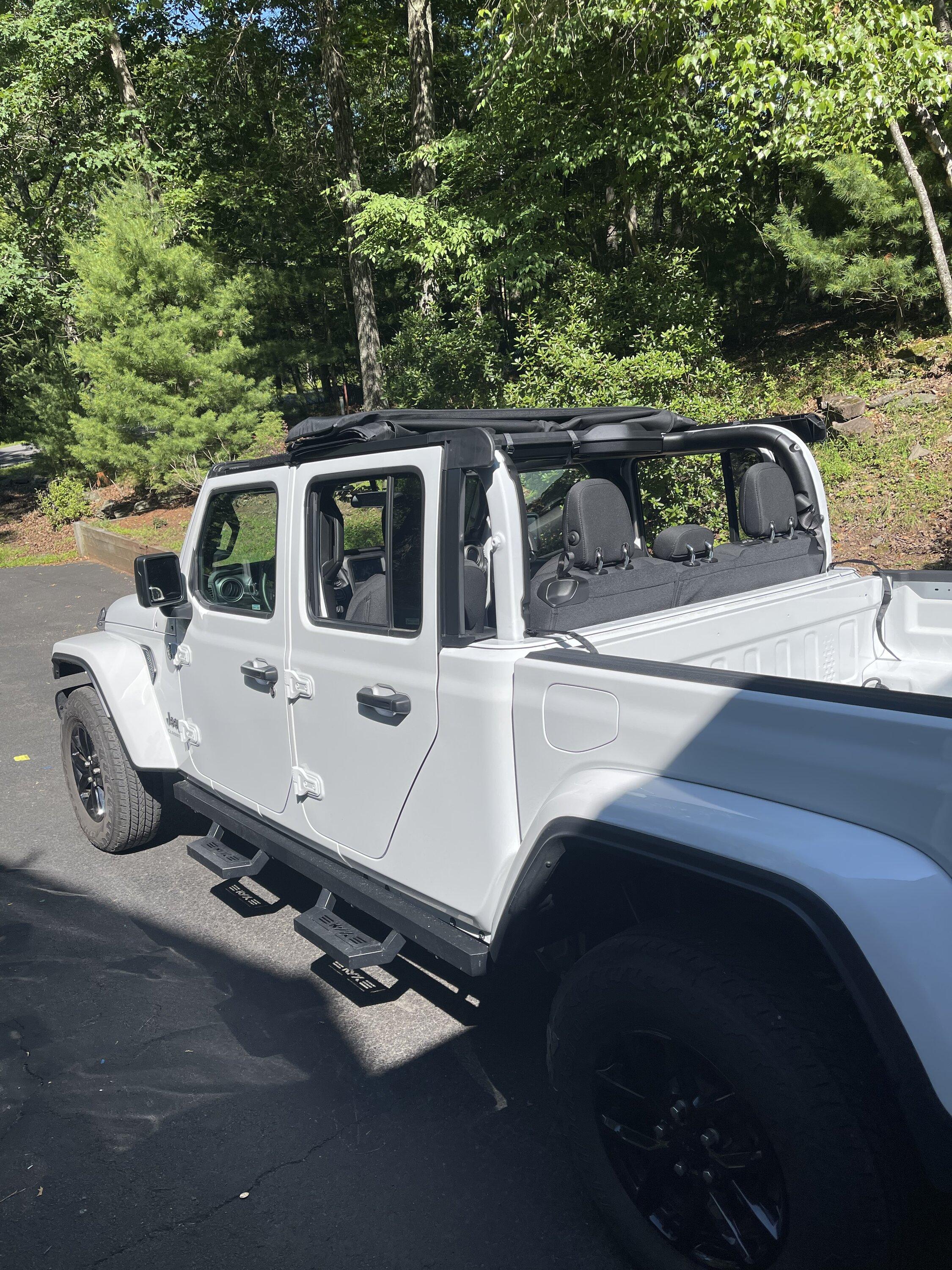

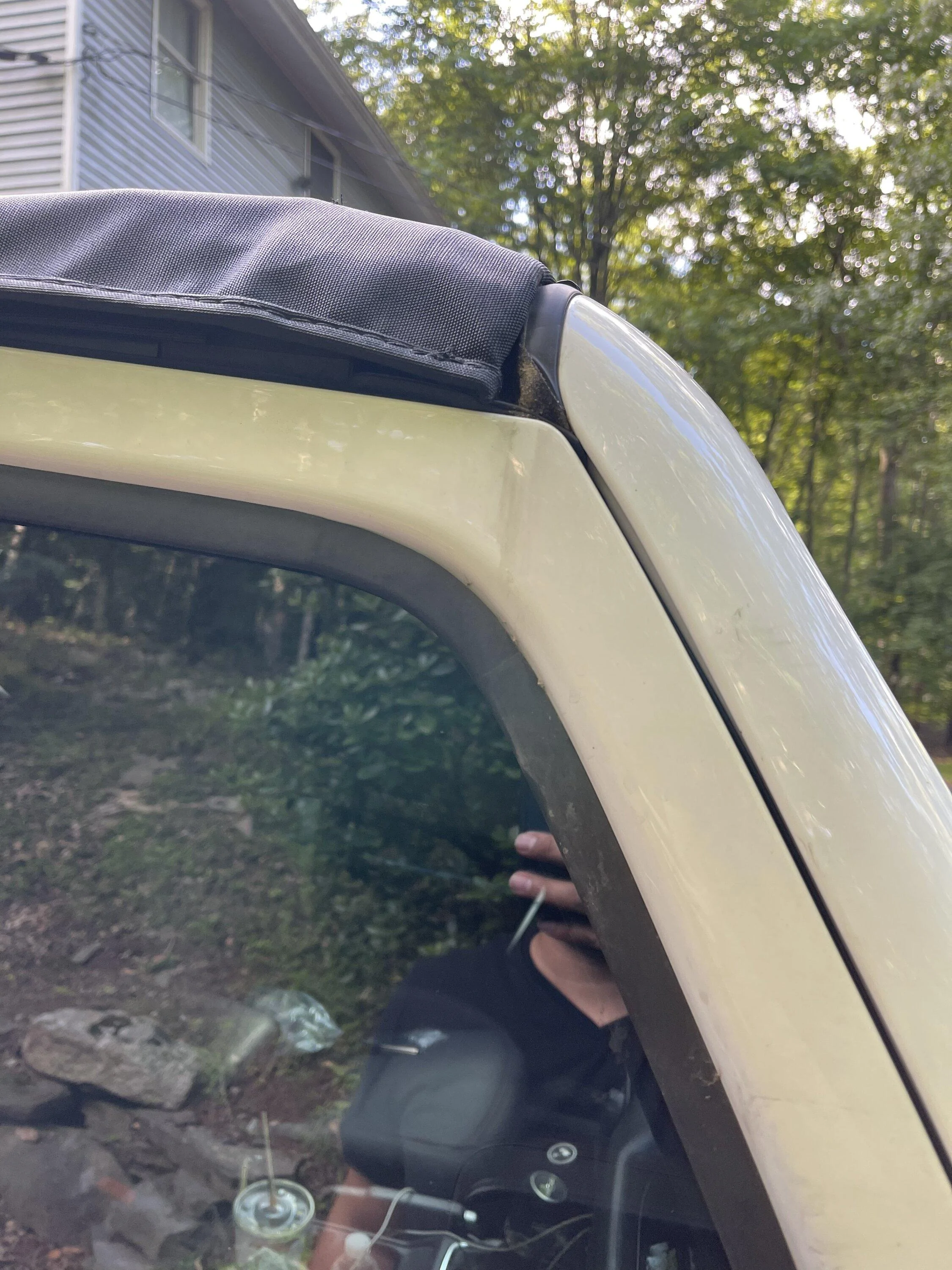

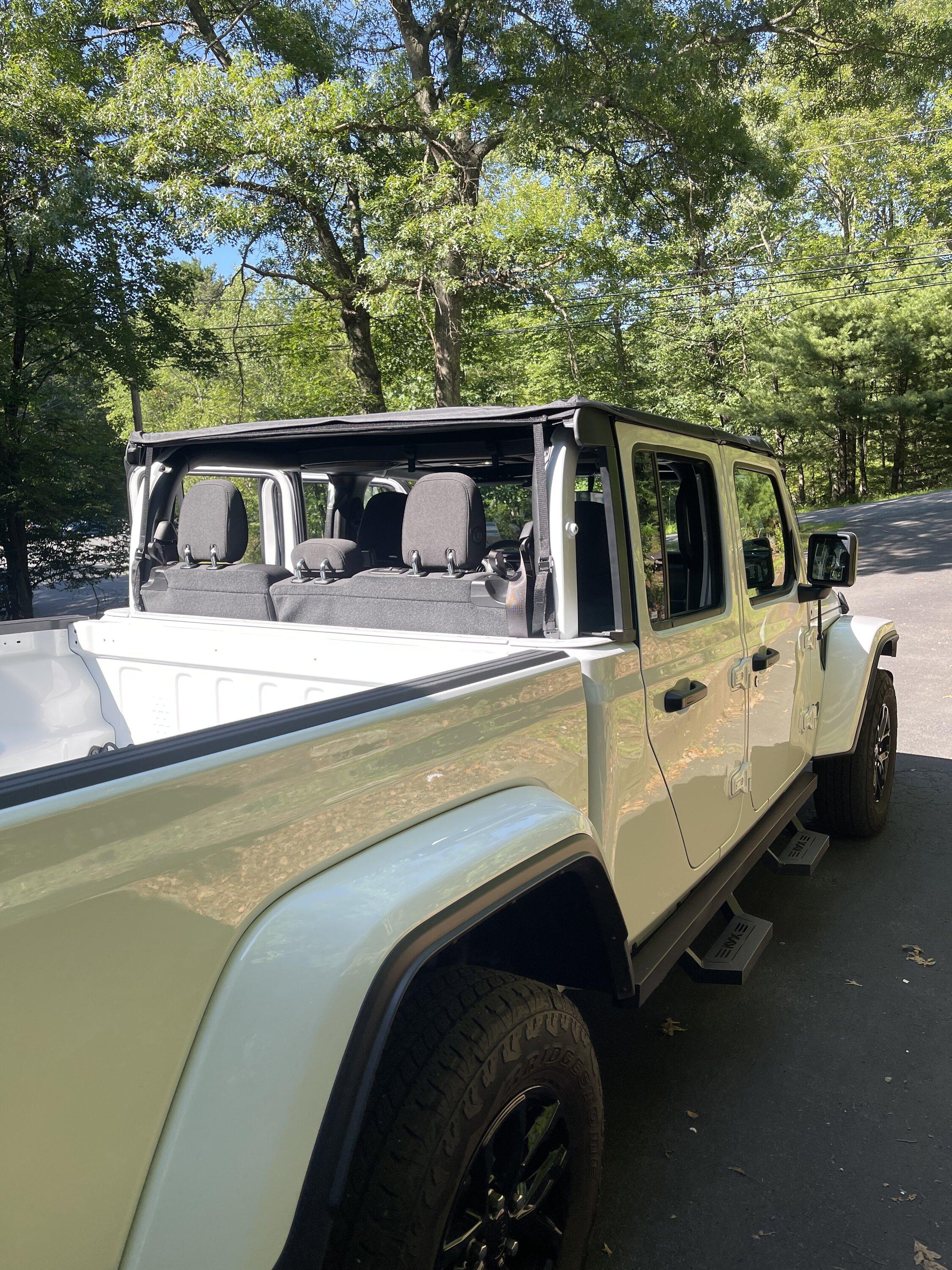

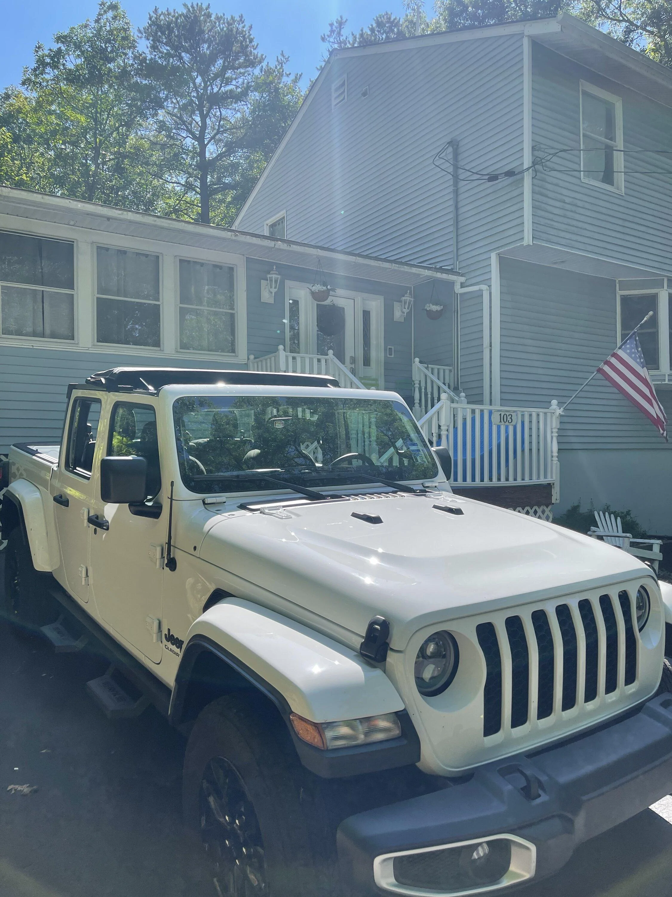

Yes, worked with the engineer… the brackets that hold the over door plastics to the spot cage, were welded wrong. Cut the welds, and made a slot with a bolt through to adjust until it was tight.
what you see there, will not have any bearing on the frame sitting where it should. The bracket circled was welded 1/4 inch off on both sides, it held the tops windshield header too high to seal against the windshield.
What year is yours? I have the same issue with my ‘25. I have been talking with their tech people for a week or two…
they seem to be clueless regarding this.
Who did you talk with? If it was rugged ridge’s email, could you find and pass their name to me? I can ask for them… I have a grinder and a welder. I just hate to hack into something under warranty lol
