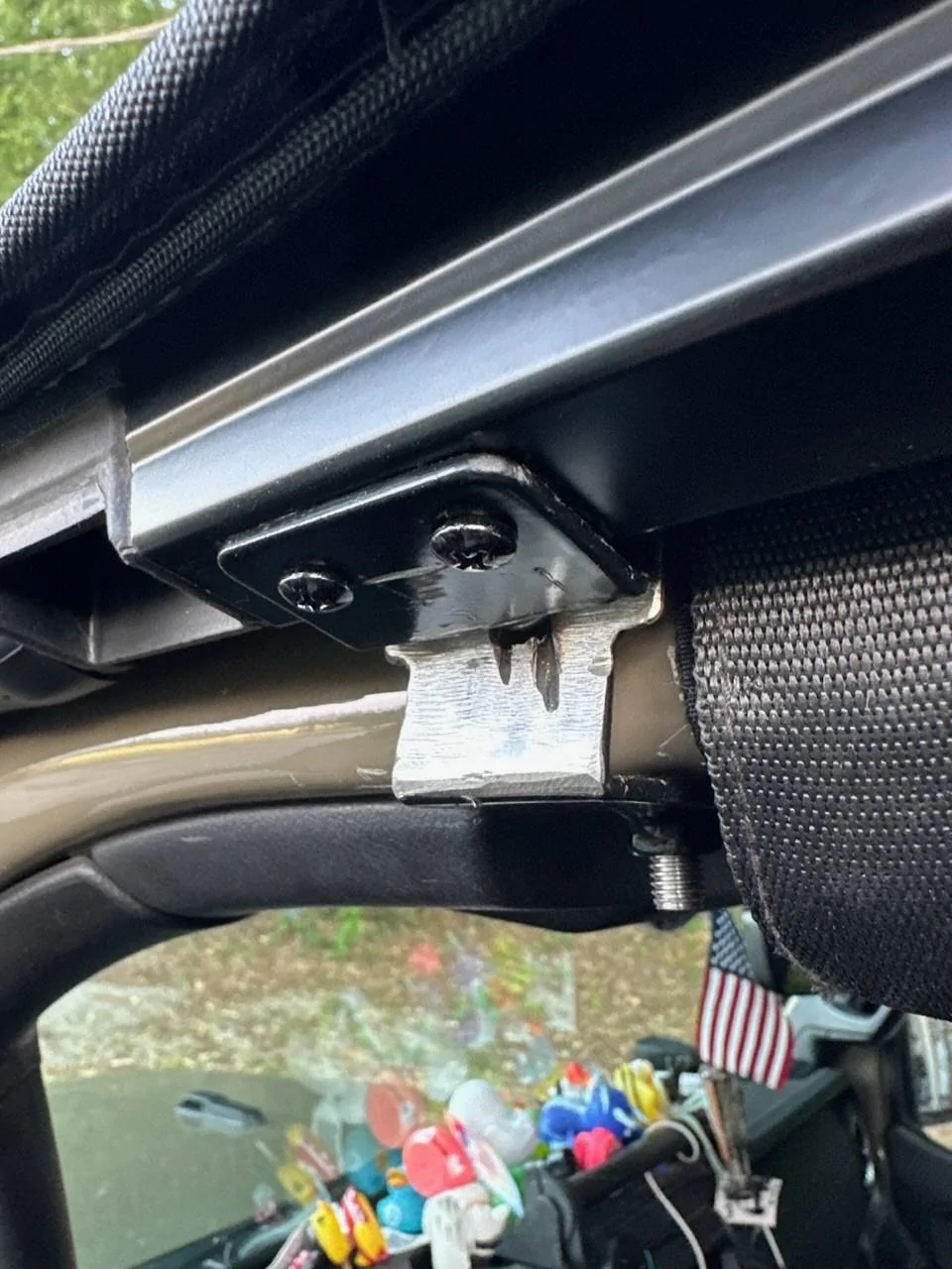

I had to separate(cut) the welds on the front most brackets, and adjust the 2 haves to get them at the correct height for the front to seat. For me, it was lowering the door surround part to where its lowest part was even with the steps on the roll cage side. I just reconnected the halves together with a bolt… I don’t have a welder…
Jeep Gladiator Rugged Ridge Voyager Soft top 70804813871__FCFC1AC4-5987-4D60-AF2A-EC4898EFDE6E

Not sure if you ever figured out your issue. But the top in this picture is not on the bracket correctly. See step 21 on the instructions. There should be a plastic flap that tucks in that grove between the 2 pieces you are talking about and the long thin metal plate.
So, really looking at it tonight. There are 2 tabs on each side,~ 1 inch and ~4 inch, that are holding it from seating at the front…
and where they sit…
Yes, worked with the engineer… the brackets that hold the over door plastics to the spot cage, were welded wrong. Cut the welds, and made a slot with a bolt through to adjust until it was tight.
what you see there, will not have any bearing on the frame sitting where it should. The bracket circled was welded 1/4 inch off on both sides, it held the tops windshield header too high to seal against the windshield.
Jeep Gladiator Rugged Ridge Voyager Soft top 1711589807663-dd
