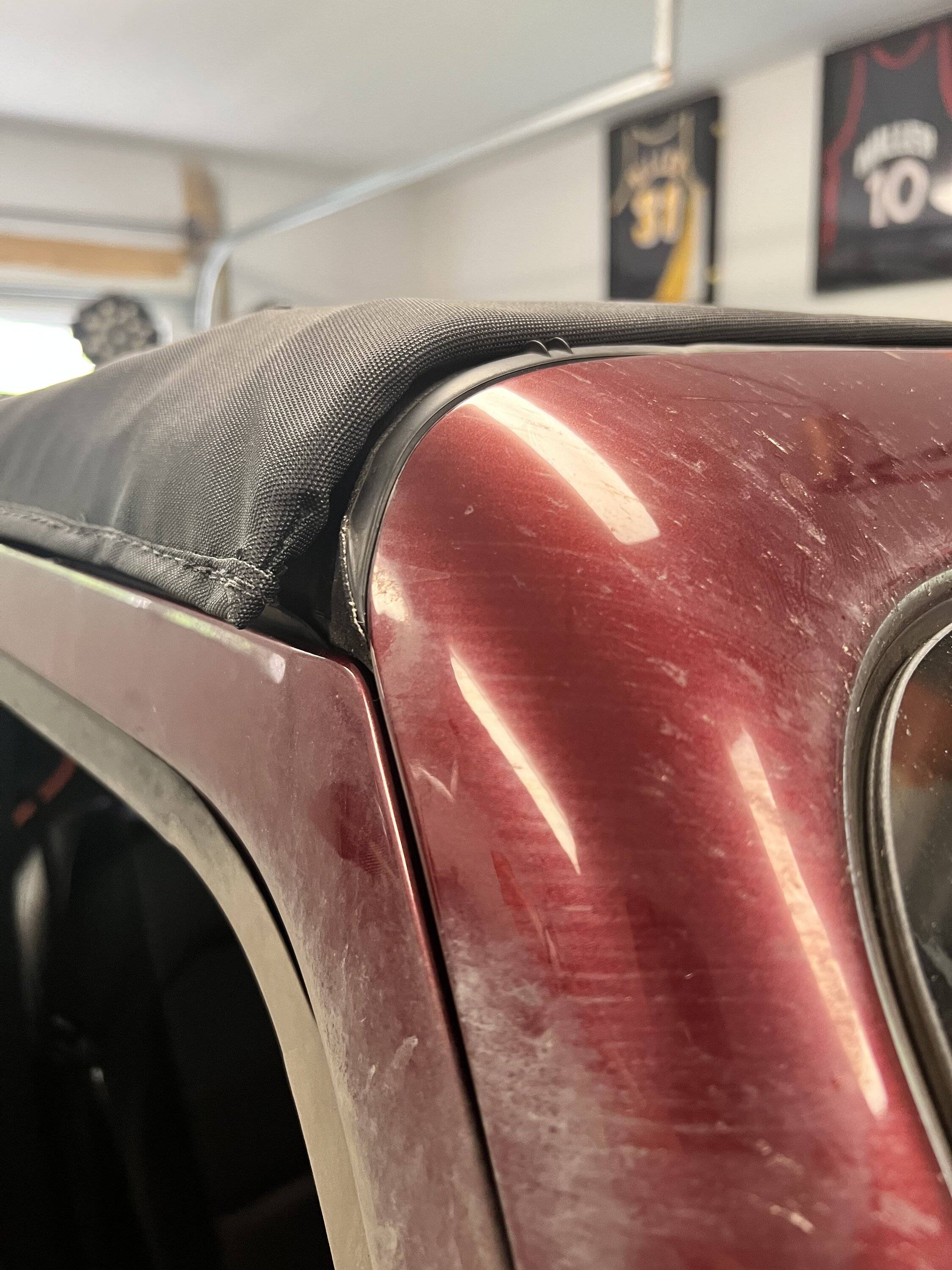

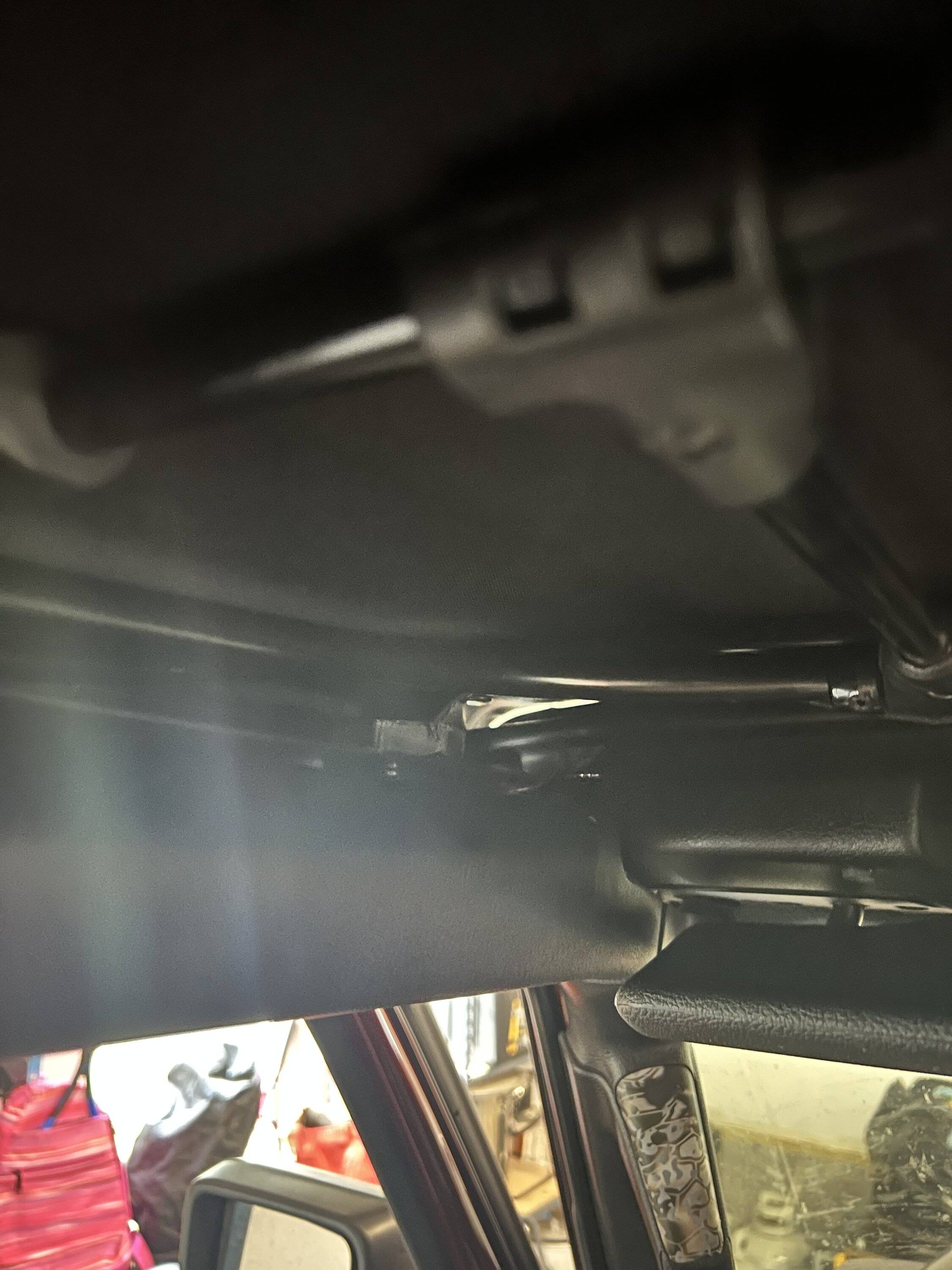

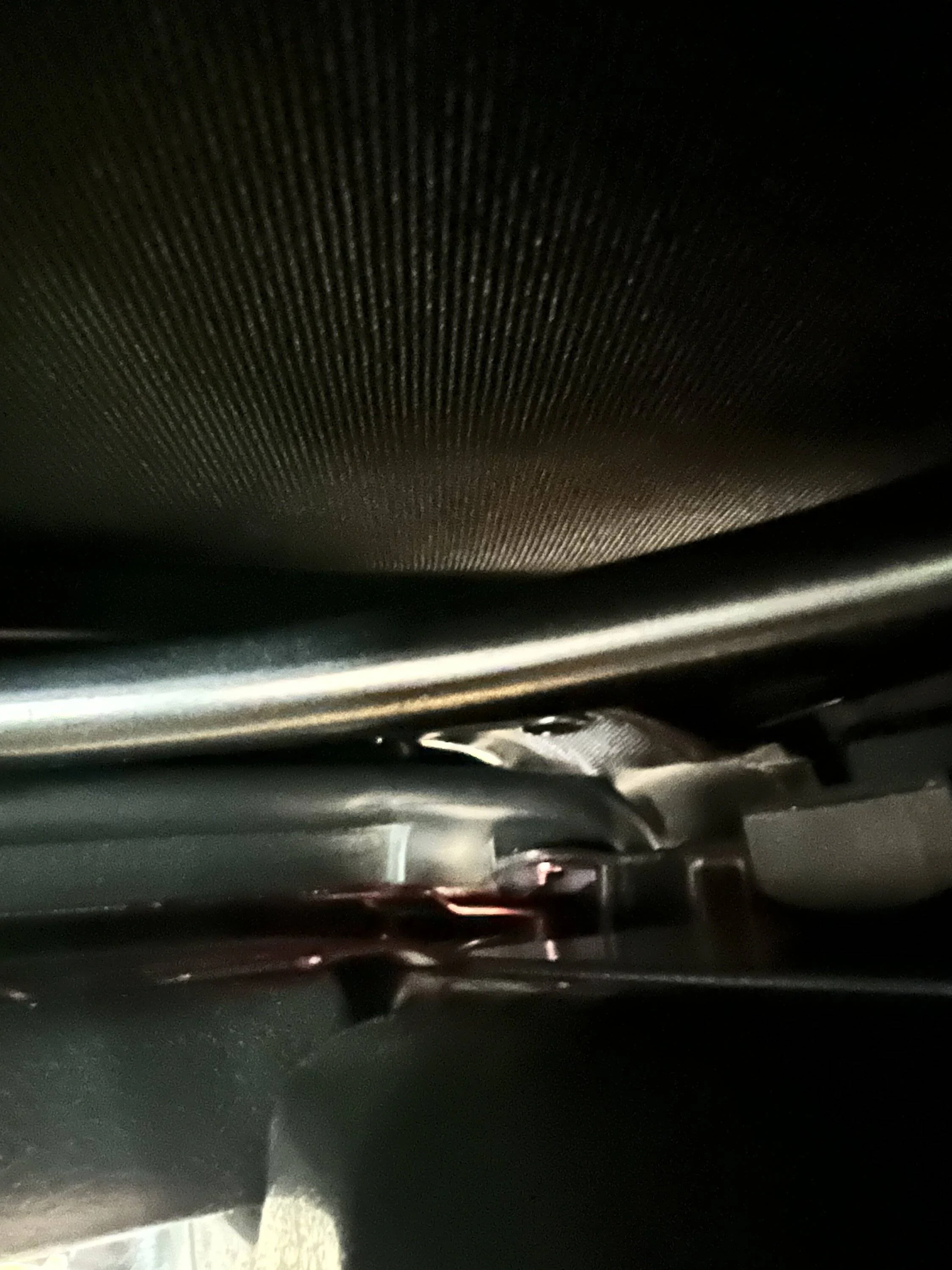

Hey, I just got this voyager soft top installed and I have a couple of large gaps in the front corners.
pics below. Anyone with ideas how to adjust this so these are gone?

I did manage to somewhat fix it.
I had to grind off the front most tabs in the front that sit on the door surrounds.
that still helped but didn’t 100% fix it. I stuck some expanding foam weather stripping on there and that finally sealed it up. The sticky back 1” frost king stuff.
The best way I found to position that weather stripping was to cut it the length of the existing gasket and lay it down sticky side up between the two gaskets. Then lower the top so it picks up the stripping then press it in place with your hands.
I’m working on writing a long review of this top and all of this is gonna be detailed in there with pictures.
