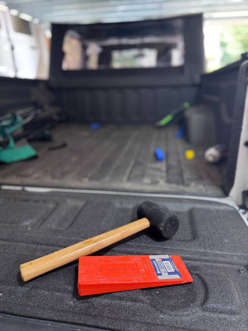

Took a mallet and tapped the wedge the length of the channel and it slid right in. Just need it to stretch a bit so I can zip the last inch and a half closed.
Maybe following the video on realtrucks website vs reading the terrible instructions and removing the freedom panel latch as a member here suggested is what made the difference because this thing has terrible reviews on pretty much every seller’s website. I’m really satisfied with the fit and finish on it.

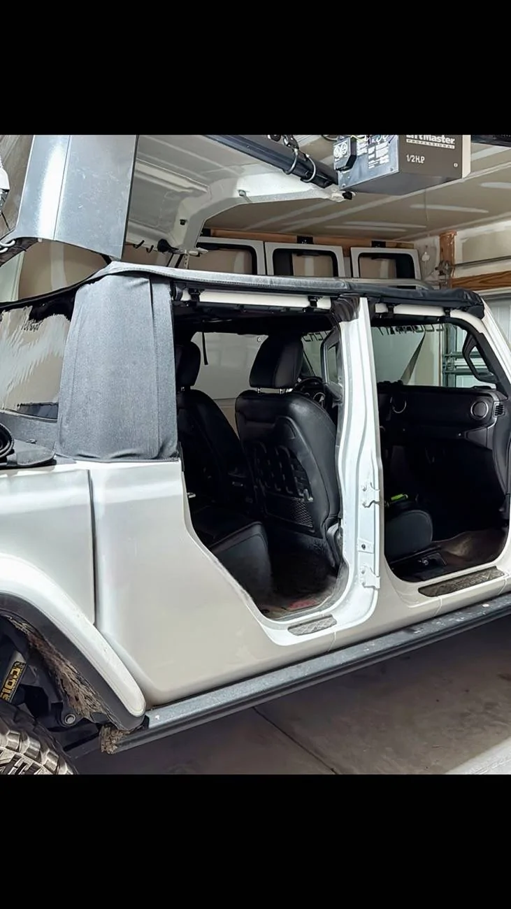

Worked on my install this weekend and I cannot for the life of me get the bottom of the rear window into the channel on the tub. The side pieces lock in just fine. Any ideas?
@jjdustr340 @GHWillys @RoamingGladiator @blau iii any ideas? I sent an e-mail to @RealTruck support but open to any tips if you guys have them. Leaving for a long weekend of wheeling on Thursday so hoping to get it squared away asap.
Sorry just got the chance to reply. Looks like you figured it out.
Mine fit without issue, as did the version on the wife's JLU. However, the one we put on the daughters JLU also didn't want to fit into the grooves beside the tailgate. I simply took a plastic pry bar I had and opened them up a bit.
