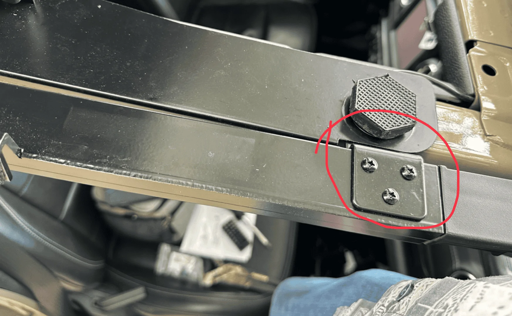

Yes, worked with the engineer… the brackets that hold the over door plastics to the spot cage, were welded wrong. Cut the welds, and made a slot with a bolt through to adjust until it was tight.
what you see there, will not have any bearing on the frame sitting where it should. The bracket circled was welded 1/4 inch off on both sides, it held the tops windshield header too high to seal against the windshield.
What year is yours? I have the same issue with my ‘25. I have been talking with their tech people for a week or two…
they seem to be clueless regarding this.
Who did you talk with? If it was rugged ridge’s email, could you find and pass their name to me? I can ask for them… I have a grinder and a welder. I just hate to hack into something under warranty lol
