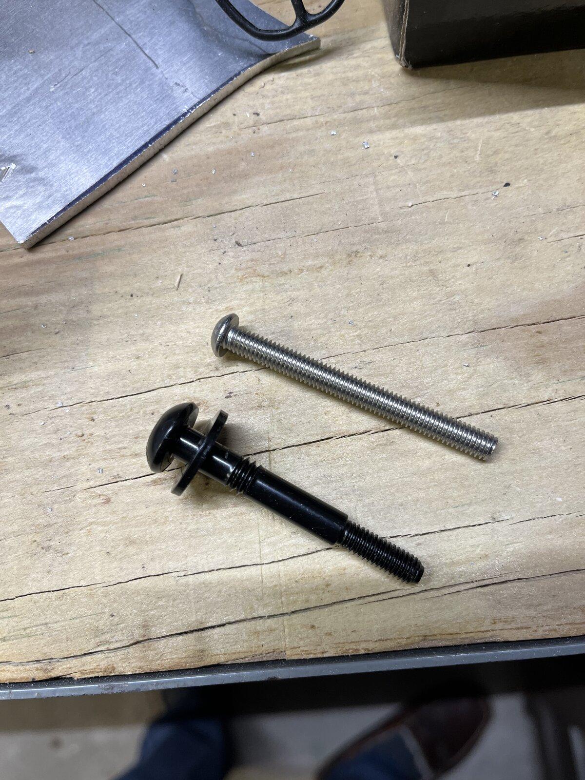

The black bolt is stock next to a bolt that came with a EAG cowl light bracket. The stock bolt can only go down so far so it just holds the cowl panel in place, the EAG bolt squeezes the cowl panel to stay in place, I did not want that as I thought it could crack the panel.
That bolt almost looks powder coated........
Anyway, I don't see why a person can't put a sleeve or spacer on another bolt.......
It's basically a shoulder bolt with a captive washer.

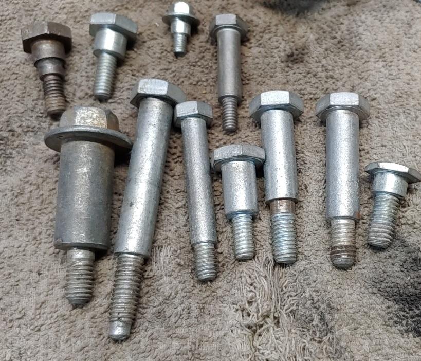

And for those wondering what a shoulder bolt is - these are examples ->
So dont crank the snot out of it and stop when you start to feel tension?
Ah ok. Had not taken that bolt off yet.
The corner panel has plastic tabs that go under the center panels bolt holes, it is not designed to be held together with pressure.

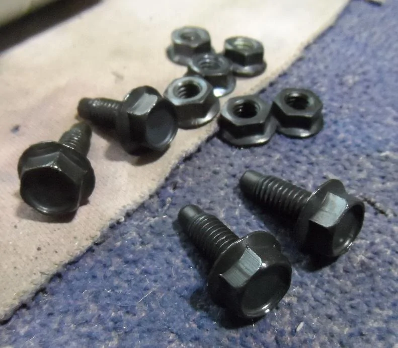

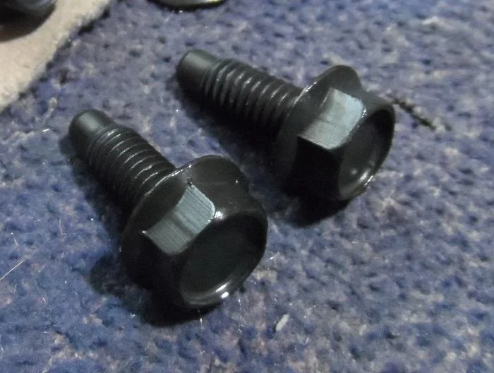

Nope - the bolts would have been plated before Jeep even bought them. The bolts come from outside sources made to Jeep specs.
My bet is it's black zinc plating. They don't install them and then color them, they are black when shipped to Jeep.
If that happened to my own, I'd pull them, clean and prep them and plate them again........

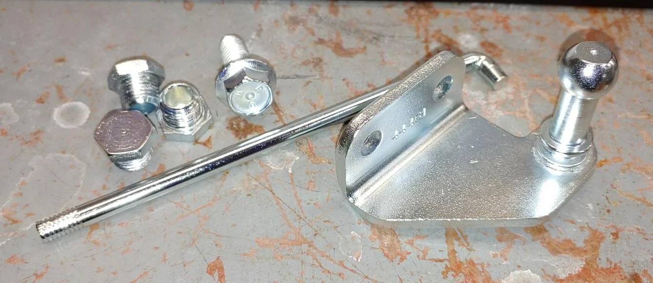

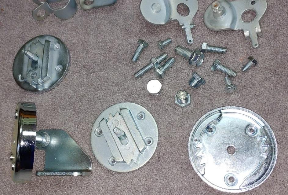

Here are examples of the black zinc plating I do in my shop - for restoration work -
Does the black zinc work like the zinc in regular galvanized screws. As a rust inhibitor??
40,465
53,921
Yes. The zinc is active compared to steel and protects the steel by sacrificing itself. The nice thing about zinc is that even if scratched, it still protects the steel below in most cases.
The black color is due to the passivate used. Because zinc is so active it would otherwise start to oxidize in hours after plating. Immediate rinsing and submersion in a passivate for 30-60 seconds (depending on the type, etc.) it tones the zinc down a bit.
I do clear/blue (like most hardware store bolts) yellow/gold and black zinc.
The zinc plating is the same, it's the passivate that varies and is different colors.

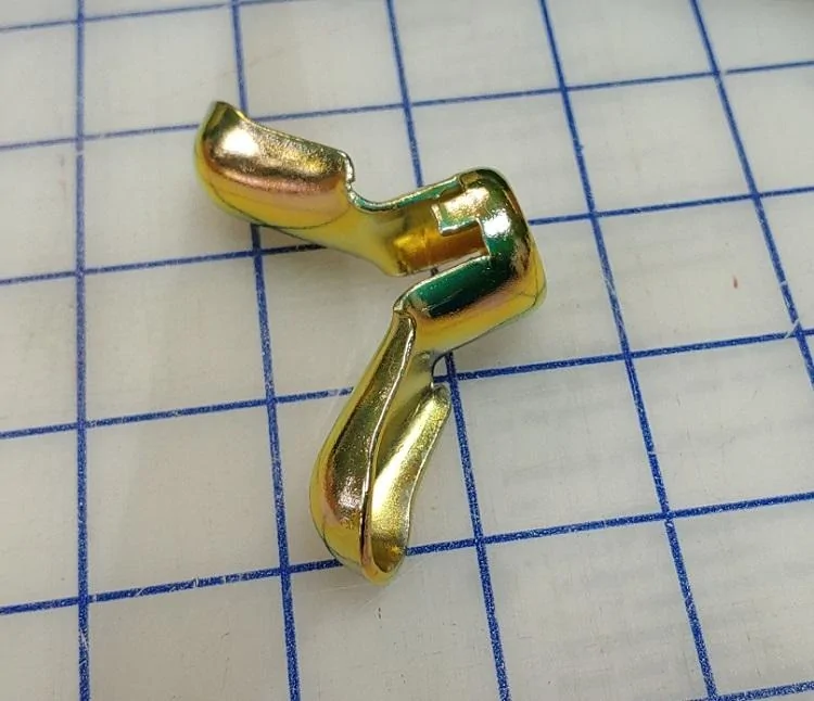

Yellow zinc -

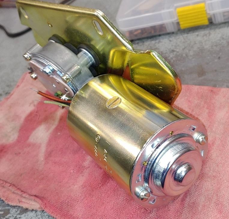

Yellow and clear zinc on a wiper motor I'm restoring ->
