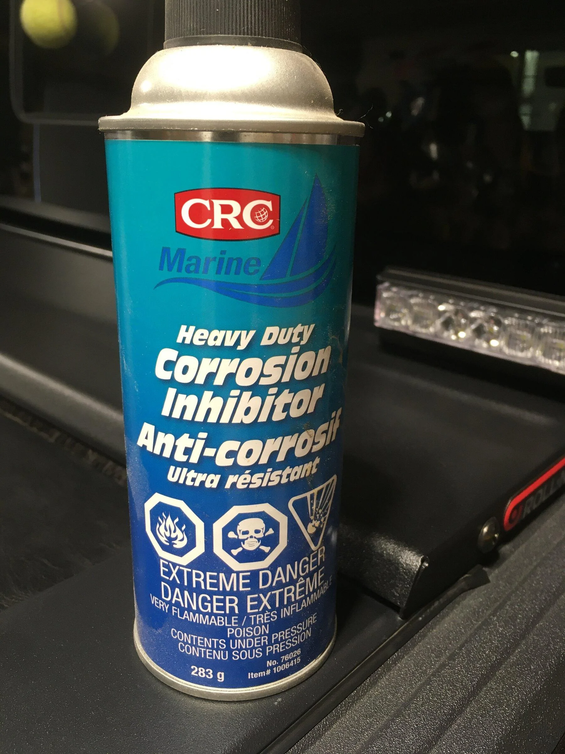

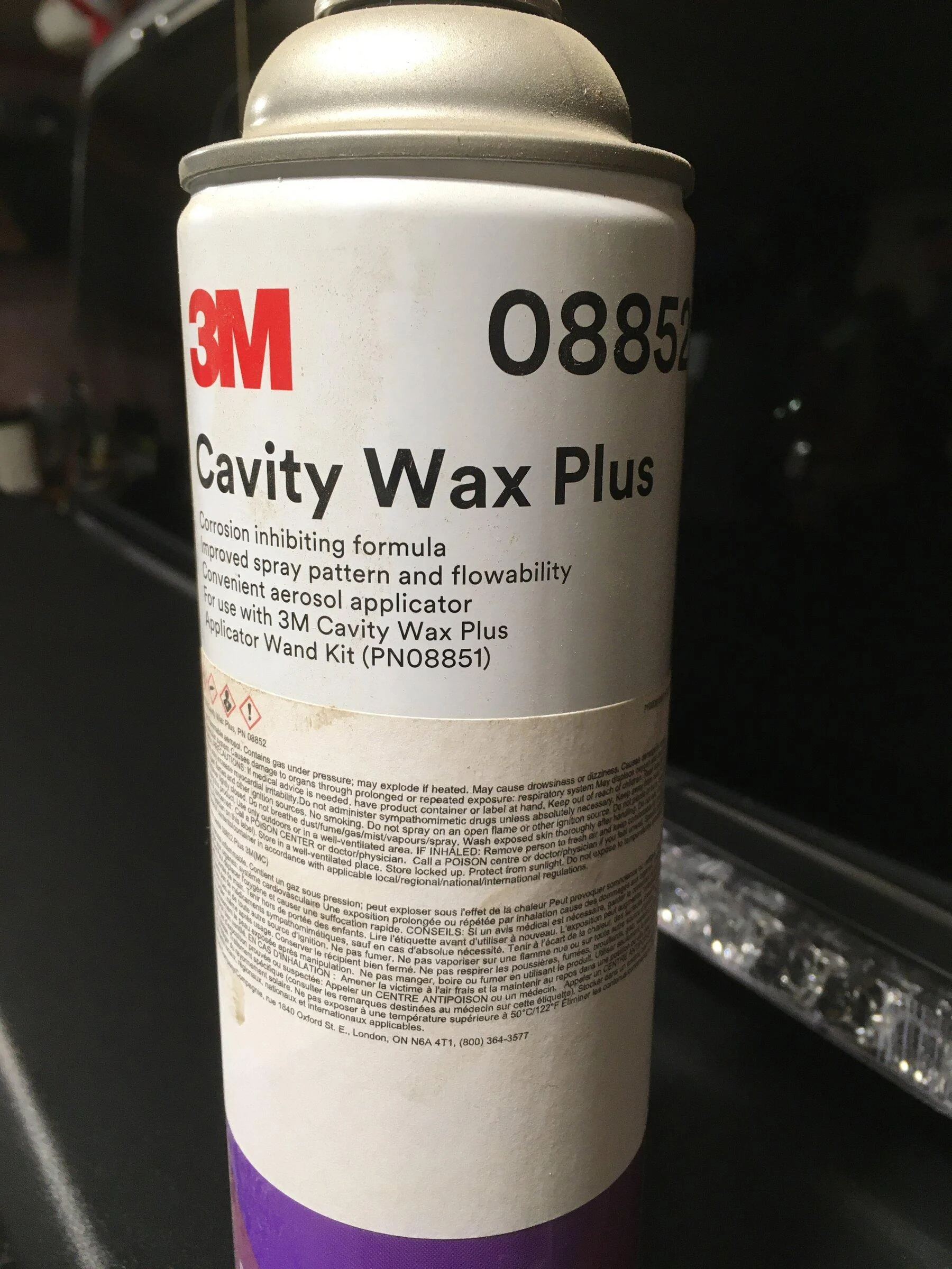

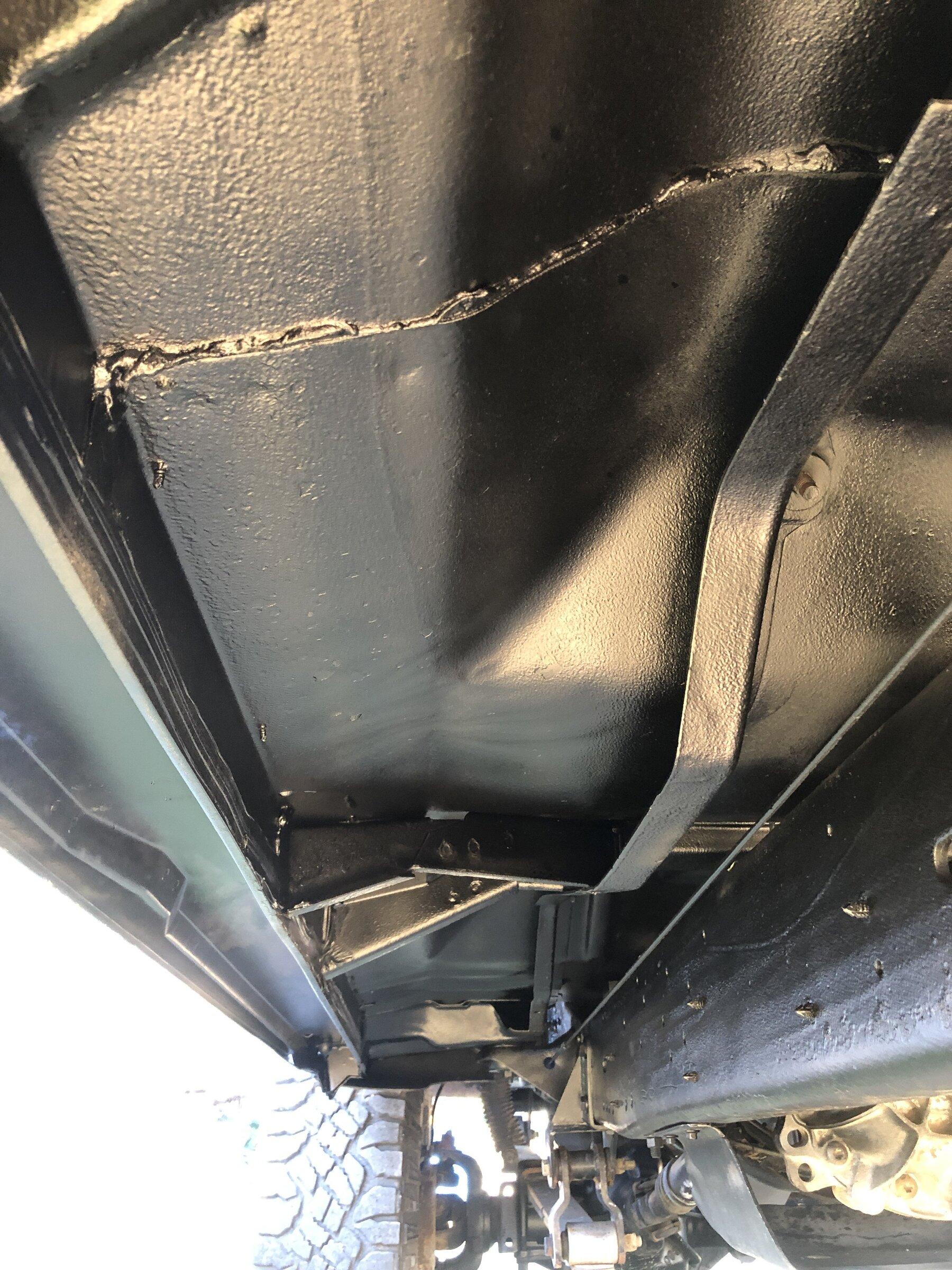

My post will give you 2 for the price of one.
My neighbour is from Afghanistan, he under coats his truck with diesel.
I picked up my JTR last February when it was snowing and lots of salt on the roads so I had the dealership undercoat it.
I then ordered “3M Cavity Wax Plus” with the spray wands and did inside the door panels and interior frame and any other panel hole I could get the wand into got a healthy dose of wax.
I then picked up CRC Marine Corrosion Inhibitor spray and hit everything else the dealership couldn’t undercoat. The underneath shows no signs of rust.
