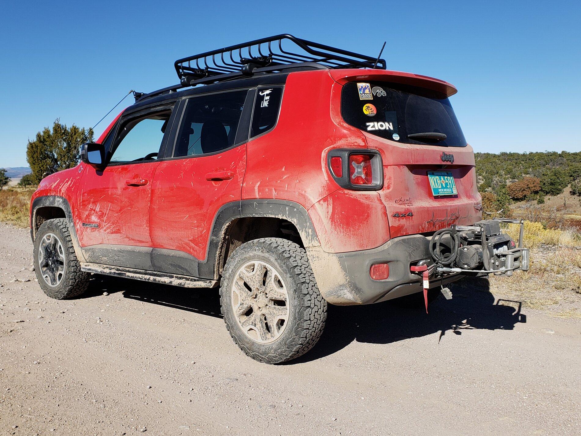

I plan on doing it at sone point in time. Gonna put it on a removable winch cradle and run two. Had one on my Renegade. Got me out of a jam that a front mounted winch couldn't have.

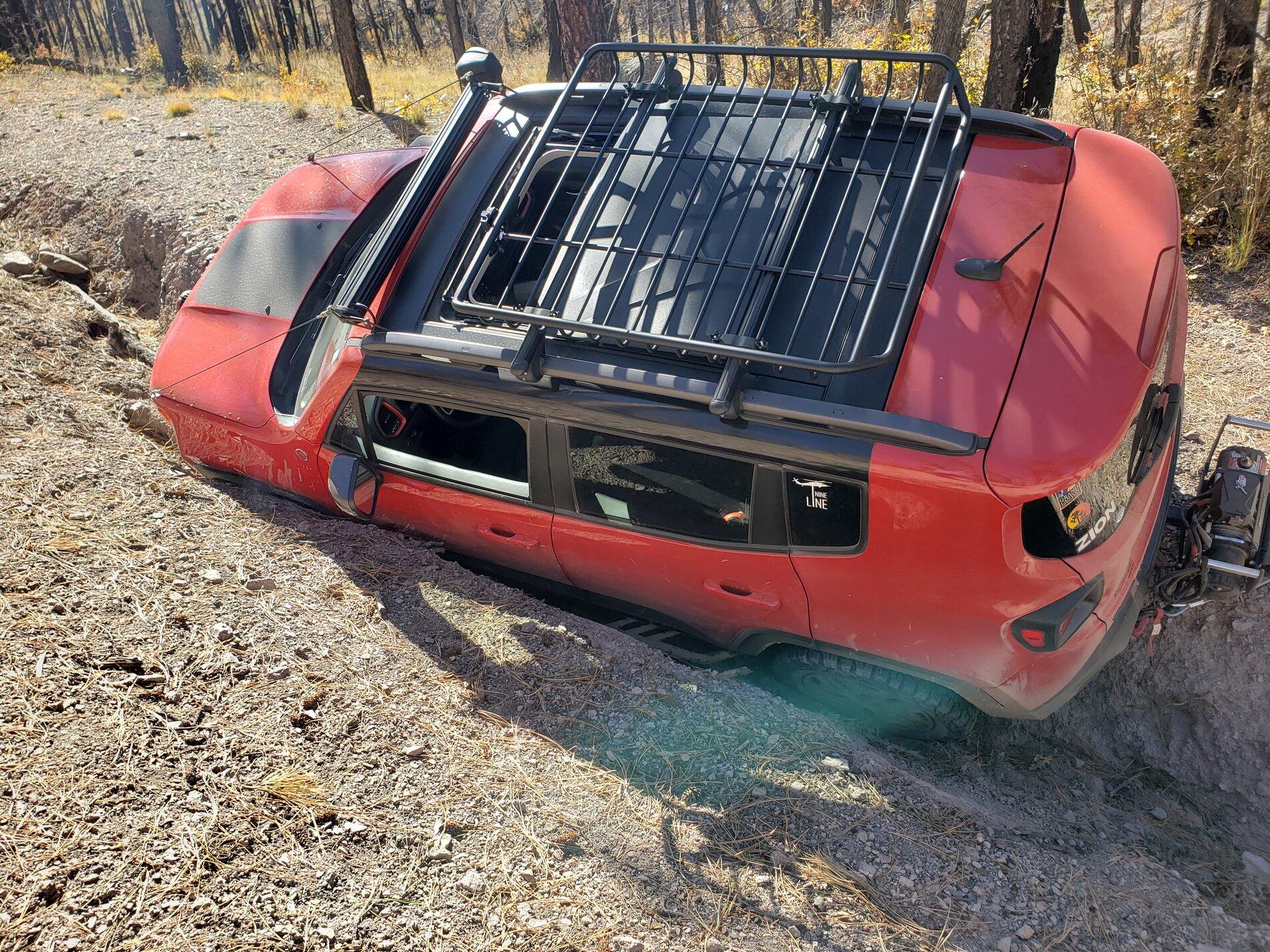

Really could've used one here.

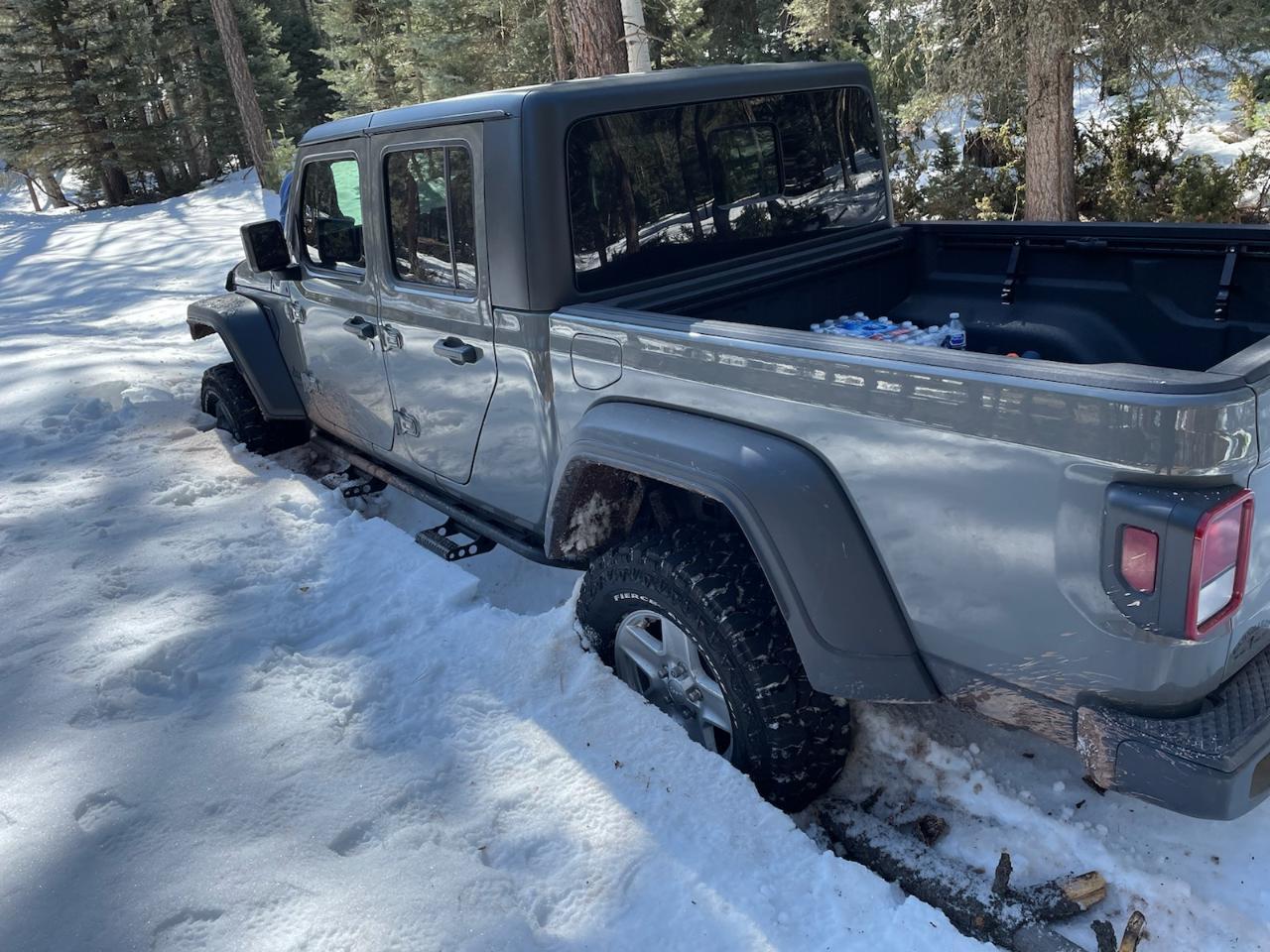

My 9500 Smittybilt XRC has served me well. My father-in-law had a 10,000 lb winch on his tow truck that literally was all he needed for everything he towed. And I'm talking about a F-350 stuck in park being yanked up onto the bed.
Every time I've been stuck it would've been more feasible to winch back out...like below.
