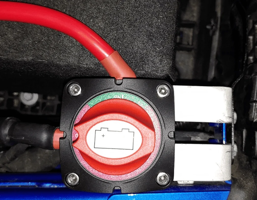

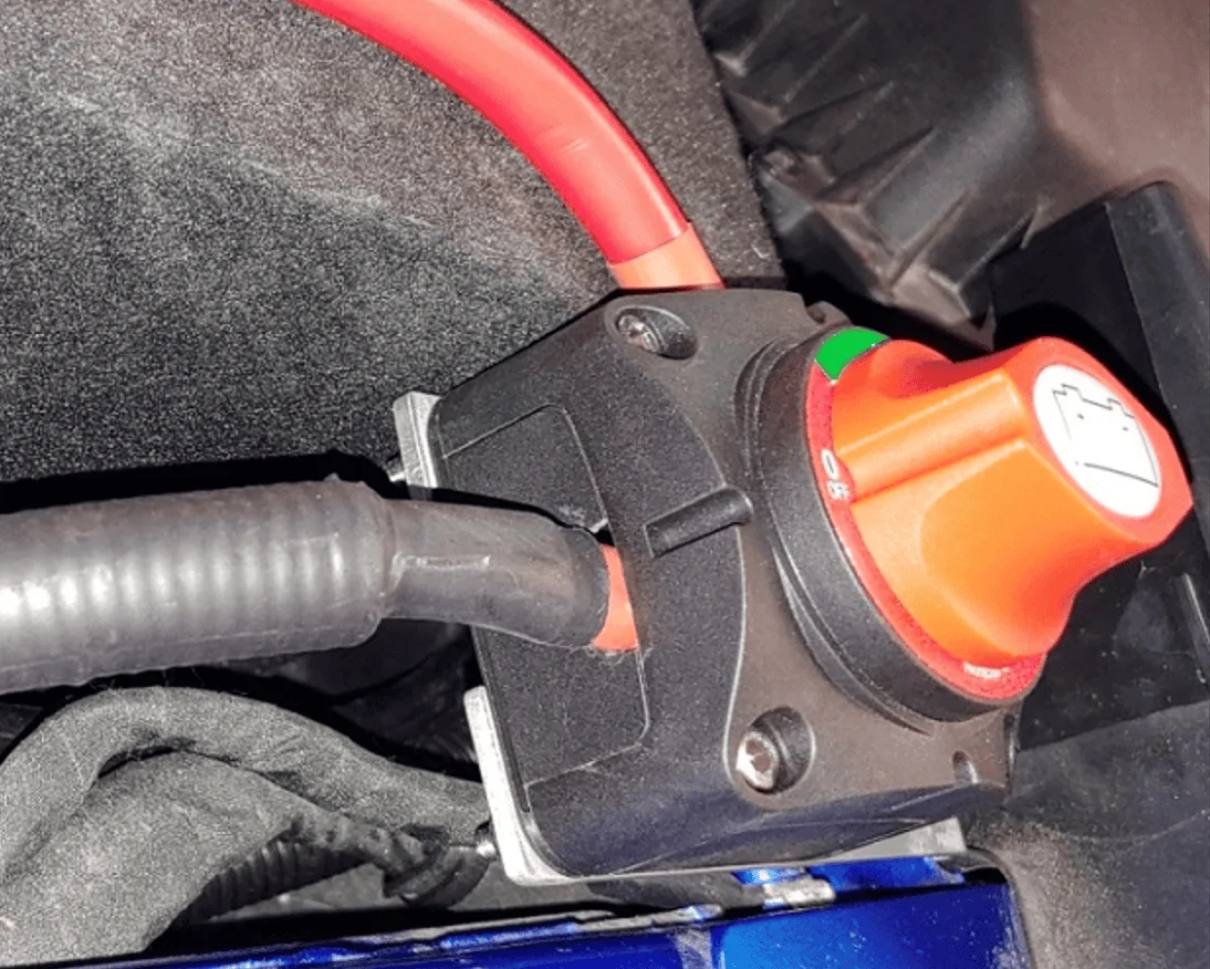

Can you give us more details about that switch in your first picture? How is it mounted? Any troubles with opening up the hood when you need to use it?
The switch came with the Badlands Apex winch as part of the package.
I had some aluminum bar stock laying around that I used to make the brackets.
It's just two pieces of stock bent, drilled, etc.
No problem getting to it while I had it that way. I have the 'redline tuning' hood struts so once I get the hood latches released, the hood goes up. No support rod needed.
The 4 small bolts that hold the switch cover on go through the switch and the aluminum stock, with lock nuts on the bottom.
I pulled the two bolts shown on the right and inserted the aluminum between the two parts, put the bolts back.

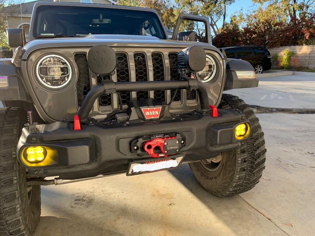

Can someone explain to me the differences between the 100s of winches available to choose from? I’m looking at WARN, specifically. I don’t need anything hardcore. I want something that can get me out of snow once in a while and will look good with the Mopar Steel Bumper? ~$1000 (is that realistic?) prices are all over the place.
I have the Warn Zeon Platinum 10s, and maybe used it 20 times; 3 or 4 times for my rig, the other times to help my trail buddies. I keep the wireless controller plugged in all the time, and I use the Warn Power interrupt kit hooked up to one of my aux switches to turn it on.
Here is what I have learned:
1. If you are climbing hills like me (West Coast Wheeling) instant driver's seat activation of the winch is a huge advantage, ie. a wireless controller. The first time - I got stuck on a hill climb, and was wedged against the side of the hill where I could not exit the drivers door easily. My girlfriend was scared. I had just installed a front camera that I forgot about...., heat of the moment. My buddies that I was 4wheeling with set me up, and made the escape easy. Wireless controller was much appreciated, as I was not convinced that I could exit the Gladiator without it rolling backwards down that steep incline.
Here is a video of the incident
2. On the Rubicon Trail, one of our trail buddies only had 35 inch tires with no lift. I was behind him, so, I had to pull him backwards a lot. Having him do all the work to hook himself up, and me not having to get out of the truck all the time was much appreciated. Again, the wireless controller was the key to avoiding exhaustion.
3. I quickly used up my Gladiator aux switches, and the extra two power switches on the Warn Platinum were much appreciated. I used them to turn on my 2 sets of rock lights and light whip.
Here is a pic of the Warn Platinum on the Jeep steel bumper.

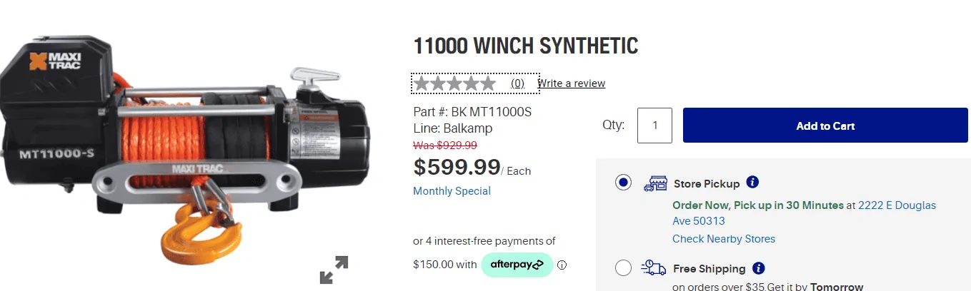

Does anyone know anything about the Napa MaxiTrac winches? The retail price is high, but the current sale price makes them competitive. I don't see any other limited lifetime warranties in this price range and they have service locations (stores) everywhere.
https://www.napaonline.com/en/p/BK_MT11000S?impressionRank=27
https://www.napaonline.com/en/p/BK_MT11000?impressionRank=28
Wow, if I didn't have the Apex I have already, I'd be doing a very serious look at these! Support/stores all over the place, nice price!
I ordered this one, didn't think the $200 price difference for the synthetic cable was cost effective.
