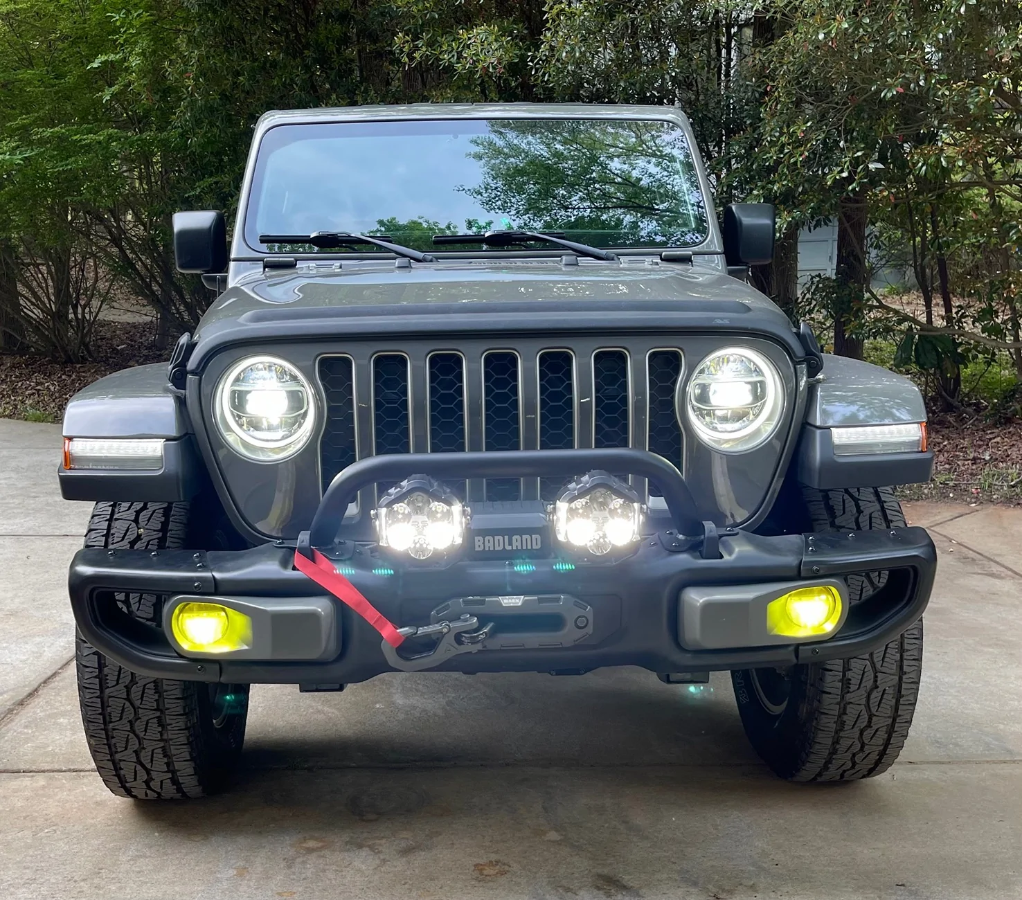

Those lights are enormous . But I like em
The body is roughly the same size has the headlight. They aren't that big. Its just angle of the dangle :CWL:. Baja Designs LP6. Their LP9's make the LP6 look tiny. The low and high beam feature of the LP6 is nice though.

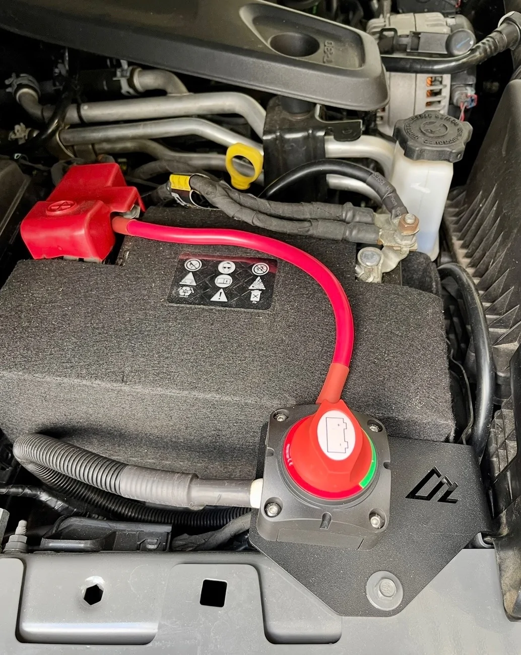

That’s all that you can see on my wiring. I spent a lot to time hiding everything and it’s all run into my aux switches minus my winch. There are accessories you can’t see here. I’m using 3/4 aux switches
Who's mounting plate is that for you winch master cut off switch ?
American adventure lab. I don’t recommend ordering from them unless you’re cool with it showing up 3 mo later with sparse communication along the way. It’s a shame. It’s a good product with a reasonable price.

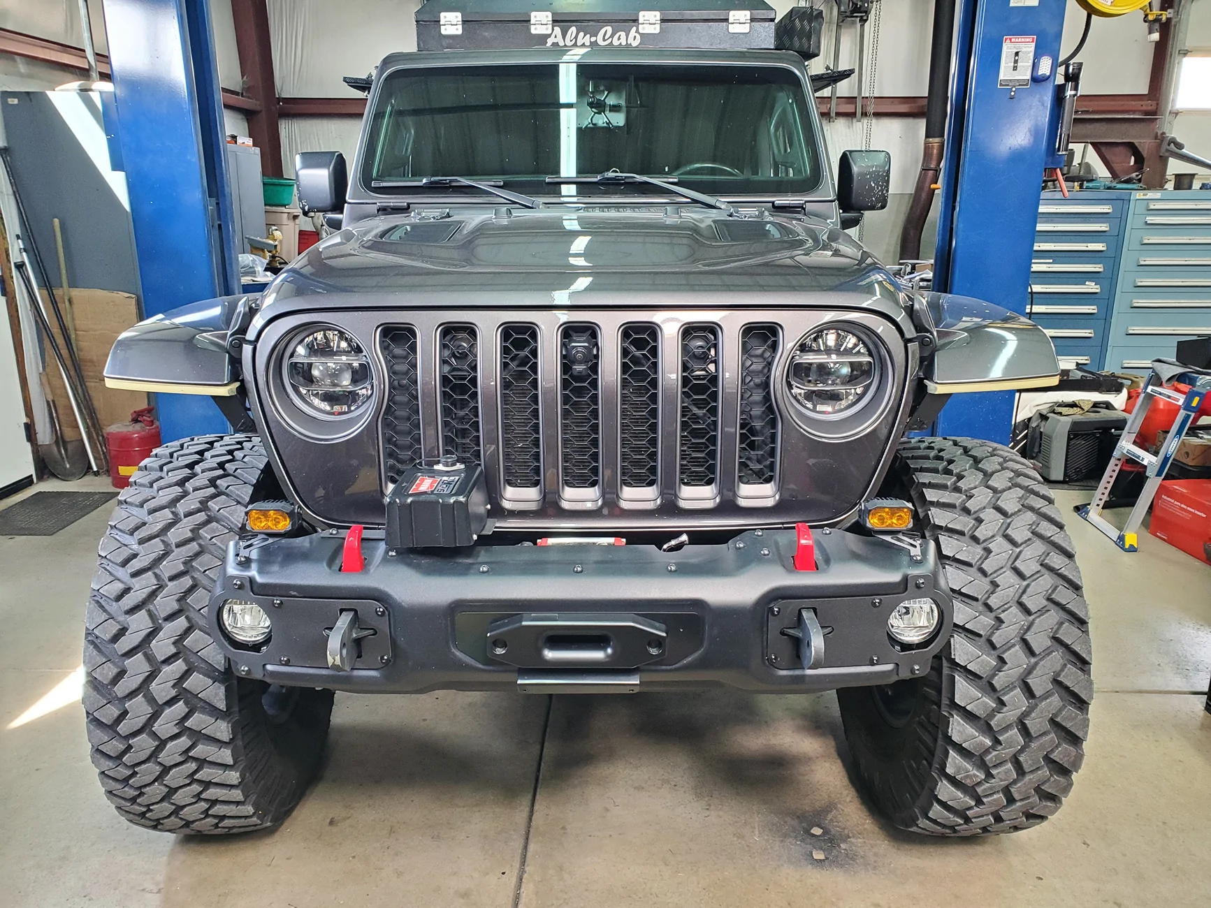

I went with a Warn 9.0Rc but after gaining a few thousand pounds I have a Warn Zeon 12s coming. The 9.0 will go on my CJ. Picture before I installed the rope.
